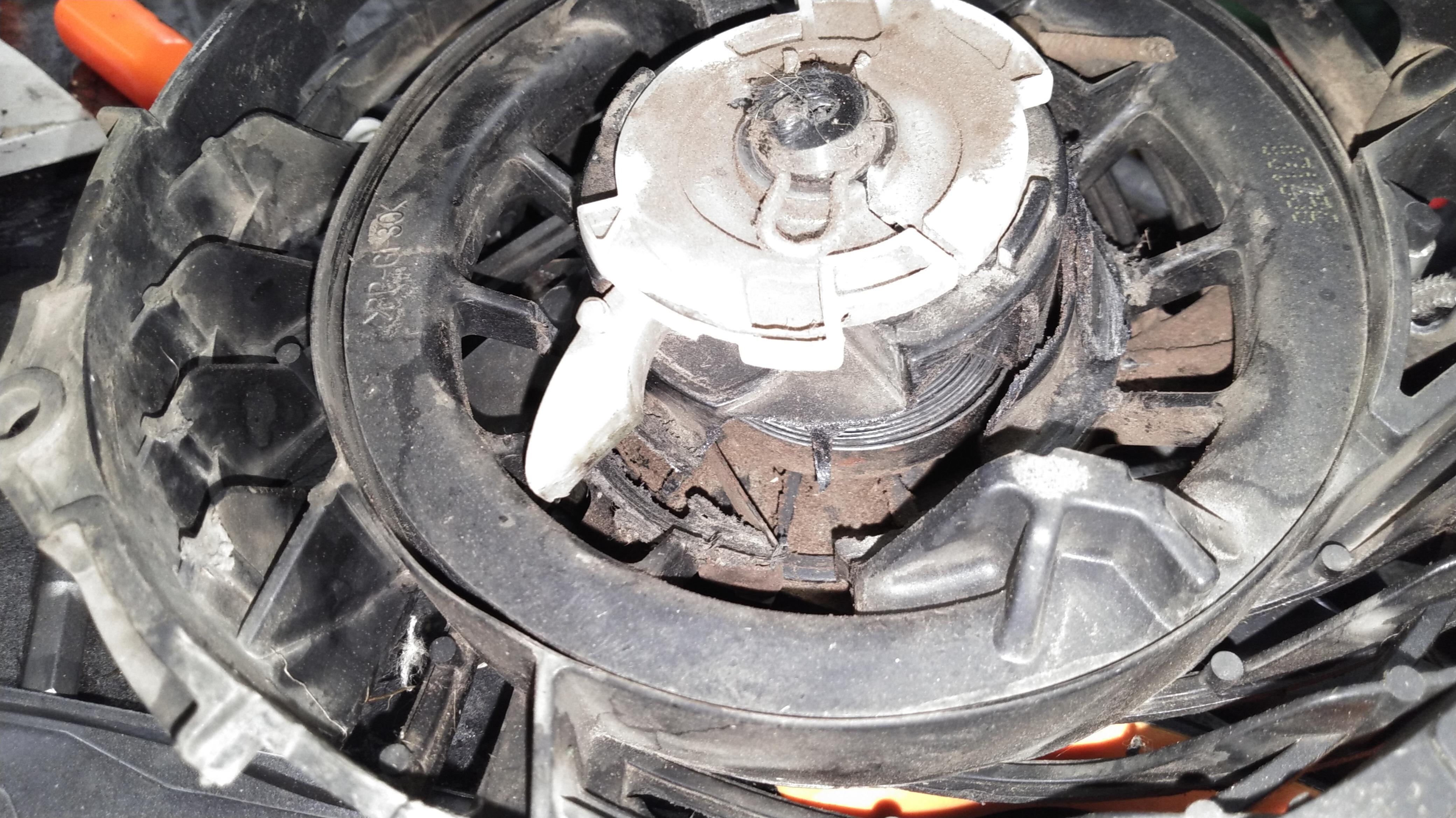

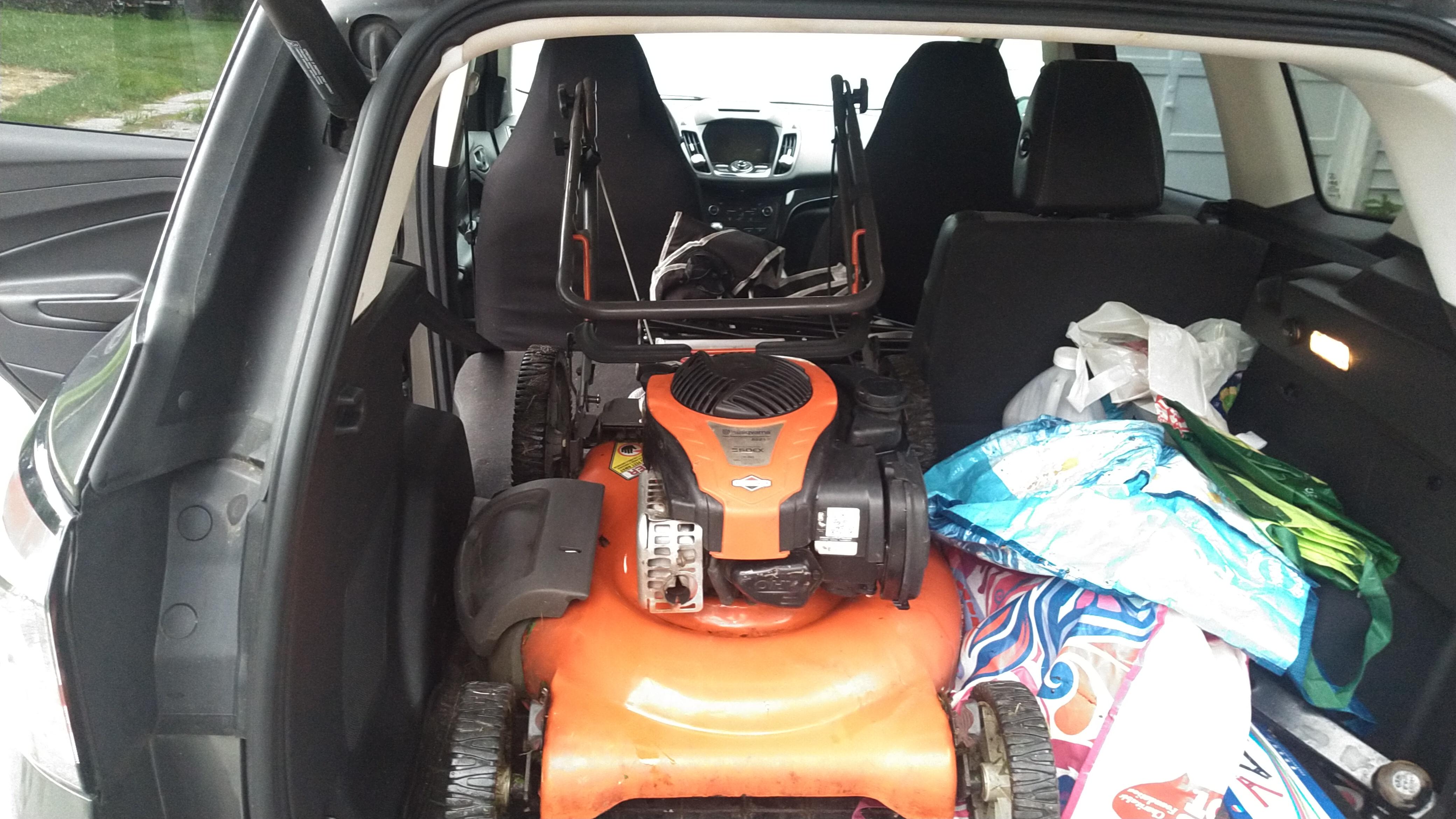

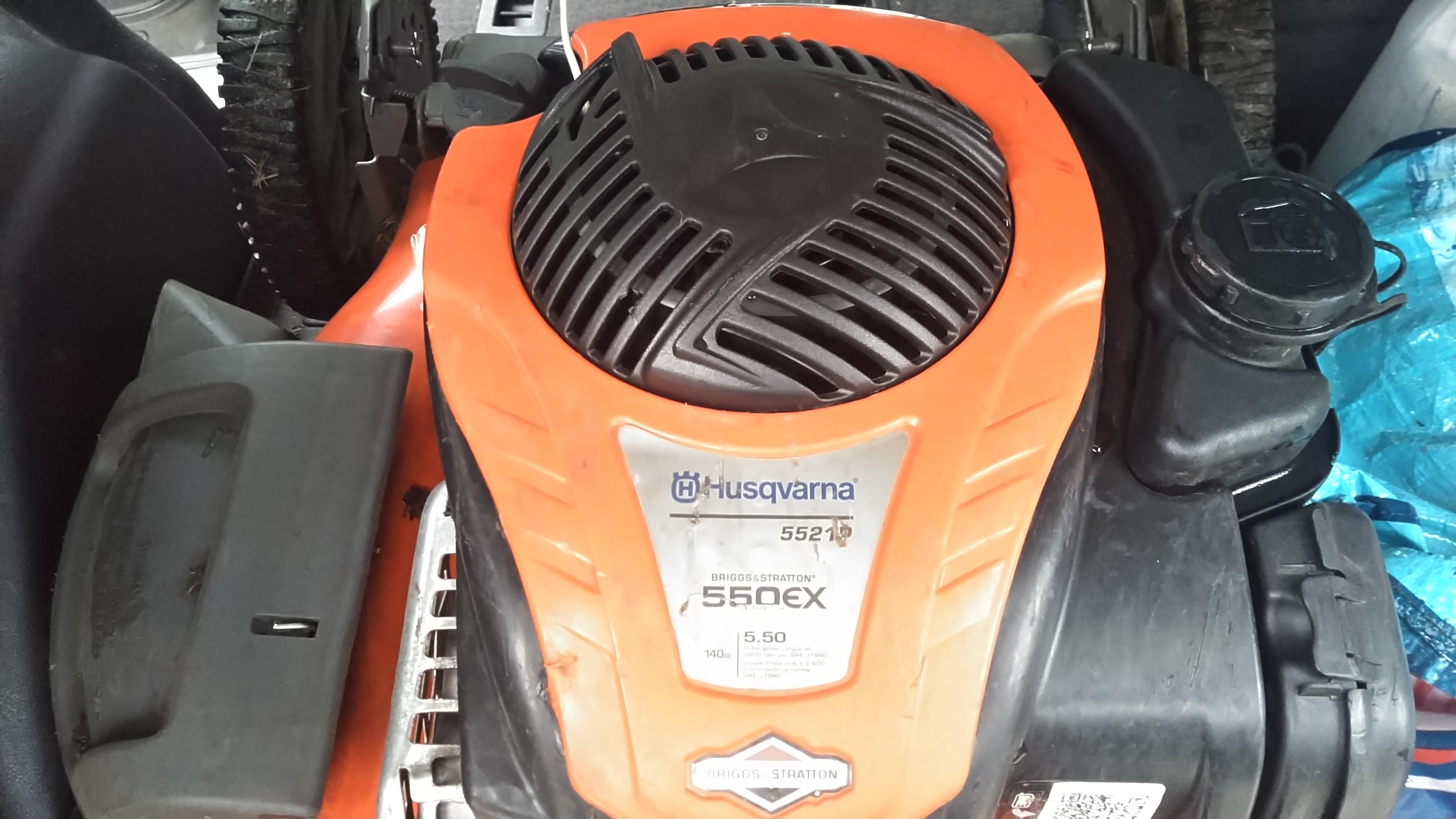

Husqvarna push mower with Briggs 550EX.
Replaced the busted recoil with a new OEM one and got the running issue sorted out. Running issue was a dirty carburetor, half an hour in the ultrasonic cleaner got it perfectly clean. Also changed the oil, blew out the air filter, checked the plug, installed a fuel filter, scraped the underside of the deck, touched up the blade and washed it. Getting delivered tomorrow after work.
