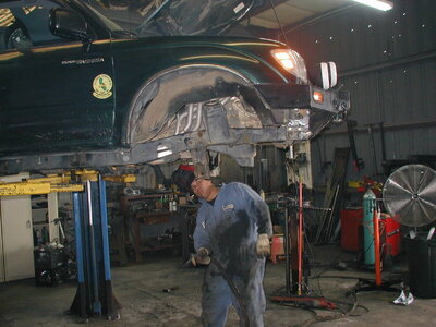

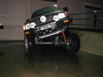

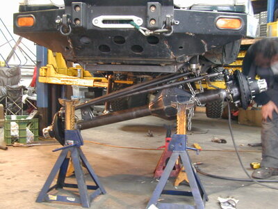

Thats quite an upgrade, i put a solid 44 in my 94 F150.

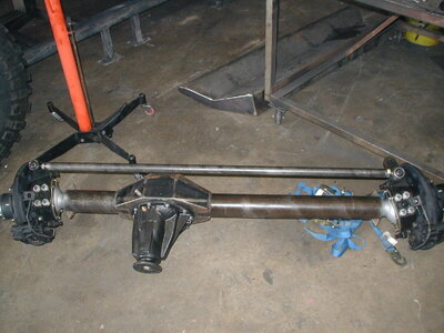

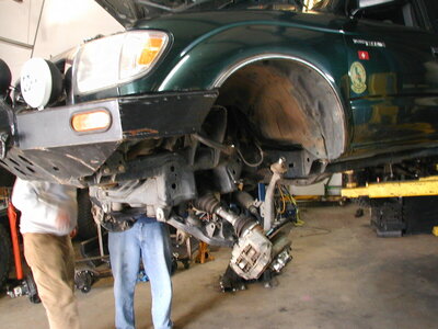

2007 was the 'diff-drop' date :p Cut everything off with a plasma torch and start over. All custom stuff. Axle is made by Diamond in CO, 80-series Landcruiser hi-pinion front diff, ARB, Longfield 30s. We did start with a 3-link "kit" but wound up modifying all the brackets or just fabbing up completely different ones. Took, I think, 4 tac weld trys to get everything dialed in before burning.

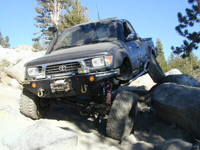

3' of travel on each corner. Designed for the Rubicon and other norcal trails like Dusy and Red Mt. Maiden voyage on Rubicon didn't even require either locker :p
no place around here in ID to take it so am looking at selling.

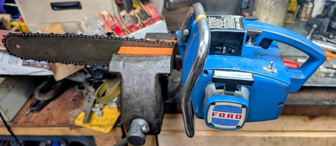

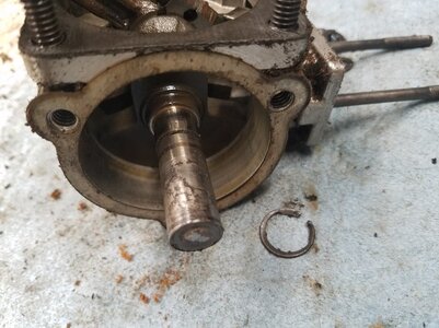

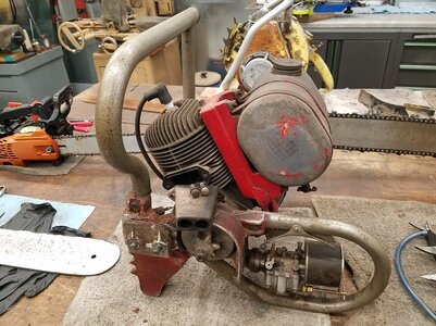

Do you have an IPL Steve? There is a snap ring under the seal that must come out before the crankcase will come apart.
It looks pretty good to me just the way it is.
Mark
That's important information to know. Mark. I do have an IPL but that's not to say that I would refer to it before I would struggle trying to take it apart. 😊
So far everything looks very good on it and it runs on a prime shot. I have a Barker that is a twin to it other than it's yellow. Barker spared no expense to rebadge the saw after they got it from O&R. It has a sticker half the size of a postage stamp stuck in the center top of the saw and that's all the identification that's on it.😋

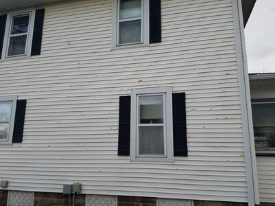

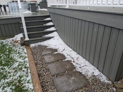

The only photos I have today are the aftermath of the hail storm...
The north and west sides of my house and other buildings all took a pretty substantial hit.
Vinyl siding can be replaced.
