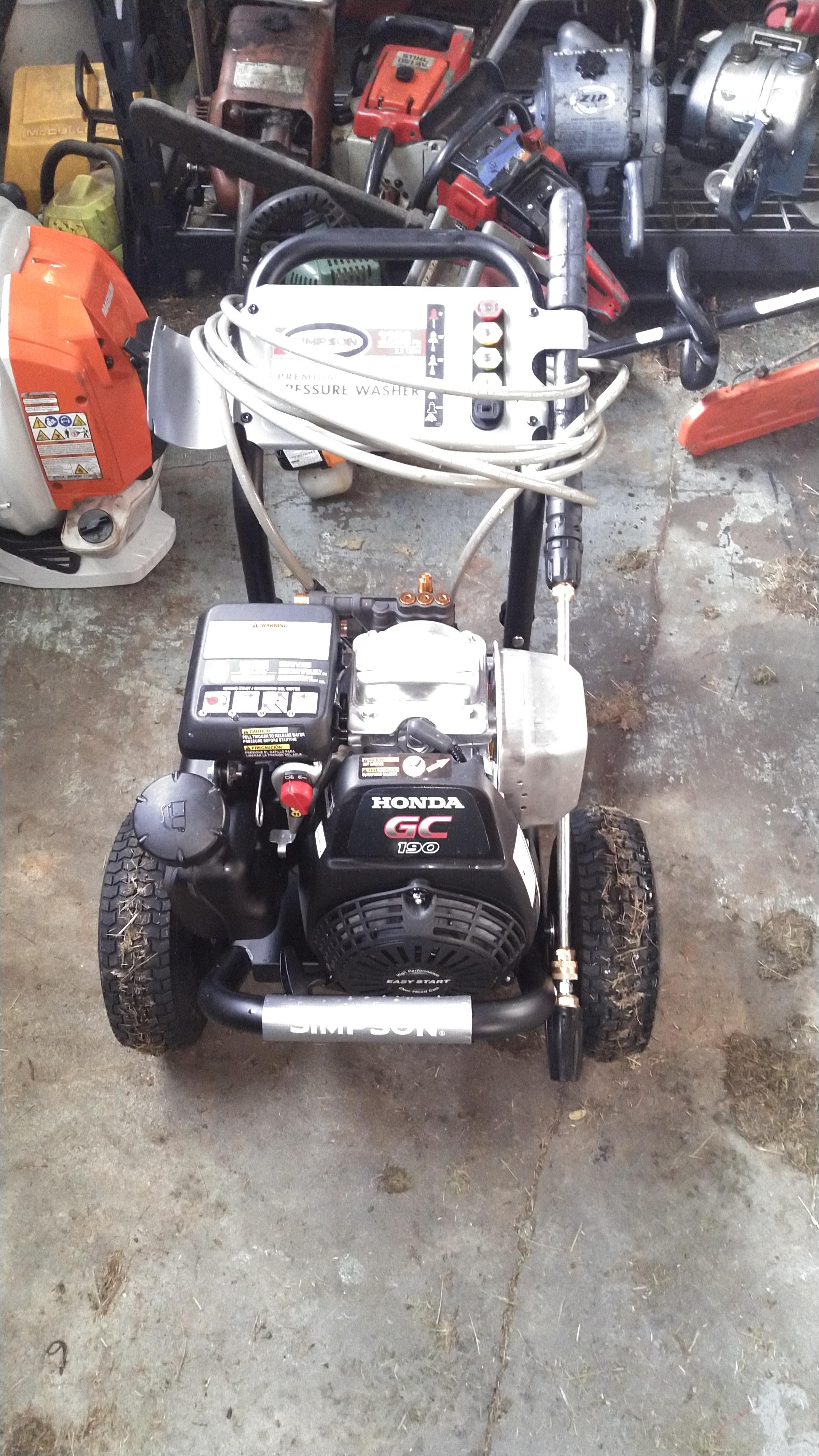

Not much this evening, assembled and played with my new pressure washer and replaced the fuel line on a KM55.

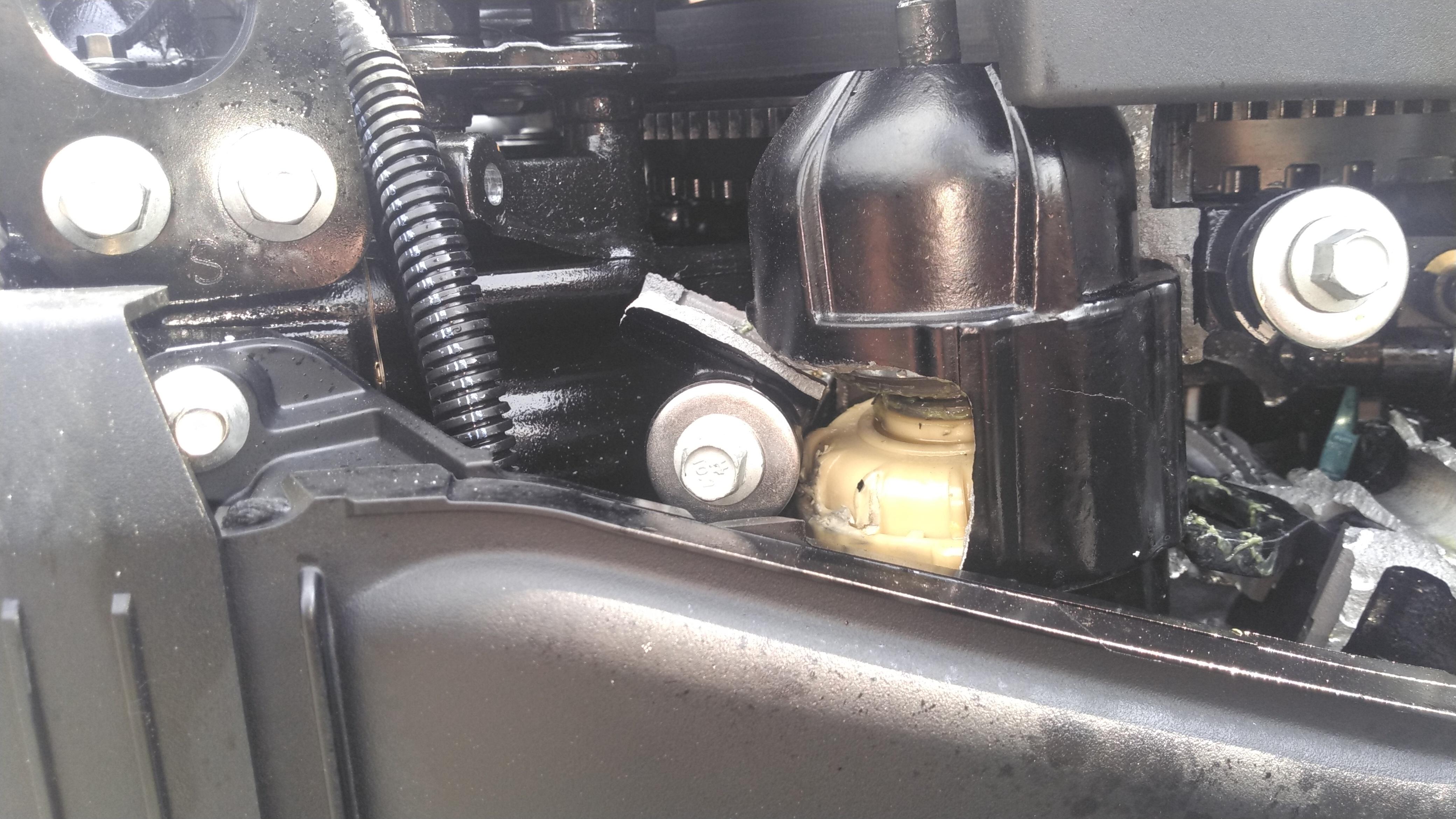

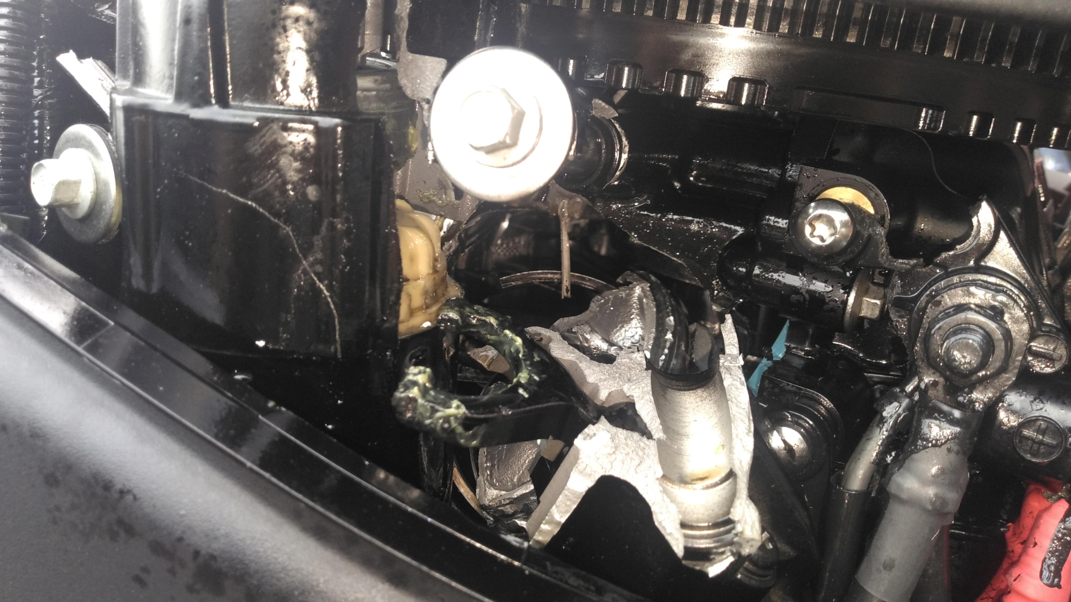

250 Merc ProXS Four Stroke on a bass boat that went boom at 3.3 hours. Guy was taking off, heard a pop and it died. Merc authorized a complete engine replacement which the lead tech and I had done in less than 2 hours.

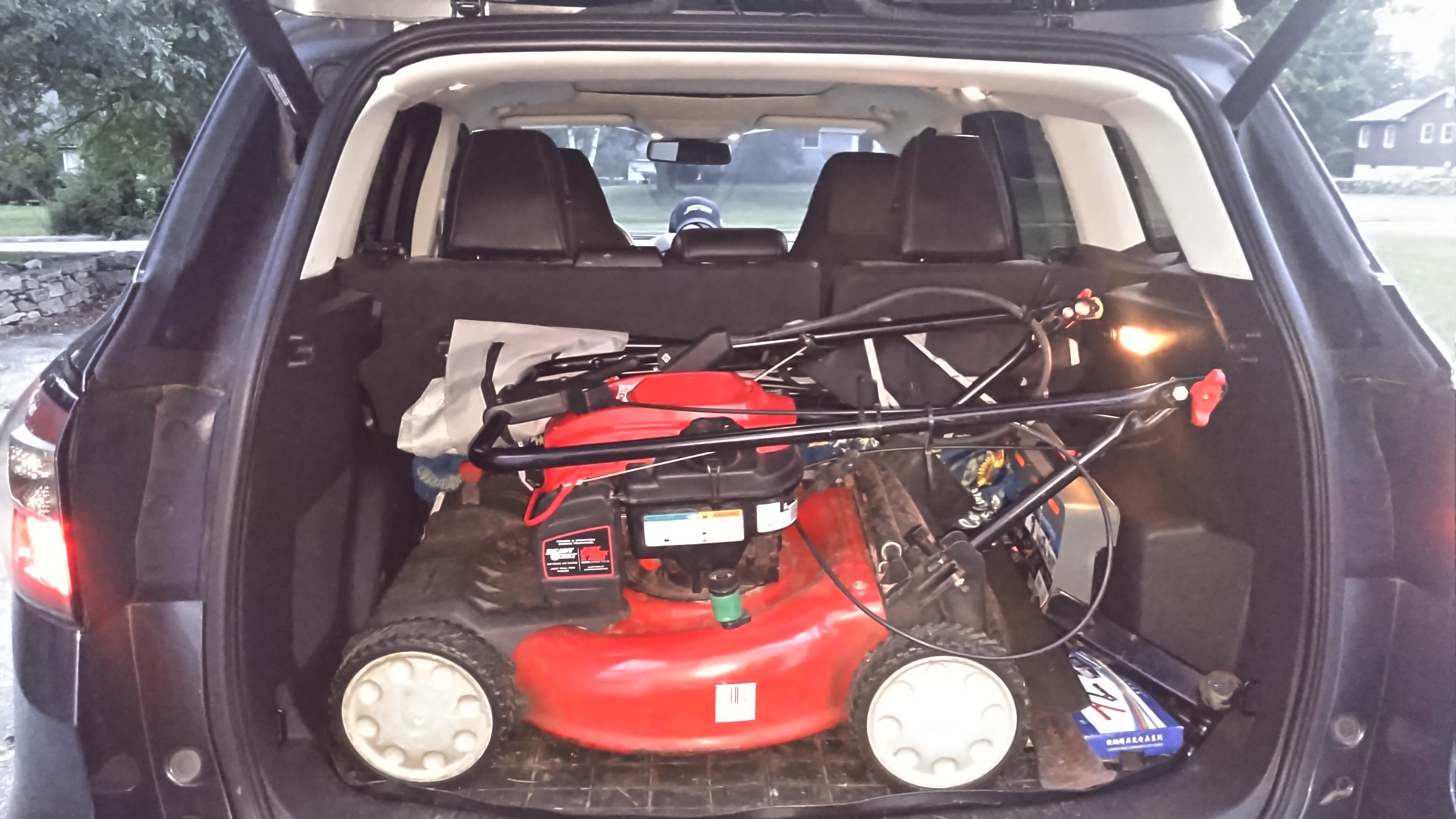

This was earlier, Troy Bilt push mower with a plastic carb Briggs. I got it running for her about a month and a half ago and she called me last weekend saying that it wouldn't run for more than 30 seconds at a time. Found that she picked up a slug of water in her fuel. Drained and dried tank and carb. Fresh fuel and running good again.
