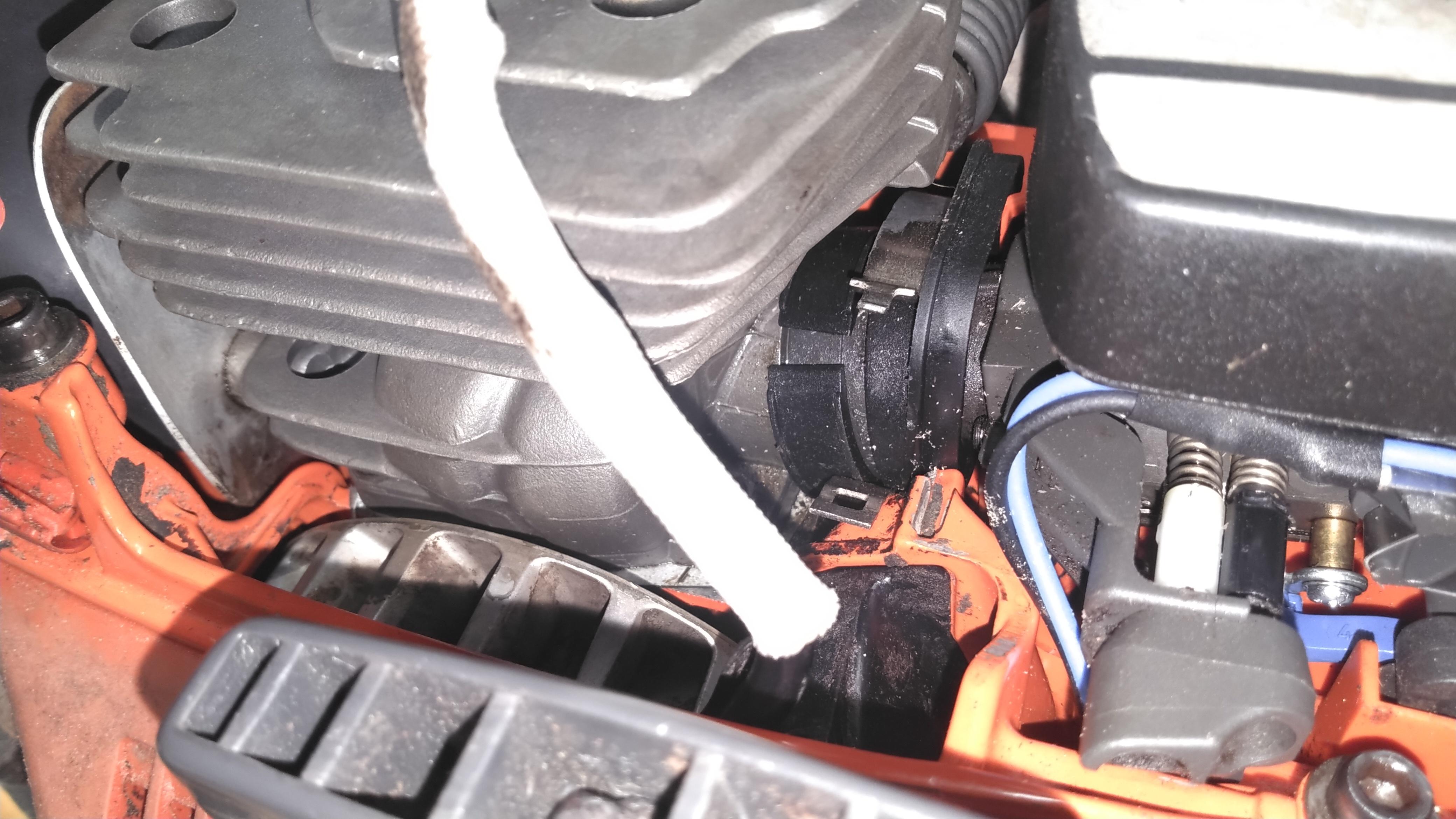

357XP for a new stop switch harness. Good thing I opened it up as I found the intake clamp off and creating a massive air leak. Tried getting the clamp back on but no dice. IIRC it was a PITA to get on as I deformed it a little bit. New clamp on the way.
i haven’t discovered a consistent way to get those to clamp first try. They a pre a PIA. I don’t think the latches are stamped consistently from one to another.
I gave up on those clamps, I'm using the intake clamp from a 372xt or 385xp

what’s that and where do they come from? I’ve seen similar but not with the two square nut locks and the barrel in between
That might be a stihl clamp. 395 if you only snip the plastic lock tabs off. 372xp if you snip more than that off.
