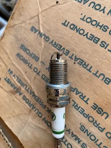

290 Farm Boss carcass had this plug in it.
Threads in the cylinder are stripped and the piston is now ‘dished’. [emoji23]
Make a 390 out of it with Farmertec parts. [emoji1696]

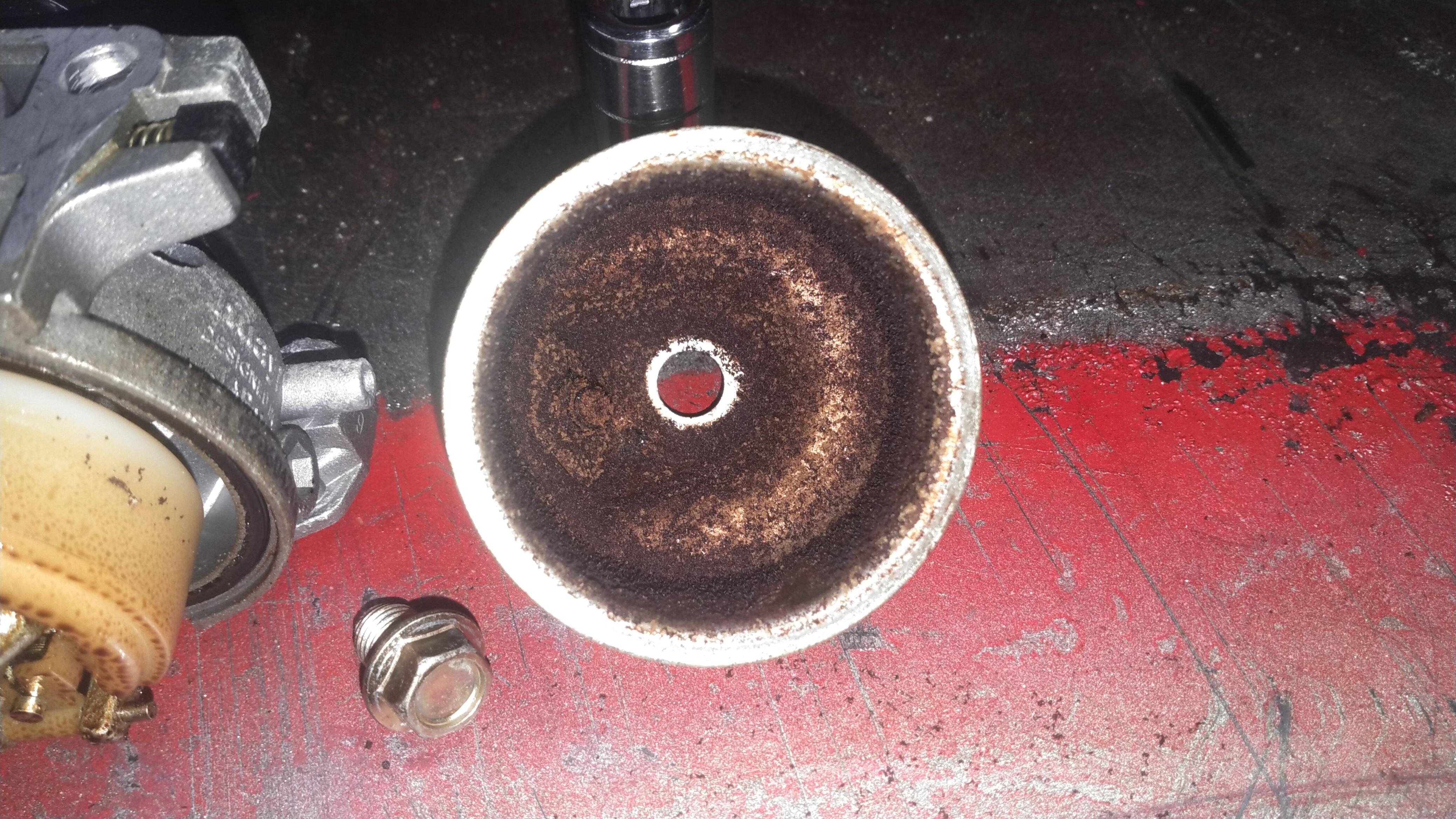

Chinese 3500 watt generator that's getting fuel system help. New carb on, waiting for fuel valve. Tested my 5000 watt generator, ran the shop and the AC in it just fine. The compressor was too much for it and it trips the breaker as soon as it kicks on.

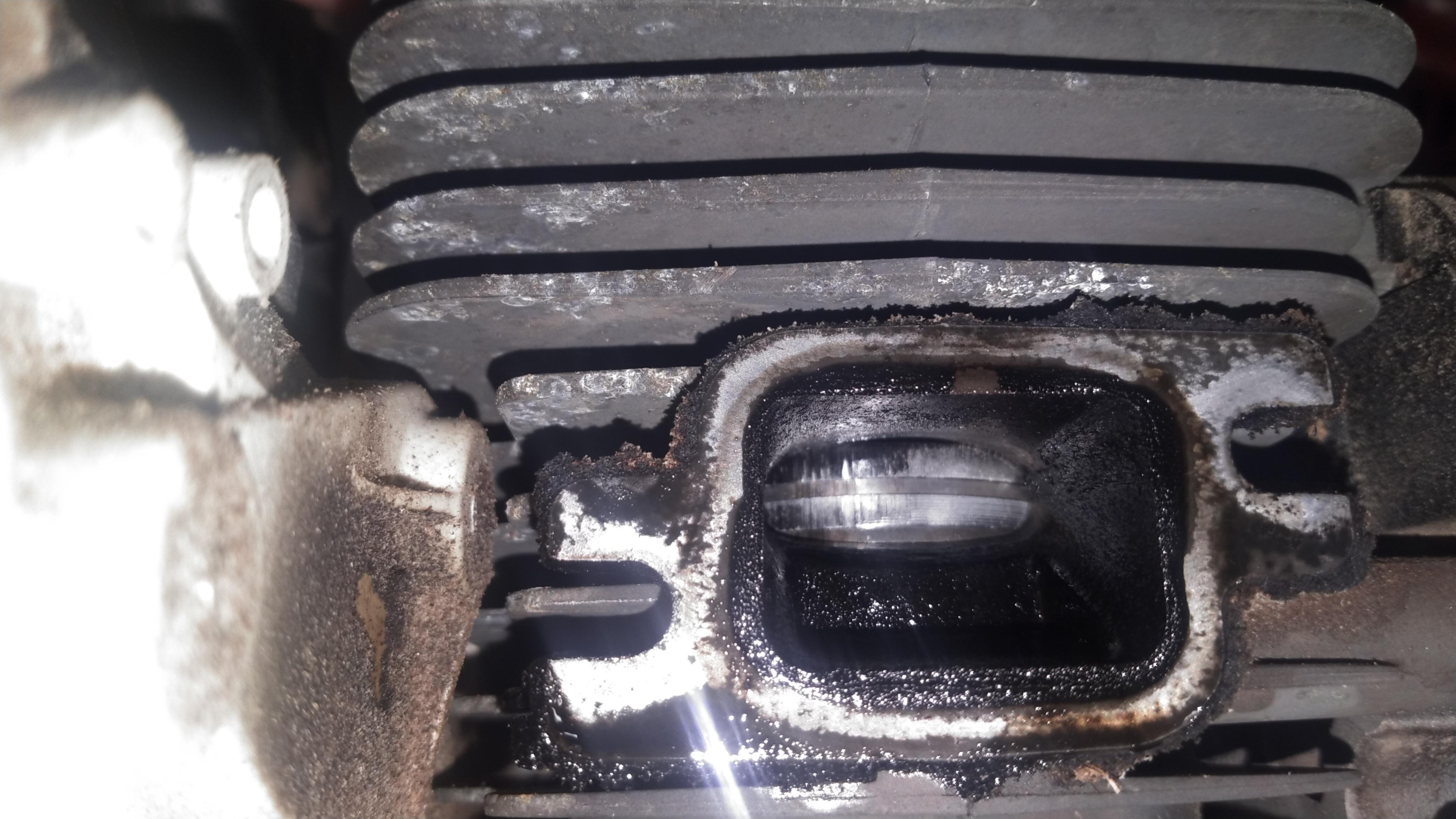

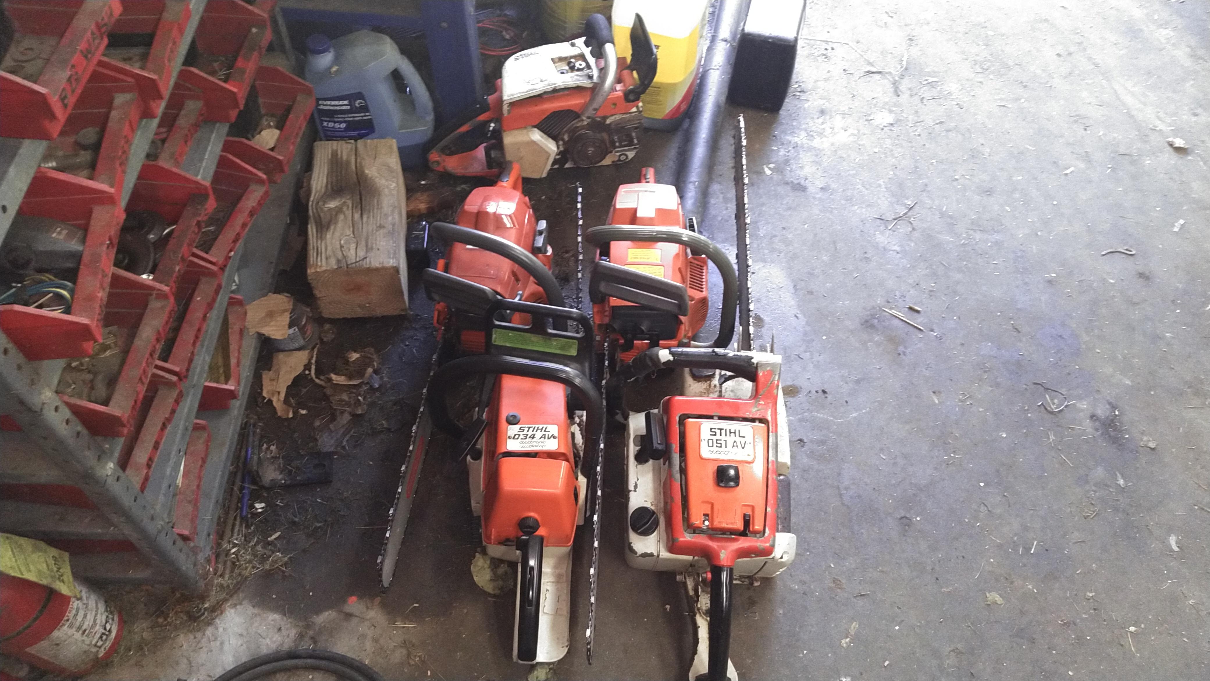

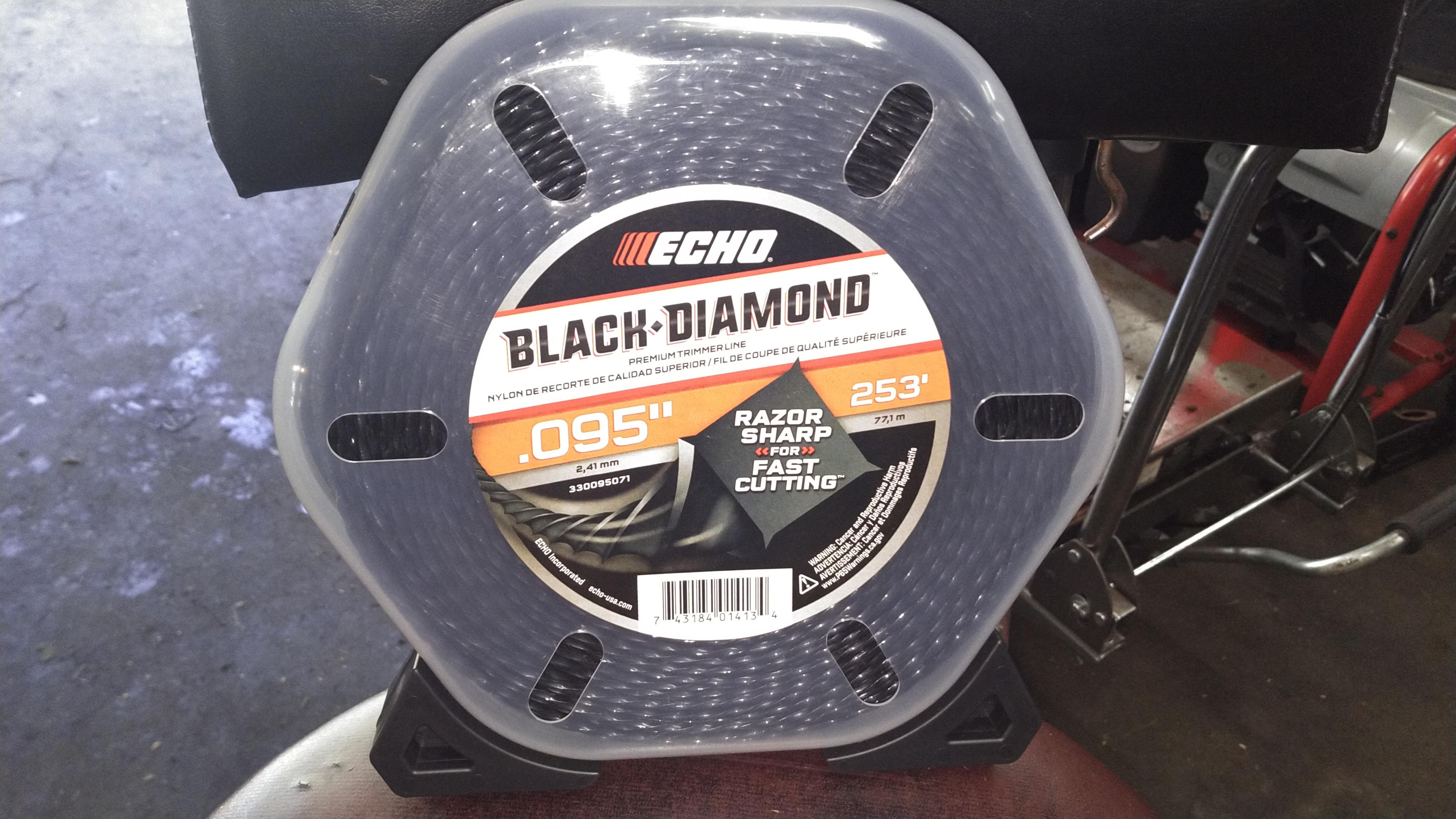

Fired up and made cuts with my 340 to 346 conversion, 034, 61 to 272 conversion and 051. All fired right up and cut nicely. Restrung my T235 with .095 Echo Black Diamond line, which does so much better than the round stuff it came with. Had a MS170 and Homelite dropped off. The MS 170 was supposedly running good last week and he couldn't get it running. Piston doesn't look the best but it's still pulling 155 psi. Plug was very wet so I'm suspecting a carb issue.

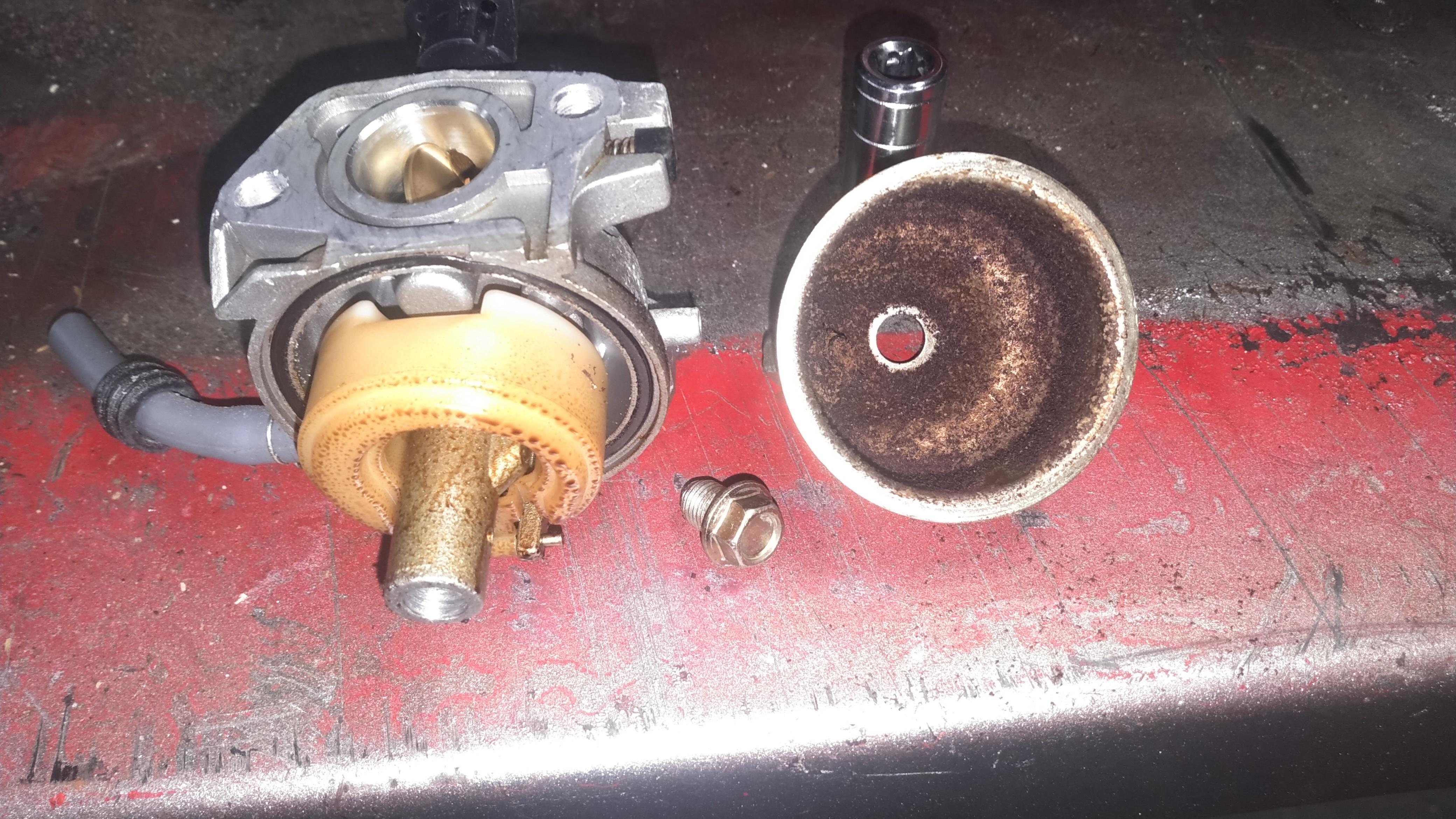

An old Scout friend of mine called me and asked if I would pick up his late fathers old mower, get it running and sell it for him. I pull up expecting a thrashed Home Depot P.O.S. and he pushes out this beauty. A 2004 John Deere LX 280 48" cut with a 18 HP Kawasaki FH580V and 454.6 original hours, garage kept from new. Pulled the carb off and apparently his Dad had ran it dry for the winter before he got sick. Gave the carb a courtesy bath in the USC, new battery and some fresh gas and off to the races. Went ahead and serviced it and installed new blades mostly because his Dad had already bought a JD service kit and a new set of O.E.M. blades. Cleaned it up, replaced the seat, rubber buffers under the seat, throttle knob, front bumper (was broken, big surprise) and hood decals. Drives like a dream, going to make someone a VERY nice mower.

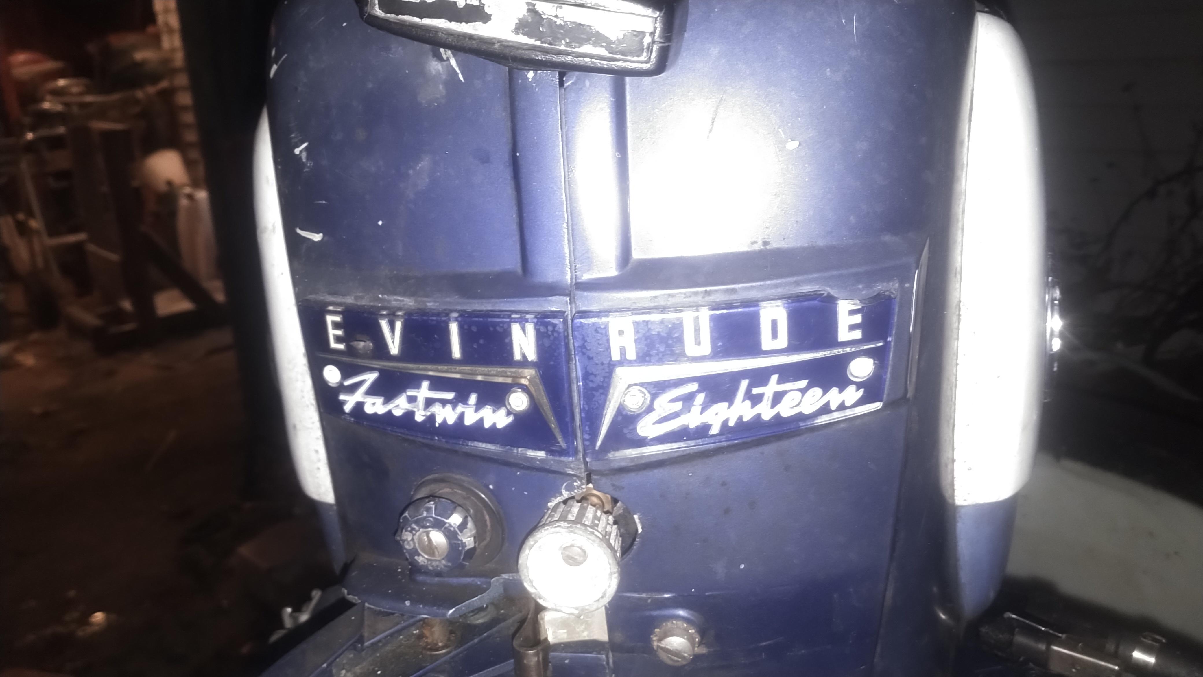

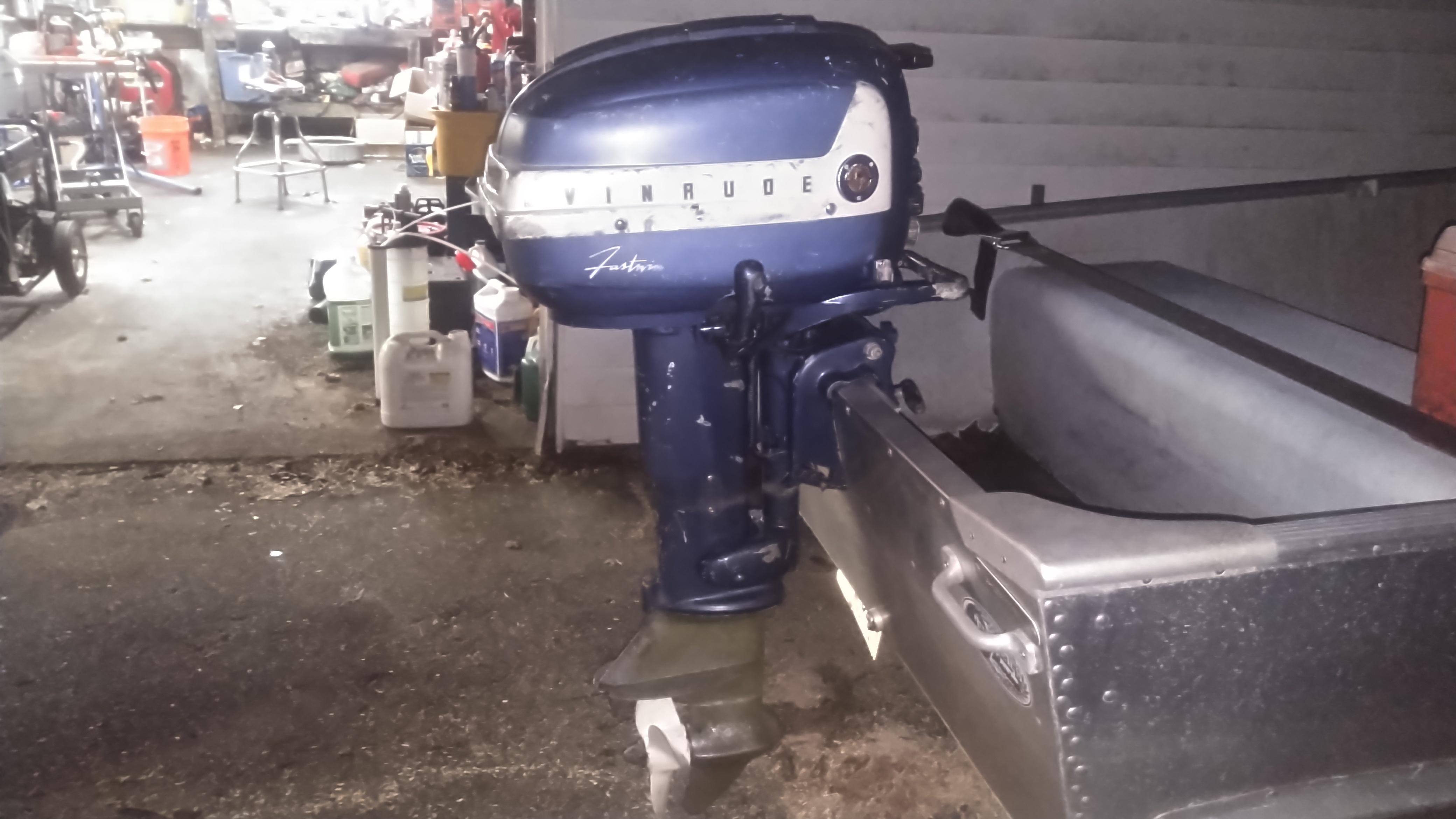

Yessir. The club has about 3000 members internationally and nationally.
Did you know Jeff used to be a professional fisherman? He tries talking boat stuff it goes way over my head. Anyway that little motor looks cool.
