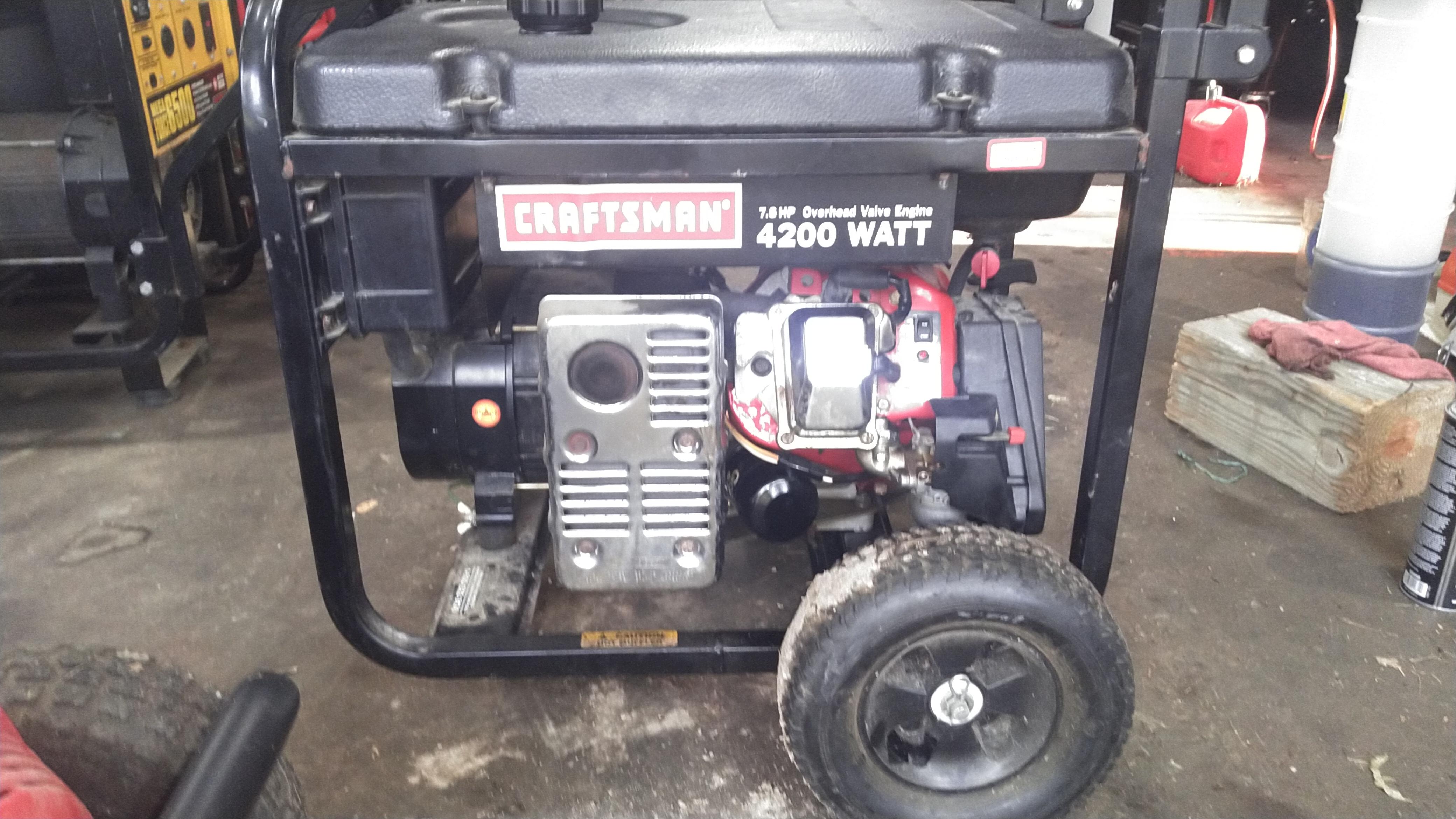

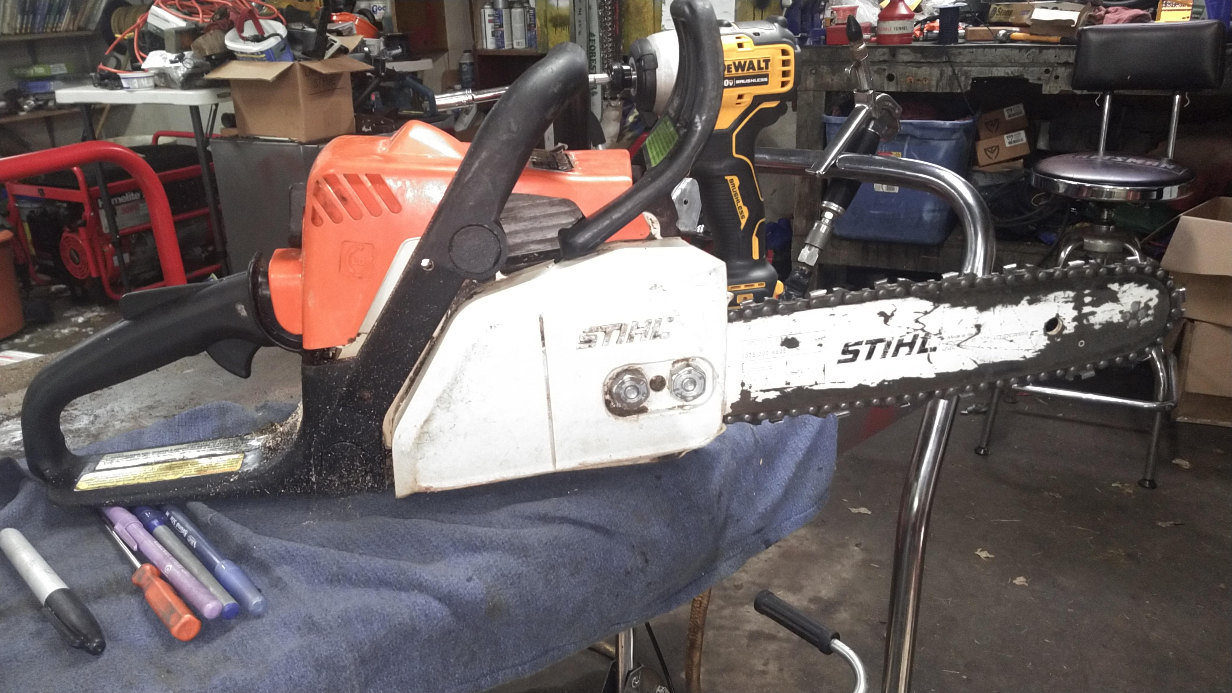

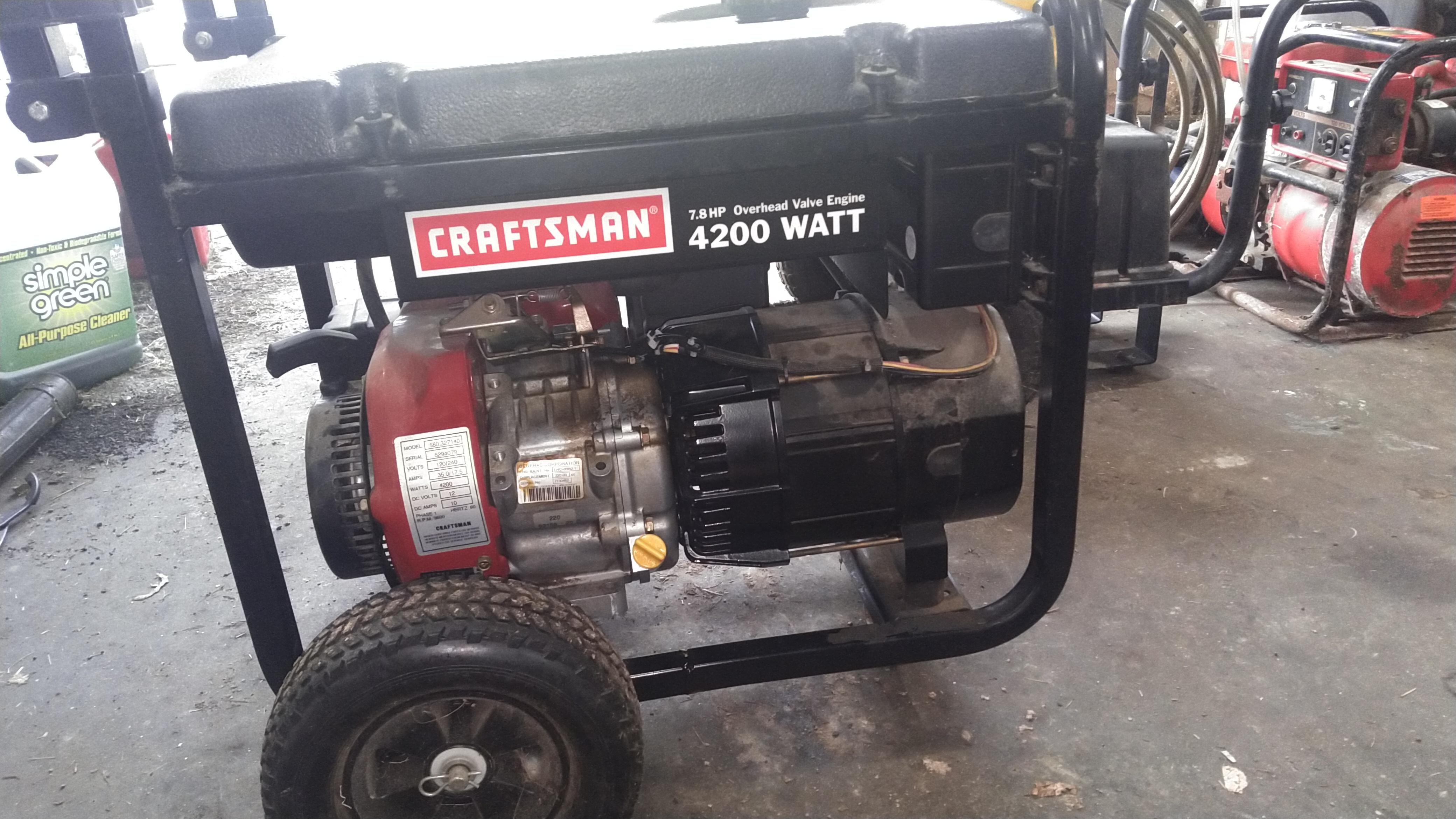

Craftsman generator ran for an hour to diagnose a leaking rear main crank seal. Started right up, I must have flooded it really bad Saturday afternoon tipping it up to degrease it. Just need to change the plug once it's cooled off. Stihl MS170 sporting a massive 12" bar got a new carb and test ran and idle speed adjusted as needed. Again just need to toss a new plug in it once it's cool.

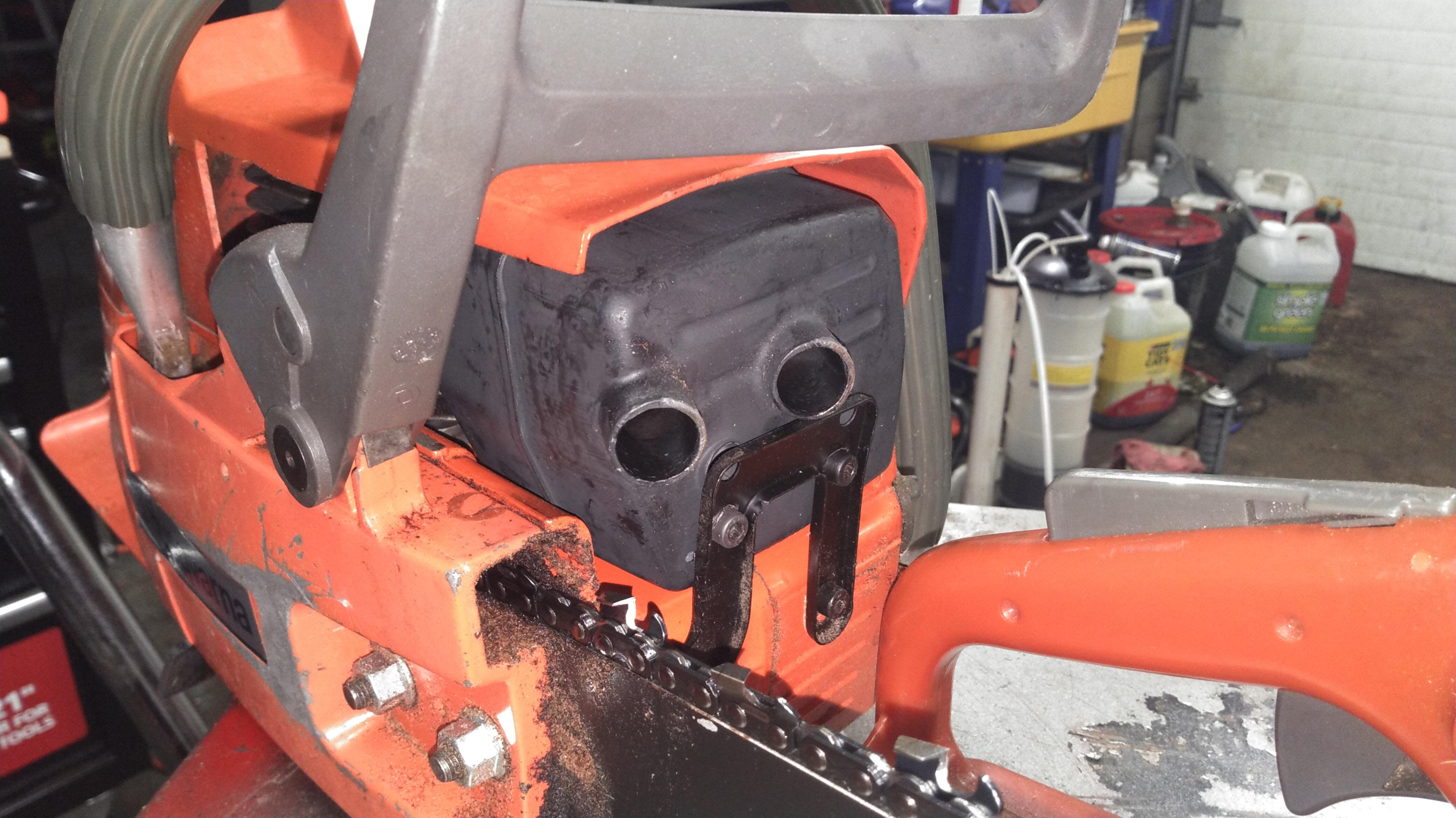

Pics of the weird MS 880 muffler and set up. Two clips held in place with a steel spring clip! Muffler looks to be one piece, thick, cast aluminum.
I would suspect that someone swapped that cyl at some time. The cast aluminum clip on muffs were standard for the 088’s.
Edit: the 088 muffler bolts to the crankcase, maybe yours was a transition model. I see yours bolts on too .

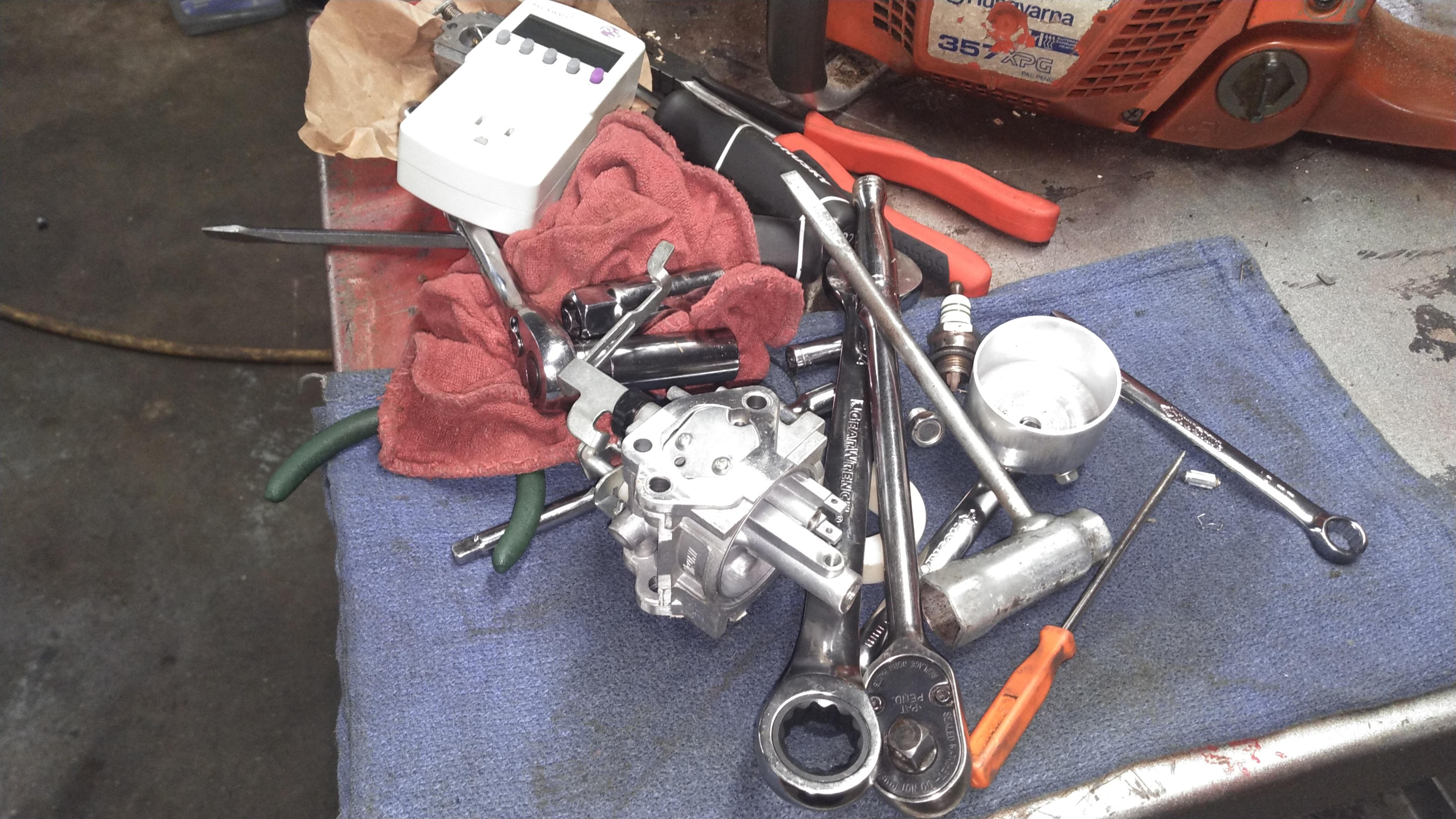

Homelite generator that needs a carb. Inlet needle is hopelessly stuck in its bore. Carb was overflowing....

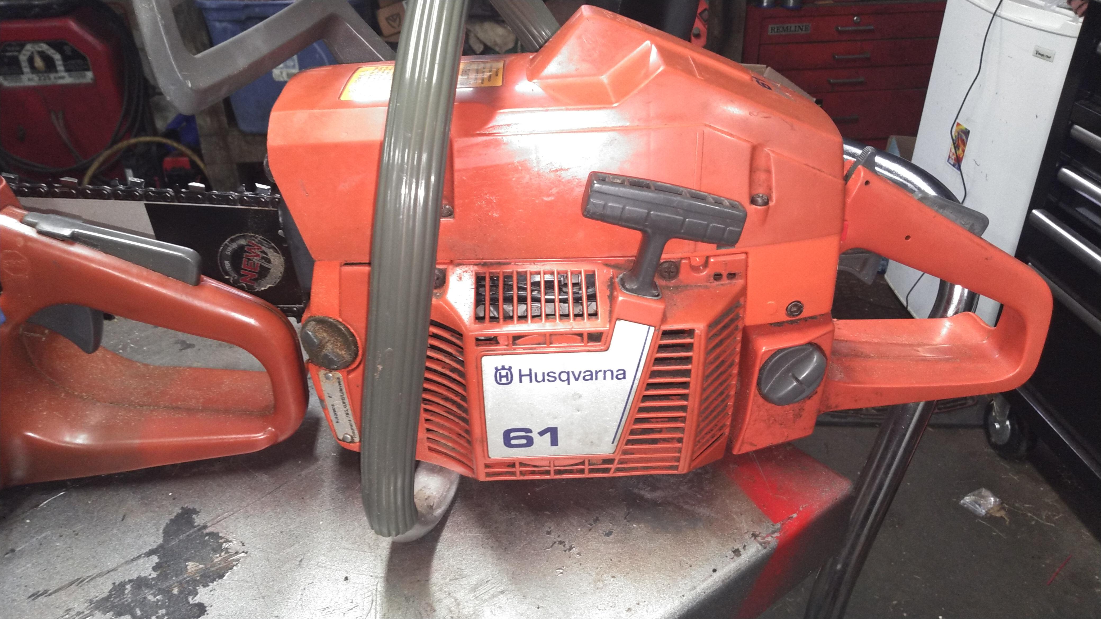

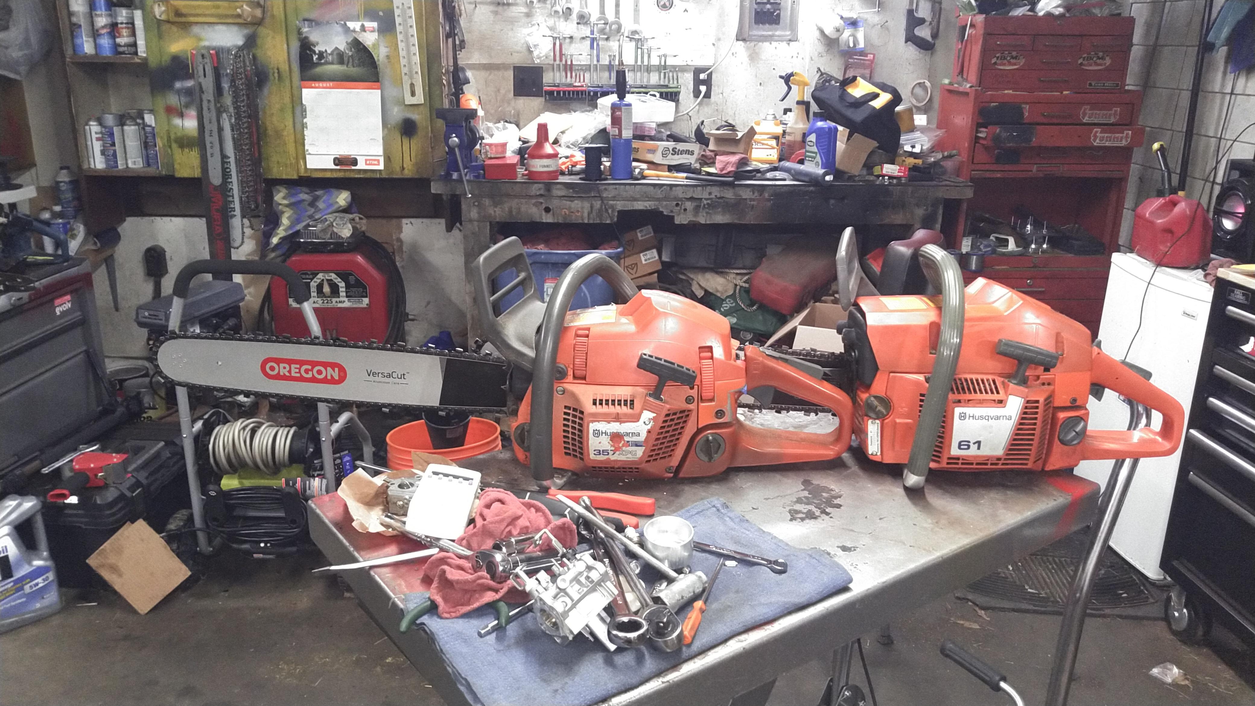

Fired up my 61 to 272XP conversion and my 357XP that came from @rattler that I built early this year. Both fired right up and they both just needed a teensy carb tweak. Have a new stop lever and harness coming for the 357 as the terminal keeps popping out of the lever and I have to choke it to kill it.

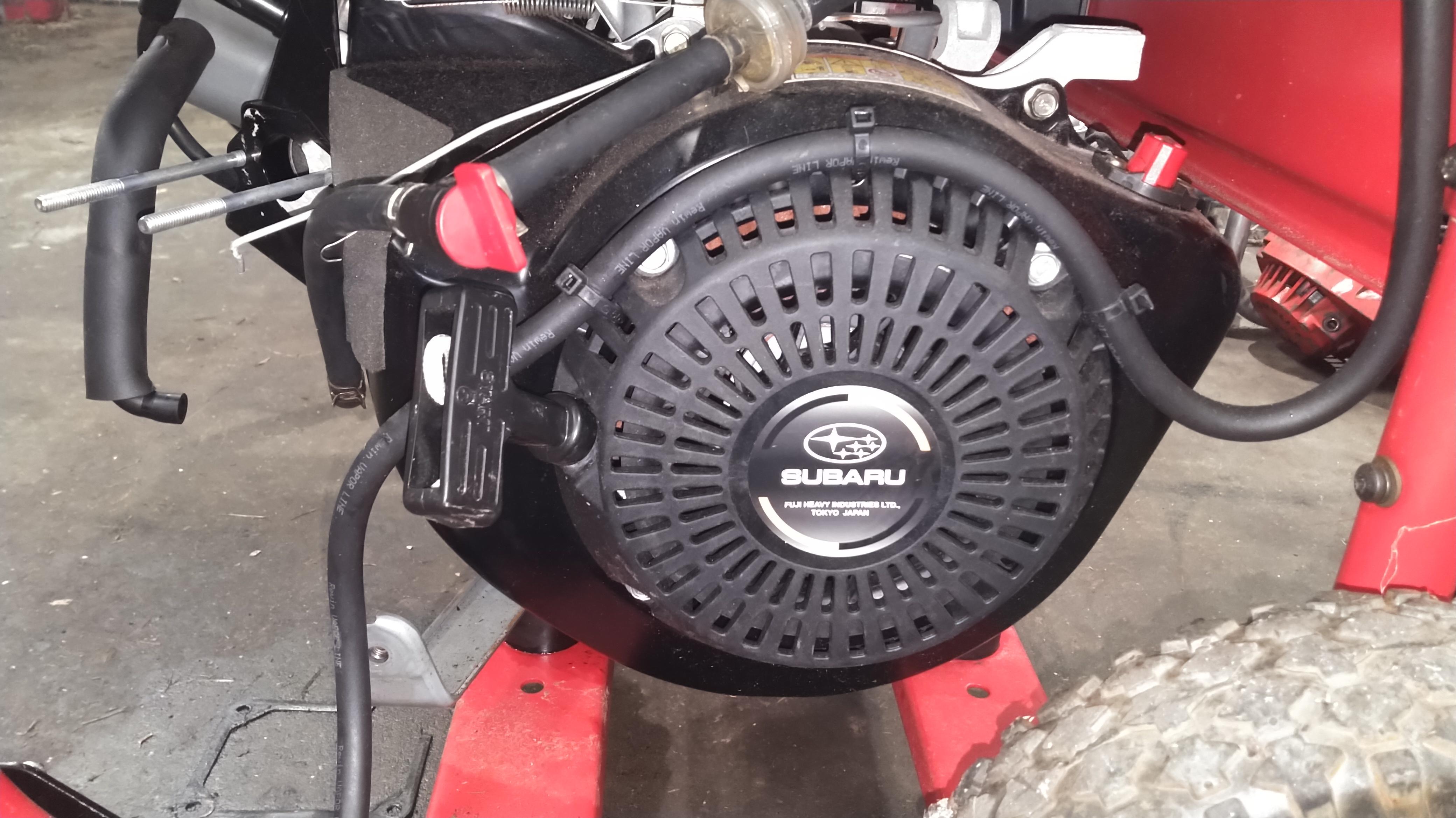

Had a customer pick up his generator and pressure washer. My work pile is getting smaller so I'll have a little bit more time to work on my own stuff. Jammed out to some Joe Diffie.
