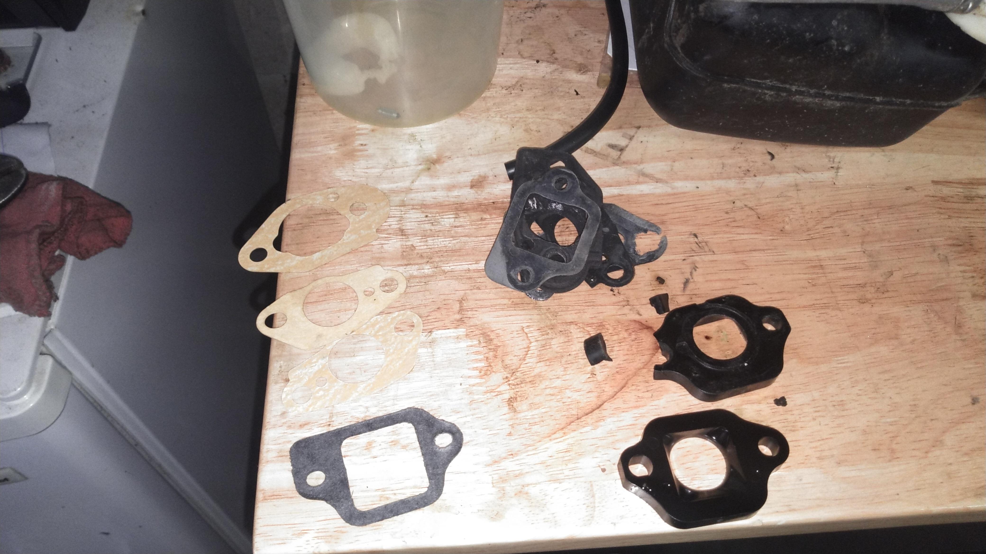

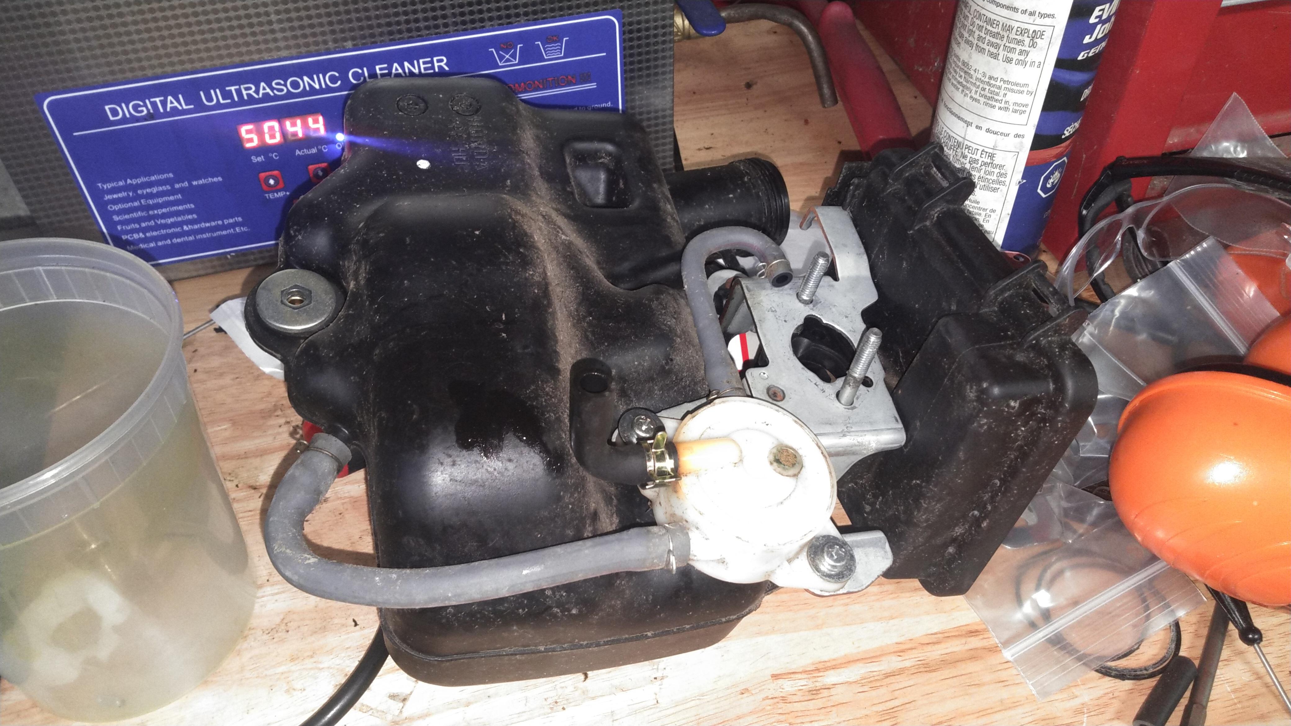

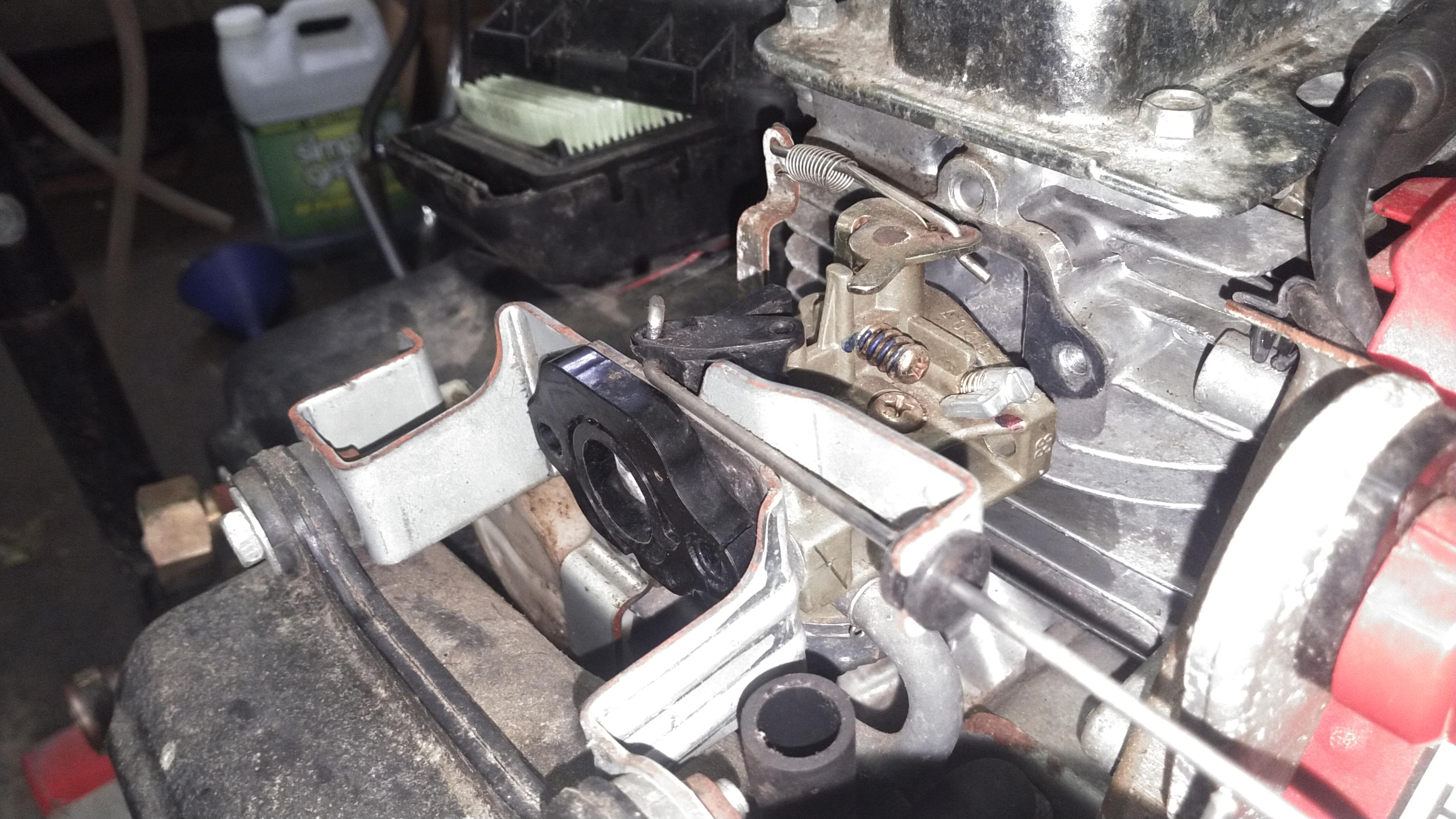

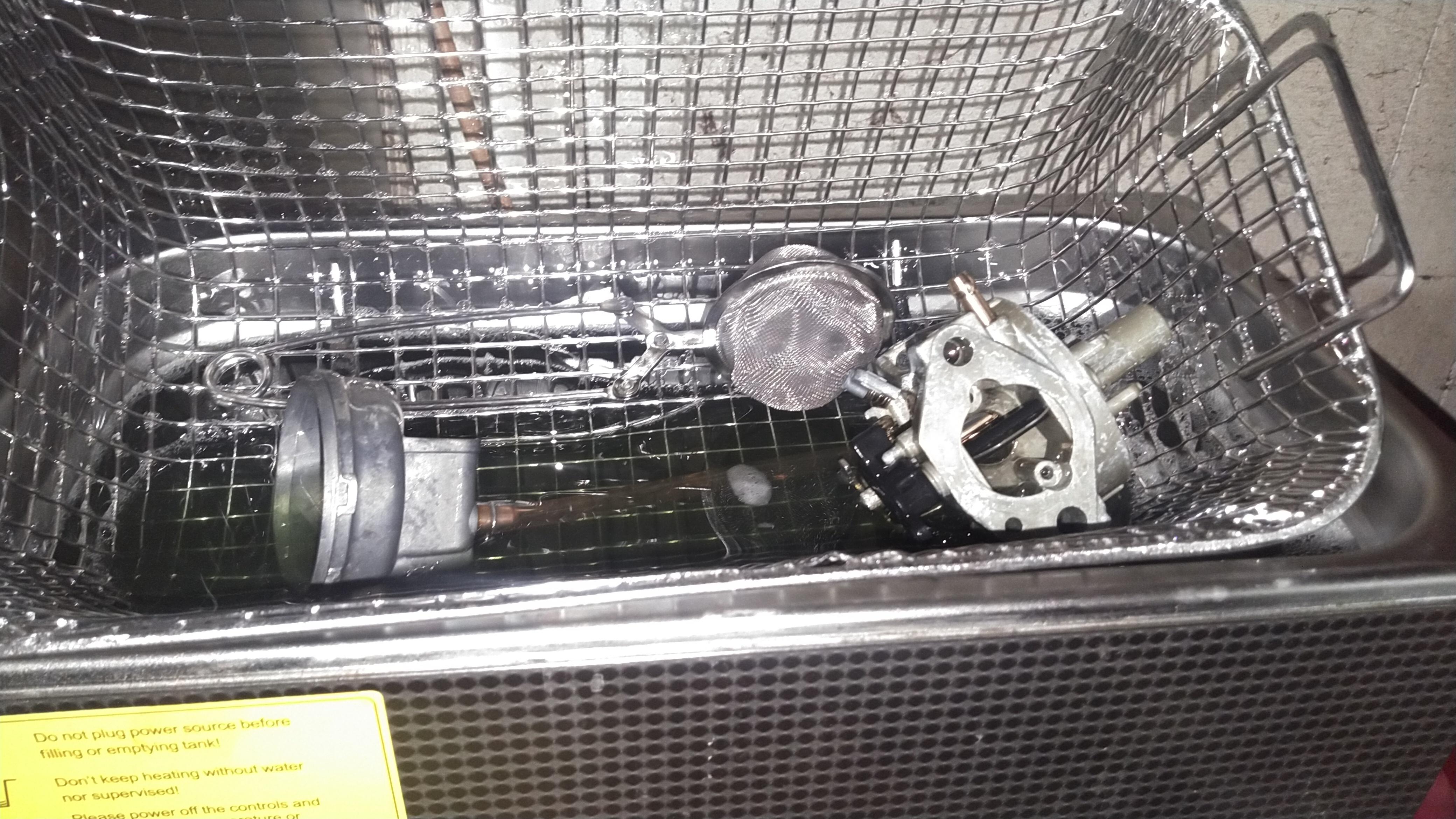

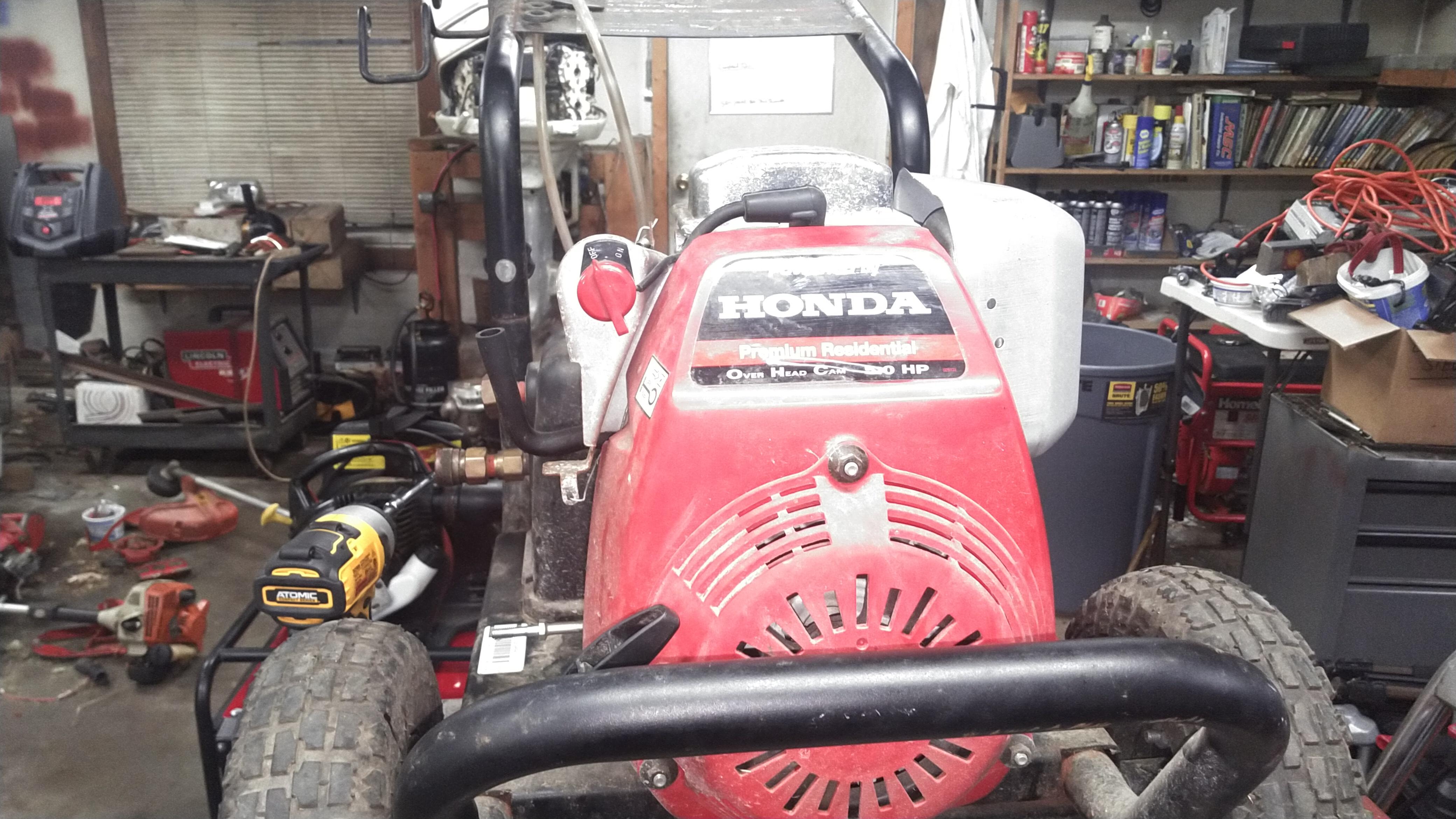

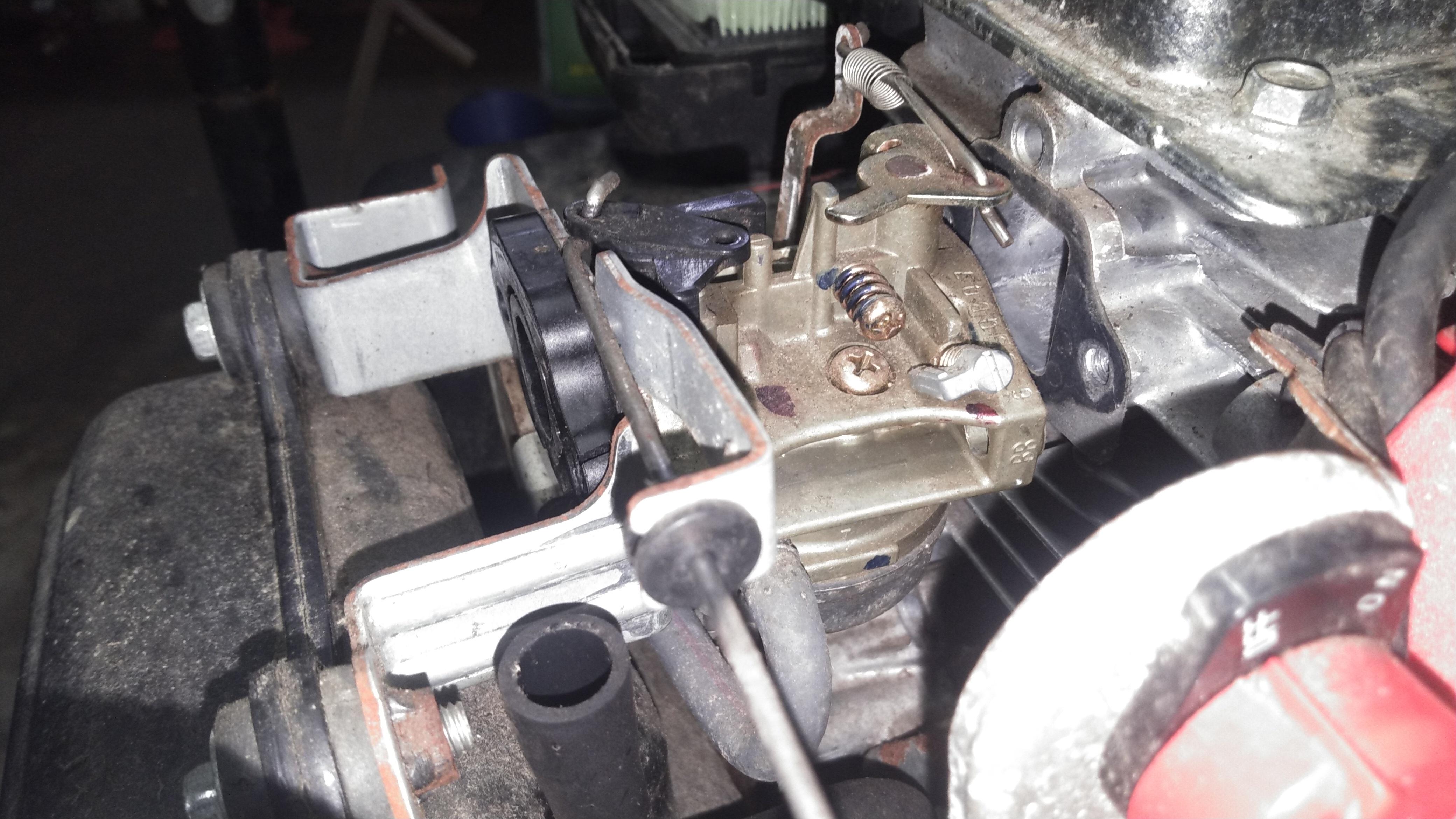

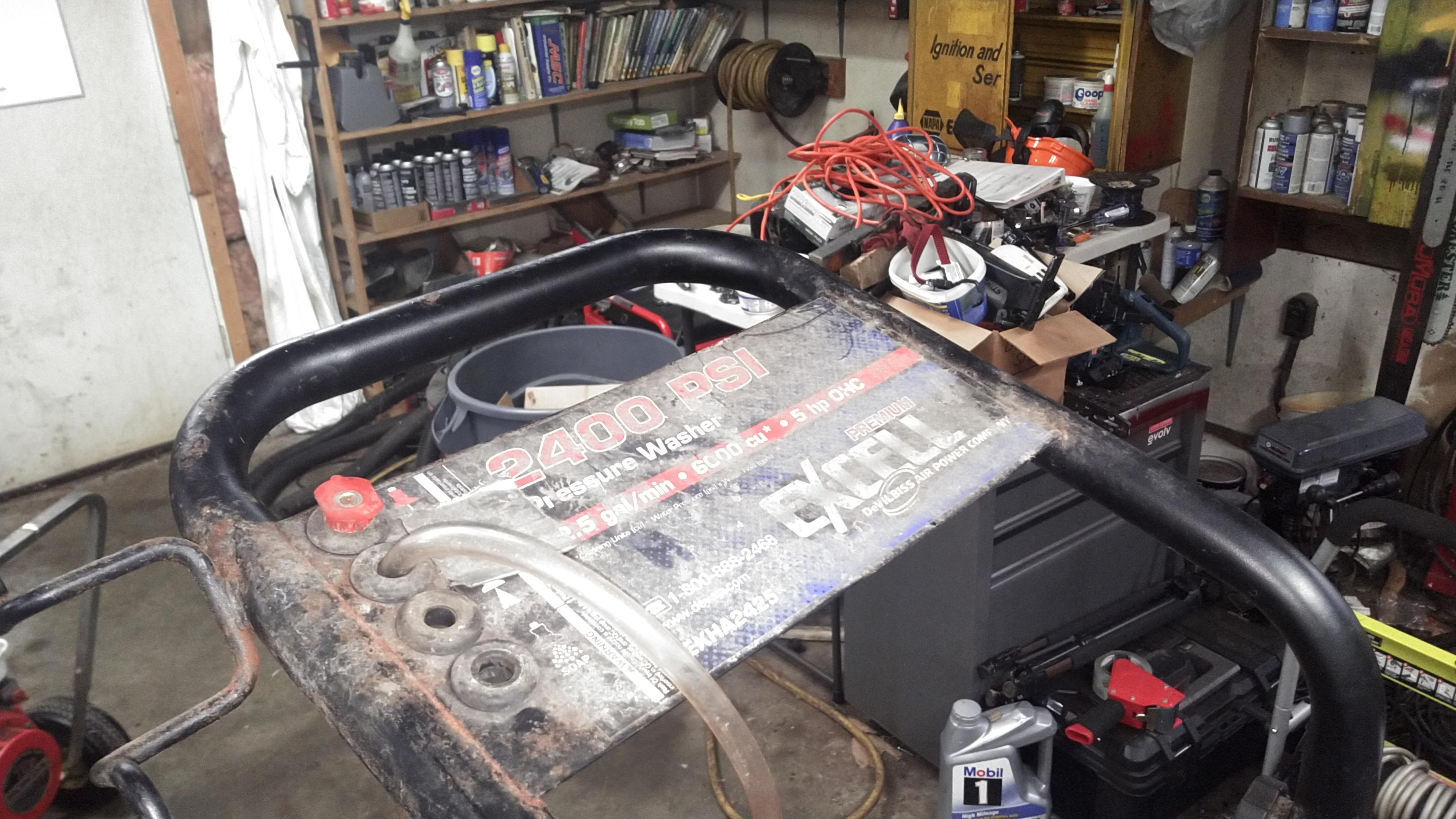

Honda powered Excel pressure washer. Getting a carb clean in the ultrasonic cleaner, a new intake spacer and intake gaskets. Came in and was overspeeding. Someone who worked on it before didn't know what they were doing. Also dumped and cleaned the ultrasonic cleaner and filled with clean Simple Green and water, cleaning the carbony cylinder head really got it nasty.
