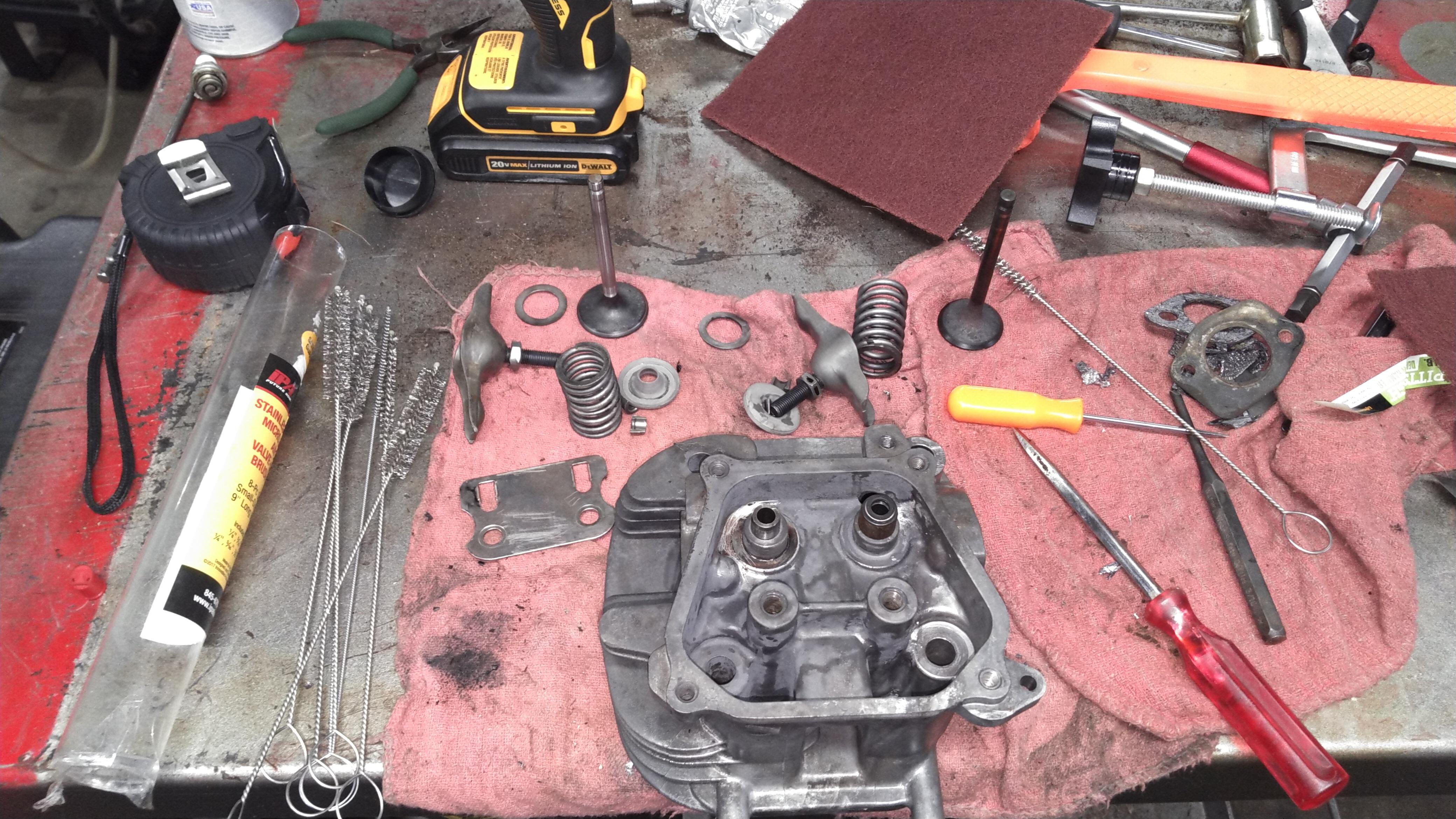

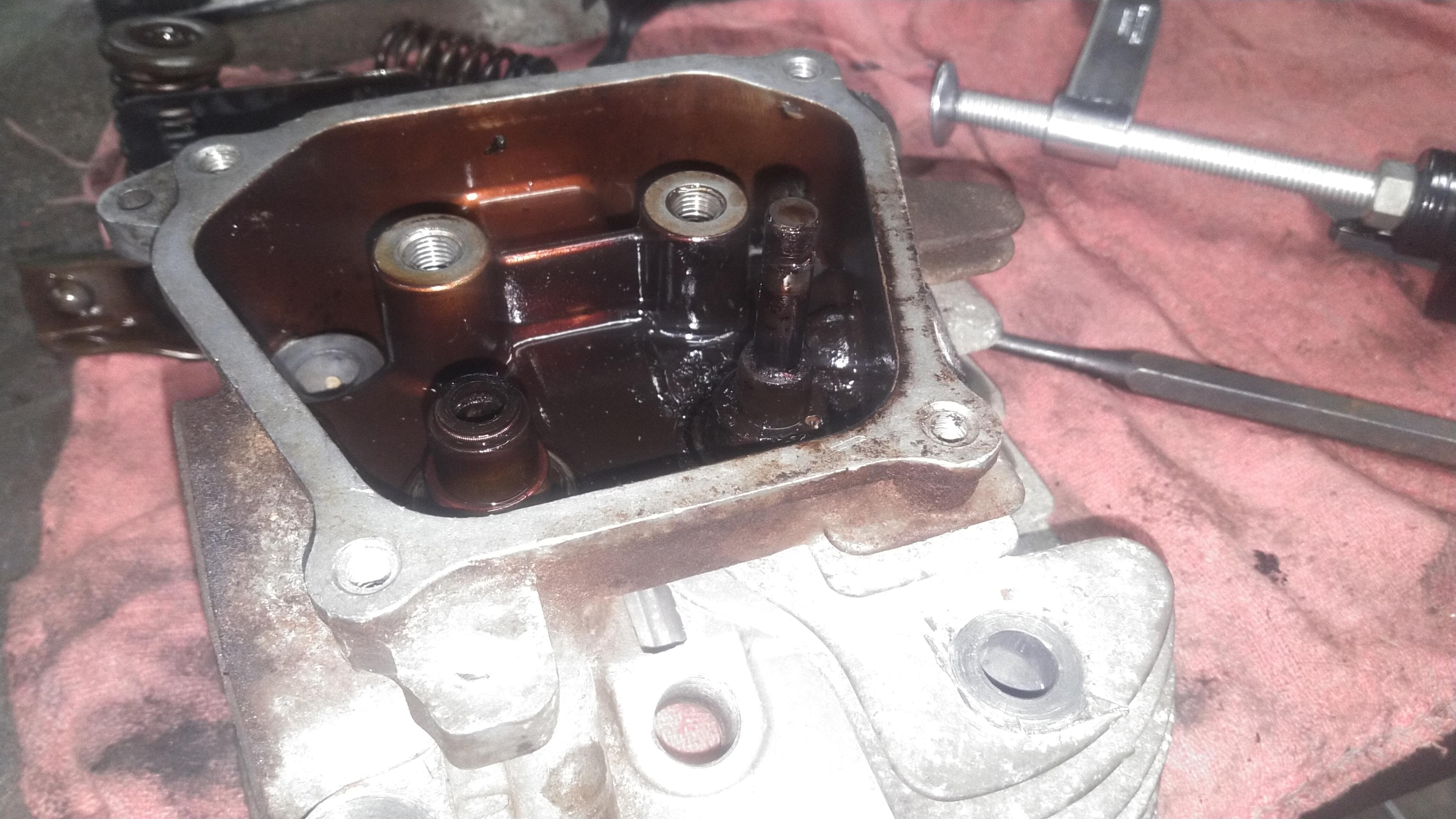

Generac cylinder head disassembly and cleaning. Found coked up and sticking exhaust valve. A thorough cleaning, valve lapping, new gaskets and seals will have it going again. Saving him about $600 as a new Generac 6500 watt generator is $800

Looks like an ultrasonic cleaner was involved.
