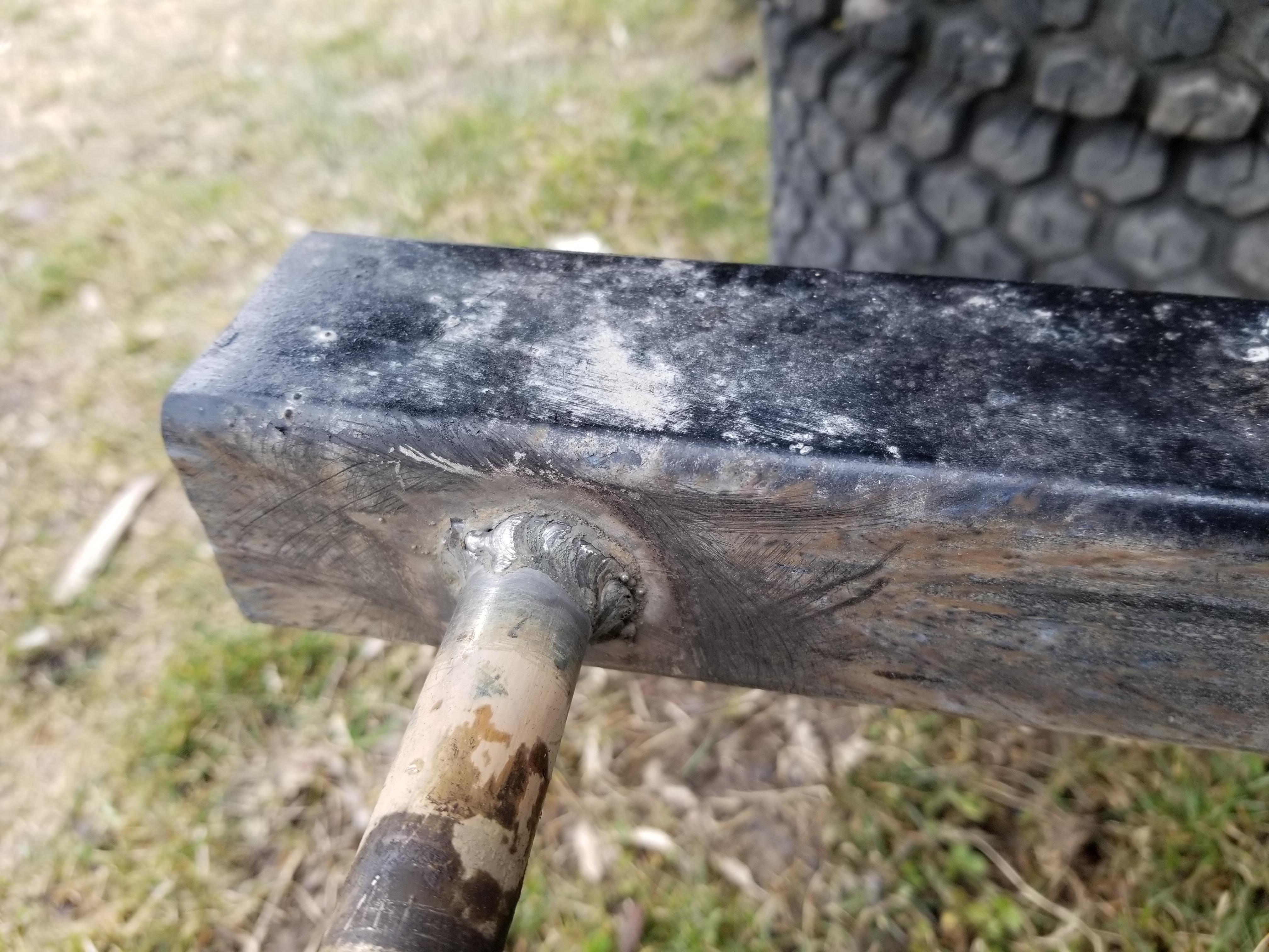

Working on the atv wagon. The guy who make it never had the axles very straigt so redoing that. Also only had a couple little tack welds holding it in. Glad i really havnt used it much cause sure that would last three seconds with a load of wood in it.
