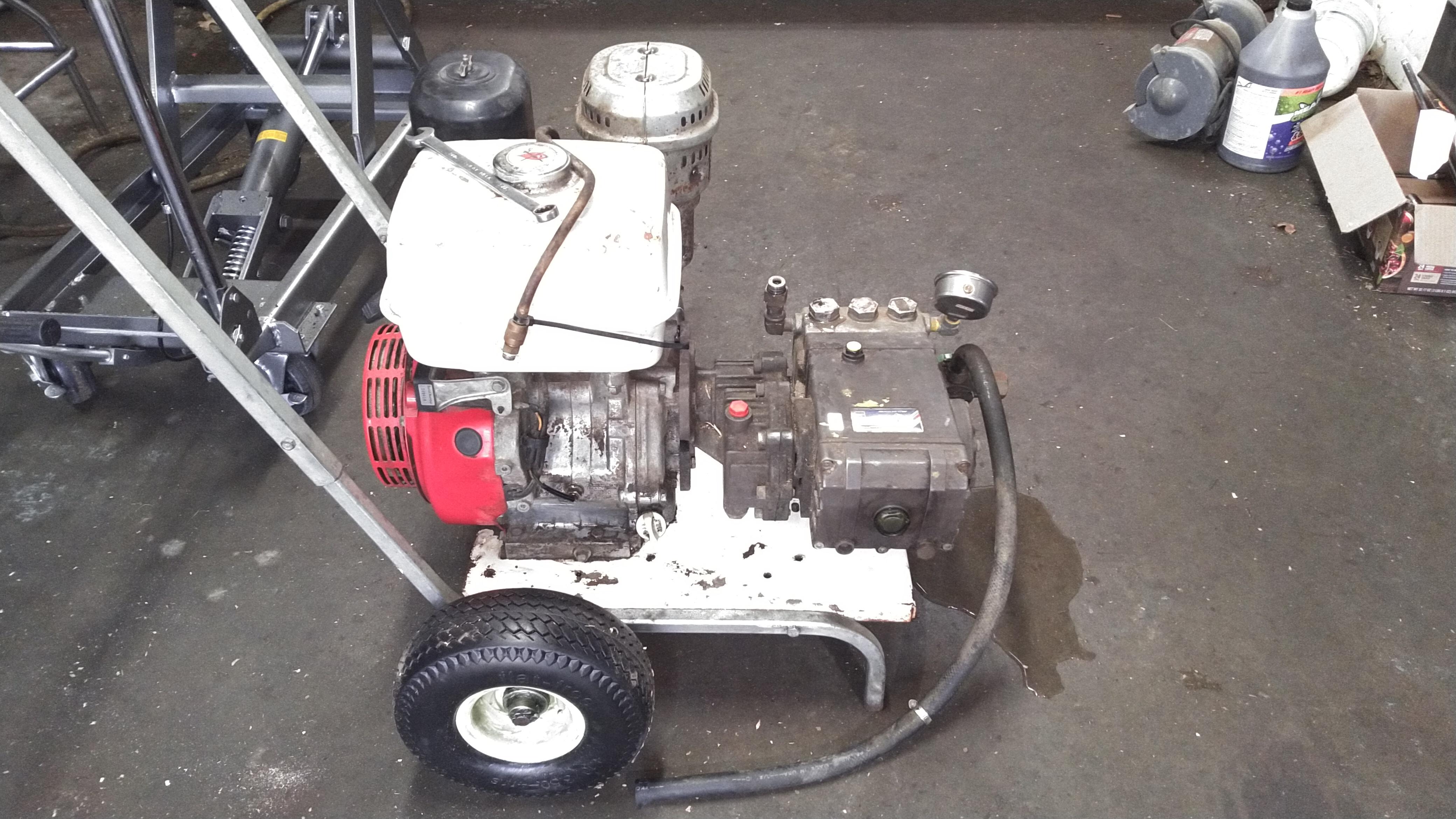

Dad's buddy's pressure washer. Was going to test it out earlier today but had no water coming out when I squeezed the trigger. Did some disassembly and found the soap injector plugged solid.. need to source one along with an inlet check valve for the unloader. Unloader is working as I can adjust the pressure from 0-2000 psi. Also got the oil pump upgrade done on my 340/346.
