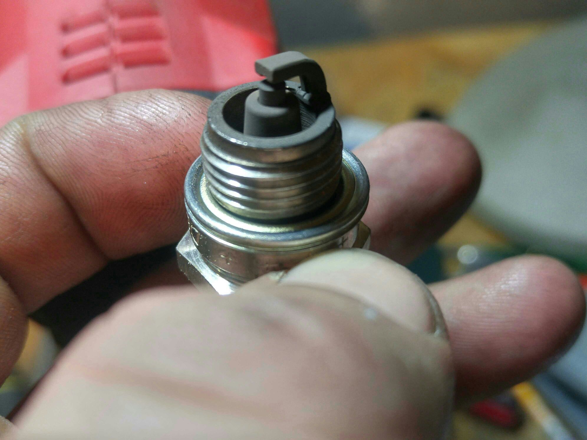

The first couple tanks of dumonde kind of stunk bad when i ran it ,i think because it was burning off the old previous oil residue ,i left the same spark plug in also ,and it cleaned it up also and the electrode .

Dumonde plug.
