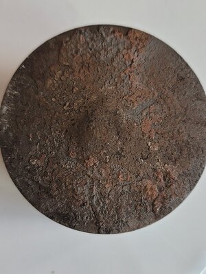

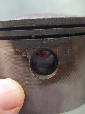

Because I tried Schaeffer's 7000 boat oil at 32:1 which is like water compared to H1R and that Schaeffer's was a disaster. Blackest plug after one tankful, plus it just didn't feel right. I've tried many oils in that blower. Some at 40:1. Let me just say that 50:1 runs much better. Saber @64:1 runs great. Edit.... Pic below of oils I have used. So, when I think 32:1 with H1R wouldn't work....
I run Schaefers 9000 in every two stroke and 4 stroke equipment I own. The piston and cylinders I have taken off were very clean !

His plug is black because the carb is rich....
No it wasn'ttoo rich. The carb was adjusted properly. BW your assumption is what it is based on your experience and your comment is welcome but in this case it's just not correct.
Edit... Now what could be is too much oil... I think I was at 32:1 perhaps 40:1 at leanest oil. But .. with the viscosity what it is on that tc-w3 I wasn't comfortable experimenting with 50:1.

Black plugs are from low load, poor carb tuning or both. Most guys cant tune a carb to save their lives! Its pretty simple to figure this stuff out.
With a 4mix I would run the thing lean to the point you started to have running issues. Its a 4 cycle so you won't burn it up.
