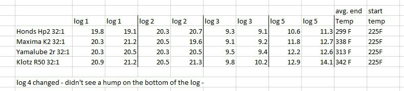

I can't find it. Pretty sure the 800 wasn't the fastest or it wasn't in the test. In my tests it was the slowest by about 8%. Here's the chart with the hp2 being the fastest.
Klotz the slowest? Again, different saws will probably different results.

different ratios as well.... H1R was faster at a different ratio if I remember right.
Klotz R50 is a pretty thick oil...

I would think a higher viscosity oil at a low ratio would be for protection and not performance? Too much oil will impede combustion resulting in less performance? Plus some oils dont combust as readily as others

Why would anybody run a high viscosity oil at 32:1?
