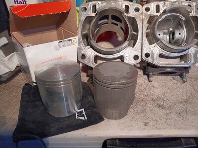

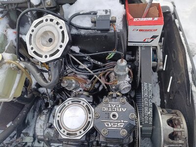

Still using cheap/plain-jane Lucas 2 cycle in all my 2 strokes. Can find it at any O'Reilleys napa or autozone for $9.99 a quart. Year #3 in the saws using lucas.
Funny thing: completely overhauling an 80hp suzuki 550 2 stroke. Oil injection tank full of lucas. Just bout finished out. Compression was a little low at 7000 miles. Ring gaps sloppy, piston skirts deformed and sloppy.
Anyhow, I noticed that the throttle cable is broken! The oil injector pump side if the cable is snapped and wasn't working. I dont know how long this motor has been fed oil metered only for idle, while I full throttle the fker every day.
The bottom end is just fine. No signs of heat not a spec of blue discoloration on the rod ends. So just a routine top-end refresh.
$120 for a freaking throttle cable. As much as a forged piston.

Be careful of those Wisecos as it pertains to warm up and skirt to wall clearance. Also looks like the crown profile is going to give you more compression.

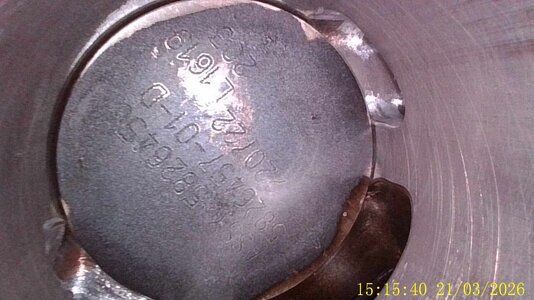

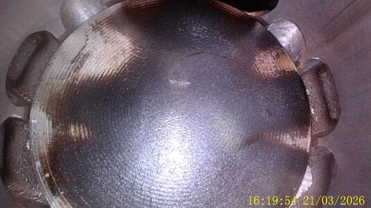

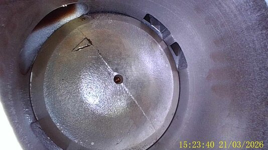

Let's see some pics.
Echo 355T Handful of tanks only run on Dominator @32:1
Husky T435, only ran on Dominator. Dozen or so tanks. @32:1
Husky 346XP. Ran on mostly Bel-Ray H1-R and then Honda HP2 over 12+ years. @32:1
Husky 550XP. Ran first on HP2 for a winter and then on Dominator this winter. @32:1
