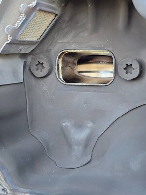

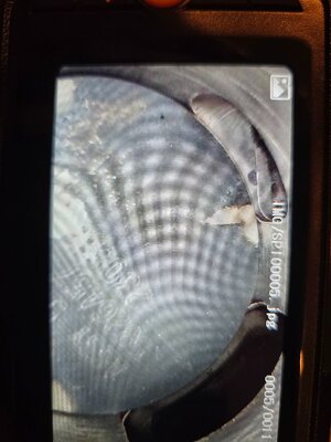

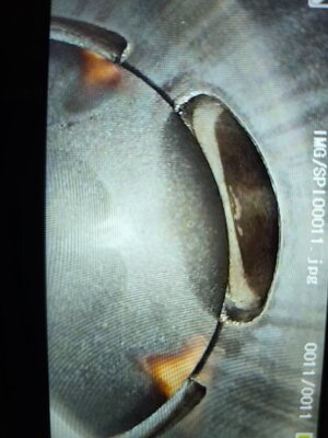

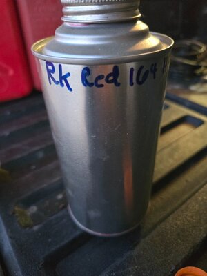

Husky 550XP 3 gallons of Maxima K2 at mostly 32:1 with a few tanks at 40:1. And yes that is red residual oil. K2 doesnt have much color so I add some of the red dye pictured. Same stuff used to dye diesel fuel.
Clean exhaust port, clean piston, nice wash albeit the transfer flow is uneven, muffler is dry, plenty of residual oil and the ring area is bare metal. Perfect performance in this saw. 20260319_200446.jpg20260319_200435.jpg20260319_193612.jpg

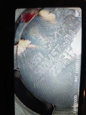

Stihl MS 400c I am not sure on how much fuel I have ran through it. Maybe 5 gallons? Been ran on Echo Red Armor since new. Clean exhaust port, symmetrical wash, little thicker/darker carbon on piston, but by no means bad, shows slight coloration above top ring but nothing below, muffler is bone dry. Also very good performance, although probably not as clean as K2 long term.

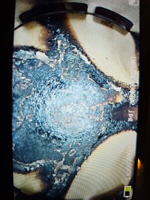

Husky/Redmax 580 BTS blower. This unit is 12-15 years old( I cant remember exactly)and has high hours. Has been ran commercially by my son and I used it commercial years ago when burning stump piles while clearing land. No idea on hours but alot. 1000 would not surprise me. It had a leaky base gasket maybe 5 years ago which I replaced. When I had the cylinder off I also cleaned the piston crown, which had some build up on it. Blowers are pretty low stress. Its been run lately on K2, before that Red Armor and before that Honda Hp2. This piston does show some ash build up, which is the crusty white stuff. Not supprising as its low stress and ran wide open for long periods of time blowing snow and leaves. It also run it intentionally rich this time of year as it might see -20 temps hence the ample wash. For summer I will tune it back to normal settings using the Redmax tuning reccomendations.20260319_202113.jpg
