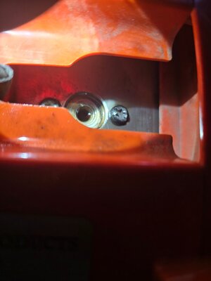

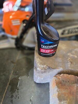

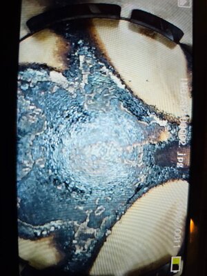

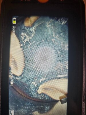

Based on @lilspenny comment that Chevron Techron removes carbon from pistons I decided to give it a go. I will say I was very skeptical because I have never found a product that removes carbon well and not for lack of trying.
I brang the piston to TDC and filled the combustion chamber with Techron on Sunday morning as can be seen in the second pic. I let it sit until this afternoon. I then proceeded to start blower and do some yard clean up for maybe 15 minutes. I then applied the cruise and let the machine run wide open for 30 minutes to burn off the Techron. Here are the results.

I guess the oil. A guy posted pics of piston crowns and cylinders with reference to using a certain oil; so do the pictures indicate the oil is good, bad, or somewhere in between. I have no idea what the pictures mean, so I am trying to understand the purpose of the post.
Glad you asked this.
What one looks for is as follows. Ideally you want zero deposits on the piston skirt and specially the ring lands and grooves. The piston crown should have a light covering of carbon with small amounts of wash where the ports discharge. If the piston has a bare metal crown it either hasn't been run much or is pig rich. The crown should not have any crusty material or raised carbon as this indicates mettalic ash build up. The color of the crown should be from a dark grayish color to light black. The darker and heavier the coating the dirtier the oil is. The exhaust port should be clear of any build up. Staining is fine, but you dont want to see raised or flaking carbon. The muffler should be dry and free of oily residue and the spark screen should be clean and build up free. The combustion chamber should have light carbon with no raised buildup. Depending on porting its normal for the combustion chamber to show some bare metal or not. It just depends. Spark plug should be a very light tan color. The under side of the crown will have some carbon build up if the motor was ran hard. This is normal. What you dont want to see is an ashy grey appearance as this means the piston has gotten close to its melting point. You also dont want to see any sort of sand blasted appearance on the piston crown or a burnt out spot/divot. The former is indicative of detonation and the latter of pre ignition. You want to say adequate residual oil on the piston skirt and in the crankcase.
The above assumes quality oil and fuel are used.
