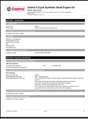

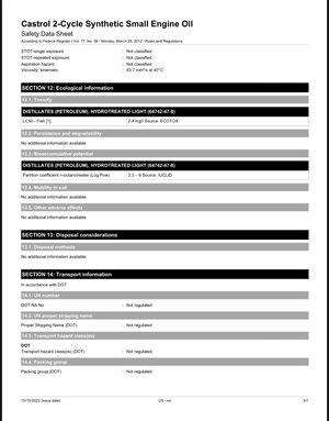

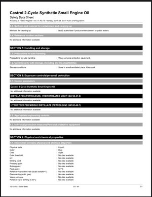

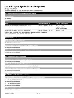

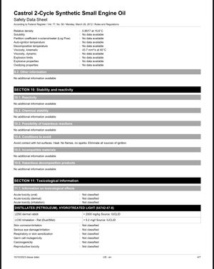

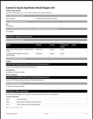

Both are made by Lubrication Technologies. The question is whether they are the same oil. I am having trouble finding the correct SDS sheet for Castrol to compare them. Interestingly, though, the Castrol JASO certificate number is suspiciously close to numbers held by Husqvarna. Maybe it is blue for a reason?
Here is the sds for the Castrol....
lilspenny
3:16 PM
31957
Feb 25, 2025
234
343
35611
here...
also see next, as I am limited to 5
