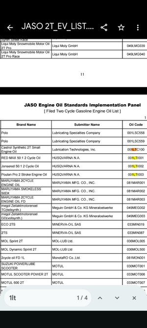

Chumango
12:27 AM
32763
Apr 30, 2025
19
61
TN
It's fd rated so it can't be that bad. I don't know why but I think they make vp oil. Or both made by the same parent company?
Both are made by Lubrication Technologies. The question is whether they are the same oil. I am having trouble finding the correct SDS sheet for Castrol to compare them. Interestingly, though, the Castrol JASO certificate number is suspiciously close to numbers held by Husqvarna. Maybe it is blue for a reason?
