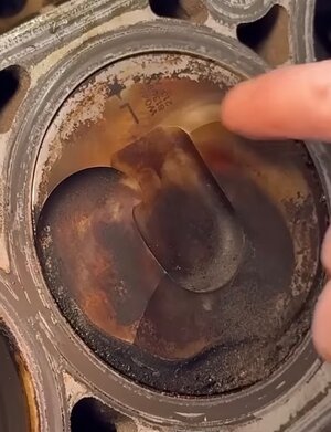

See the lighter brown on this pic I found online. It's like that but hard and shiny. Like marine varnish on a classic wooden boat.
How long did you run it in the blower and what did you run in the blower prior

That is completely normal.
One thing I was not anticipating during my evaluations was the variation in gasoline. I have bought from three stations and one, a Valero with 91 octane, just stunk it up. I had not seen this piston varnish prior to the Red Armor, and I had been checking. It's definitely not a big deal. I will say that after a couple of gallons of Red Armor I switched back to Saber 50:1 and started seeing the piston getting cleaner. I got the guts to try 64:1 and the piston got drier and did not continue the cleaning. However, the engine ran better. Yes, I adjusted the carb and yes I know how. I tried 32:1 Schaeffer's boat oil and my sparkplug turned black all over. As part of my brief evaluations I have run k2, Motorex Crosspower 2t, and Super M Injector. Oh, and VP. There is another fellow participating with his br800 and we are comparing notes. Back to the gas... The 91 gas got poured into my truck and I'm back to 93 which is good. Interesting finds with these oils. I do intend to use Red Armor again since it is a great oil. I have checked the exhaust valve and all looks good. Honestly, the Saber, Motorex, Red Armor, and Super M Injector have run very well. Since I'm not sure of the gas used with the Red Armor it will be run again to check for a clean burn. I will venture into ashless after a short while. I see absolutely no reason to try Stihl Ultra. If for no other reason it smells bad. If Stihl did indeed design Ultra for 4 mix engines they need to update. The motorcycle oils and Saber are quite impressive. Would Dollar General oil work? Yep. I' also checking rocker arms for lubrication and my goodness the Saber is top notch. As someone with 18 years of professional experience it never dawned on me to try to find a great oil until I opened my fs100rx and saw black crud on my cam and that same day I got a good whiff of Ultra. So, it's all for entertainment, and that's all it is. From what I've seen so far, one oil, sll machines, one ratio, as a pro I'd choose Saber 50:1. As a homeowner, since harsh conditions are not so prevalent, since the Motorex seems to run the best by a very slight margin it might get the nod. BW, thanks for sharing your knowledge. Stihl has really ticked me off with their environmental push while at the same time pushing Congo batteries and fb Ultra.
