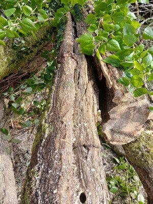

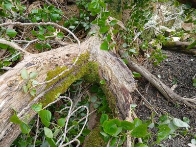

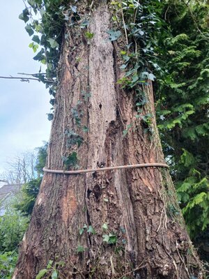

Okay I got a good one.
Today we took down a poplar that another, well respected tree surgeon had "pollarded".
He must have just cut straight in from the back each time without any sort of notch or back cut because each stem he cut off peeled off several feet. Some even peeled all the way down to the ground.

Here's some more pictures showing the extent of the damage. This was the better of two trees, another company took down another, worse one.
Needless to say the landowner was horrified when the original job was done. I wasn't really surprised when I heard the name of the culprit. He's been cutting trees in this area for 40 odd years and somehow still has a good name after pulling off several stunts like this. Although, this is by far the worst I've seen.
The timber was actually sound near the stump but well *f-worded closer to the top.

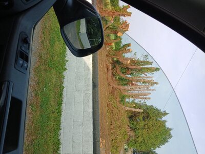

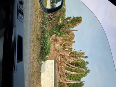

Found this yesterday.
Western red cedar.
No doubt the landowner did it himself.
Maybe it was windblow and the sprung back up once the weight was removed, I've seen it happen with trees planted in a row like this.
Or maybe they were standing trees and a lift was hired. I'd like to belive that.
Most probably everything was done from a ladder(s) with a supermarket chainsaw.
