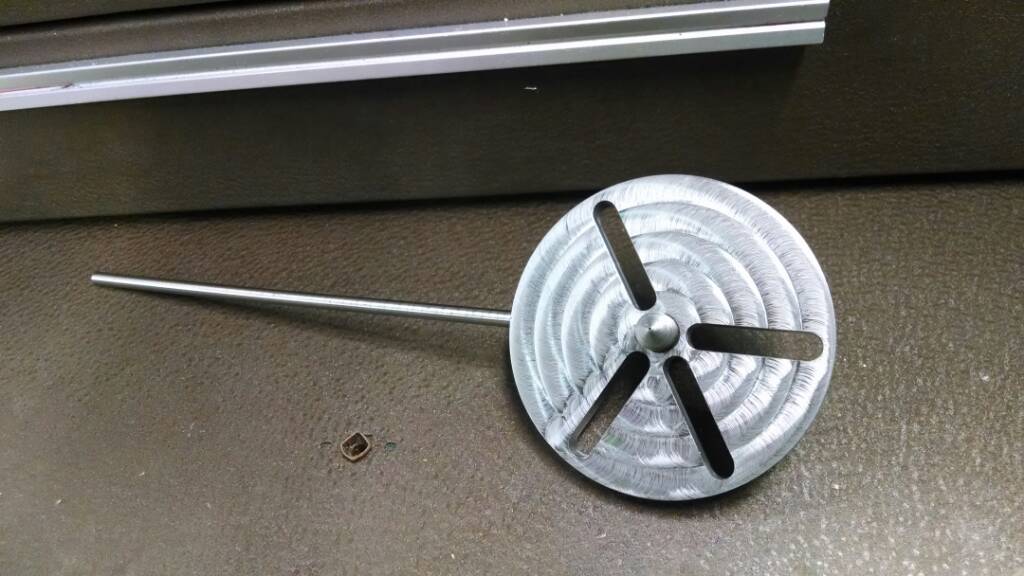

With your Stihl vac and pressure set, what is that part of the kit for with two gauge's for?
Also, what is the fixture that is right above the barbed outlet of the vac/pressure tester?
Two gauges, leak down tester. Used on 4mix engines. One of the tools i dont use. Not a fan of the 4mix.
The fixture, a test flange for the ms171, ms211. I assume the 181 also but i haven't put my hands on one so i dont want to give false info. Most of what i mess with comes in a box that to most people looks like trash. And is usually a 0 beginning or end saw20160213_221731.jpg 20160213_221719.jpg .
