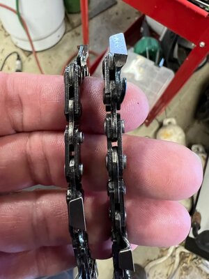

These were both spun on the Harbor Freight, the more uniform one is a single drop of cutting oil (tap magic) added to each rivet before spinning.

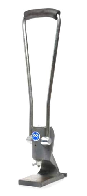

The Oregon ‘DuraMax’, or ‘Heavy Duty’ spinner and breaker were intended for larger, heavier, harvester chain, as I understand.
I have seen them used in shops for ‘regular’ chain, where people liked the increased leverage, etc.
Again, made by Tecomec.

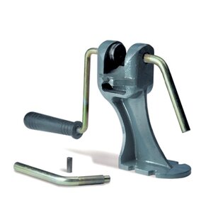

There were also a few electric rivet spinners, intended for shop use.

I like the basic, 2-piece set (‘Steel Chain Breaker’) above. I also have had good experience with the Bailey’s ‘Woodland PRO’ (also sold as ‘Carlton’) set.
