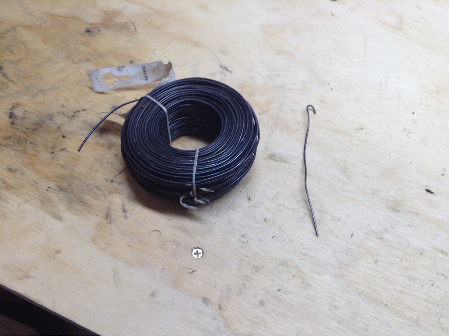

I have the seal puller that Rattler showed ... works well!
... but sometimes you need to use the drywall screw and the 1 LB dent puller .... :)
I recently got a Chinese version of the uber-expensive Stihl puller, but have yet to try that one.
Pics of the Chinese version puller, maybe a link to it
