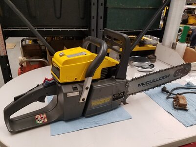

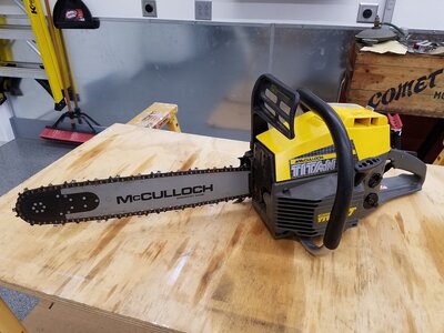

hacskaroly
2100 Fanclub Member
10:44 AM
27954
Nov 24, 2023
3,127
10,160
Northern Idaho, Ehh
did you buy this?
No, I was watching it, but decided to pass as I ended up going to Post Falls for an auto auction. Looked like a fun project saw though. I did bid on some items in the last Libby auction and was there picking up my stuff when the Homelite 360 was dropped off. I was thinking about that one too.
