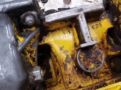

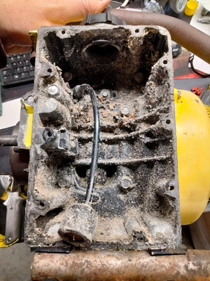

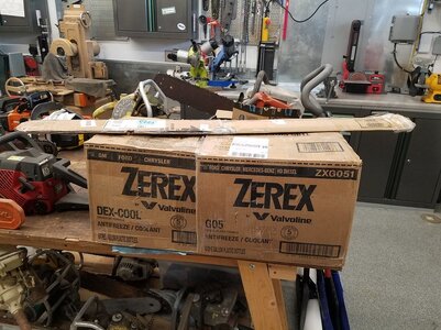

FWIW, I opened the boxes today (thanks Dan!).
In my case it is a 1-82 that is stamped with both 1-72 and 1-82 with the 1-72 struck through.
The 1-82 is the gear drive version and 1-72 is the direct drive 87 cc 1961-62 brutes.
This saw had a lot of experience...
There were also two 42" hardnose bars and some other goodies I have not fully investigated yet. The H&S spike has seen a lot of serious abuse, and the home made helper handle is really cool. I will find a way to include it in the display area.

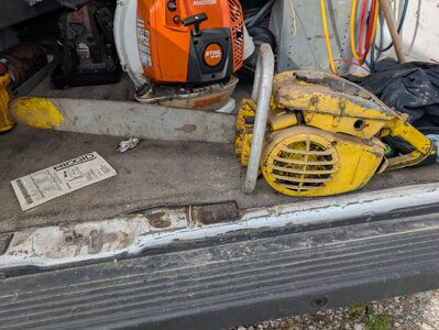

Well it happened again. I brought this home in part of a three saw deal. I believe it to be a S44A due to the square muffler and the flywheel cover. Of course any of this could have been swapped out, so if you think otherwise please let me know. I think it may have been someone's part saw as it's missing the frame brace, the inner flywheel cover, the air filter cover, and the outer portions of the muffler. The piston and cylinder look good through the exhaust port. @heimannm I'm sure I'll be getting ahold of you.

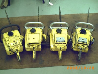

Saws with the hockey mask cover over the flywheel were usually S44-A or S55-A. The 44/55 saws were real hot rods in their day. The D-44 has a stamped steel AF cover and the spark plug in the center of the head like the MAC10 kart engine. The others were die cast AF covers and the spark plug offset to the LH side.

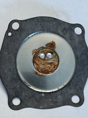

Just to pop in and let you folks know I now have metering kits available for the Models 4-30, 4-30A, 47, 49, 73, 77
Diaphragm Kits #19619, 28696A, 65566 These allow you to use your own parts with new a diaphragm and rivets. You can use the metal gasket that is on it or use the gasket in my kit to seal the metal one. Thanks for all your support over the years. Jeff https://www.ebay.com/usr/cinci5
I am sorry, this is not making any sense to me (probably since I don't own a 4-30 to 77 series), did the original saws have a metal gasket instead of a felpro type gasket?
1775227330649.png This one?
