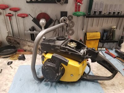

Today I measured the bore of the cylinder I took off, seems pretty well round and pretty straight top to bottom. My measurements were .001-.002" over what the chart lists for the "C" bore size. I will try measuring a "C" piston tomorrow and see how my measurements compare with the chart.
I did finish putting the saw together today with bit and pieces I could find around. Started and ran well, I was only able to run it for 2-3 minutes and no heavy load yet, but when I shut it down the compression was very good. If I have a chance I will run it longer under load tomorrow and see what develops. The clutch cover and bar & chain are parts I keep on the back of the work bench for testing saws.

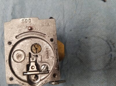

For now I have and SDC51A fixed H carburetor on the saw with the 32 jet.
The carburetor supplies plenty of fuel.

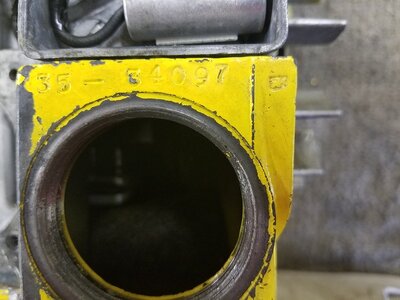

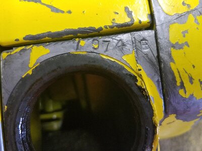

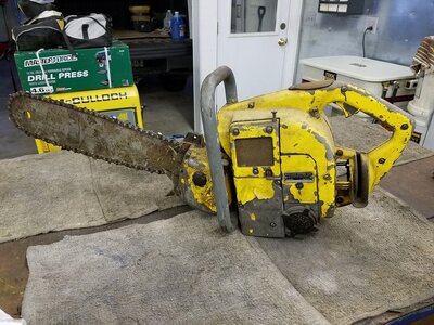

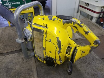

As far as I know there were only the models listed above. That particular saw is a 33, the 33B and all of the others had a much longer air filter. The 33 was the only one with that short filter. This 33 had an aluminum model/serial number tag riveted to the points cover.
33
33B
The 33B and most other in the series had the serial number and model number stamped just above the fuel cap.
35
Mark
hacskaroly
2100 Fanclub Member
11:59 PM
27954
Nov 24, 2023
3,251
10,506
Northern Idaho, Ehh
The service manual for the 33, 35, 39 is where I saw that there was a 33, 33A and 33AA. Probably not much difference between them other than when they were made.
