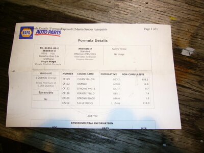

Many use Rustoleum Sunburst Yellow but that is a bit more orange than the original, very close to to the later Pro Mac saws like the PM800.
I have found some John Deere yellow and Industrial Safety yellow that were much closer to the original shade used on the earlier saws..
If I remember to look I will see if I have any leftover from the last McCulloch project and confirm what I used.
Some folks have had paint custom mixed to match the older saws, here is an example that was recommended to me:

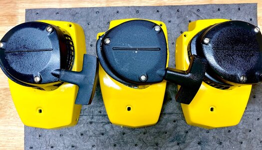

So I can tell you from personal experience that the paint on McCulloch varied year to year on like parts. These recoil covers are all NOS, sealed in McCulloch bags and stored in the same cardboard box for 20 plus years. If you look close each has a different tint of yellow.

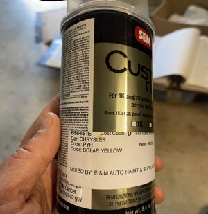

The paint I use for 10 Series...

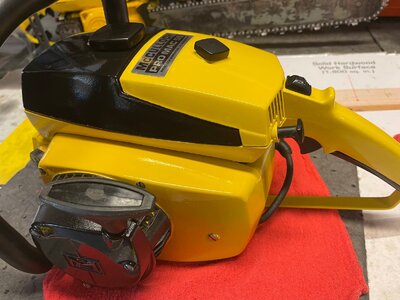

The results...
