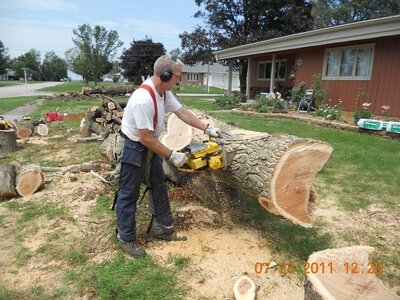

Beauty is in the eye of the beholder, and value is ultimately determined by the buyer. Apart from eBay it is probably a $150 saw in running condition. There are many models that share parts, but the commonly needed parts for those (AF cover, clutch cover/starter, flywheel housing) are often already gone. Most everything can be found but they are not as readily available as say the 10-10 models and parts.
I have used one cutting up a large locust that blew down in a storm, apart from the manual oiler only it was an ideal saw for a job like that. Without any AV you probably don't want to run it for hours per day, but they are pretty strong saws.
We tried to kill the Ranger that day.

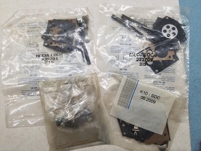

Curious if anyone knows a source for a complete rebuild kit for a SP125 Walbro SDC 20 carb? Looking for a kit with needles, etc.

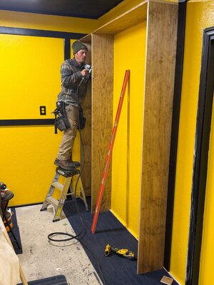

Is that a laser Max? Are you getting into the gasket making business too?
Mark
It is a laser. The wife and myself's Christmas gift to each other. I told her she could put it in the room. Will I ever cut gaskets with it? I likely will but not anytime soon. I don't have time to learn how to use it currently lol!

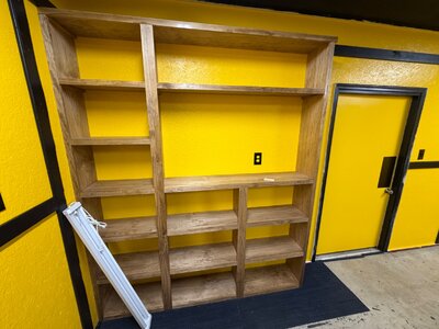

Hey Max, are you sure you got the right colour yellow? ;)
My tenure in NOS parts has proven one thing (among others). That when it comes to McCulloch yellow there is no "right color". The shade of yellow changed from year to year on NOS parts I have parts of the same part number that were sealed in OEM plastic bags and stored out of sunlight that are different variations of yellow. But to your question, it's close LOL.

I found 4 different kits, 300781 and 322709 are for the PM 10 Series saws with the H/L needles coming all the way to the side of the air box,
K10-SDC does not have the H/L needles, and the un-numbered NOS McCulloch kit has short H/L needles but I cannot confirm that they fit the SDC20.
The McCulloch Carburetor Guide calls out 84189 (H) and 68105 (L) for the needles in the SDC20. I do have 68105 but I do not have 84189.
A few other "big bore" SDC carburetors call out 68104 for the H needle, which I do have. I am not sure what the differences may be.,
