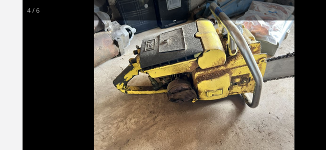

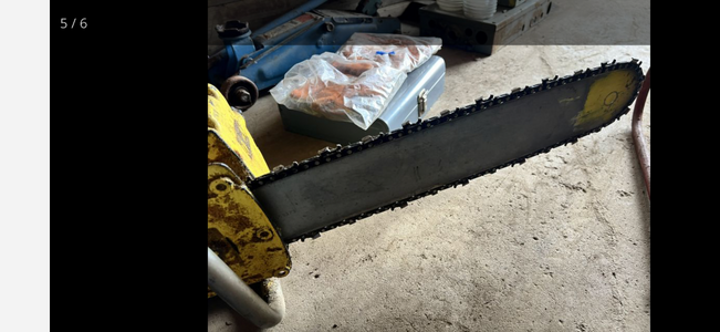

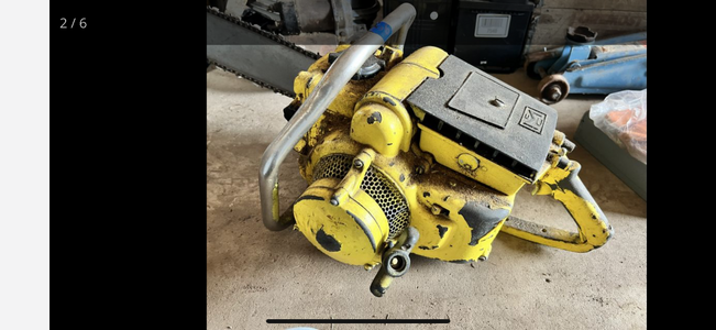

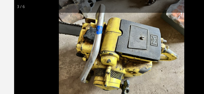

On a local auction, what model is it because no pics of bottom. 1-50 series? I think I have a problem haha 😂

If it is original it is a 1-50, they were the only ones with that starter housing left over from the D-30/36 and the full wrap bar.
Mark
That’s what I was guessing after some more research, so are they worth buying? I’m assuming it’s 80 cc still like a 1-40 of the same era but maybe actually had full bearings and a third port induction vs the bushed 2 port 1-40. I’m assuming this will make it have a fair bit better power?

I'm not sure if the 1-50 had the third exhaust port opened up or not...some of the 80cc models only had 2 of the 3 opened, maybe they are all that way I just don't remember. The 87cc models had all 3 ports opened.

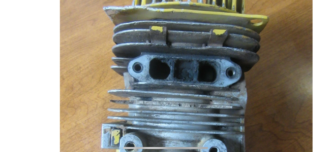

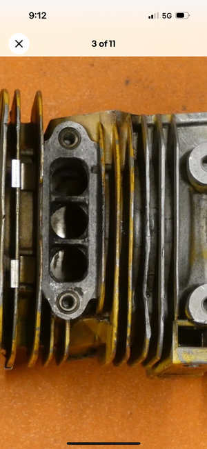

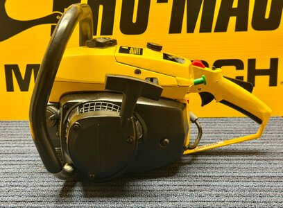

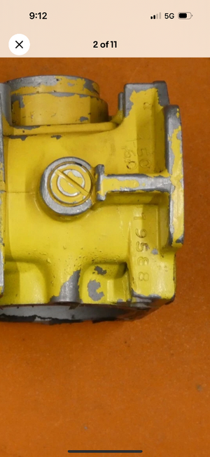

Well if I get it maybe I’ll have to look, don’t need to had one on eBay for sale and this is what it looks like.

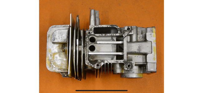

In my mind's eye I thought I remembered only 2 or 3 exhausts ports opened, but looking at a few blocks in the attic I see it is the intake on a few. May be the MAC15 only had 2 exhaust ports opened...?

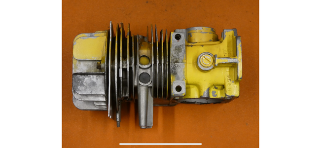

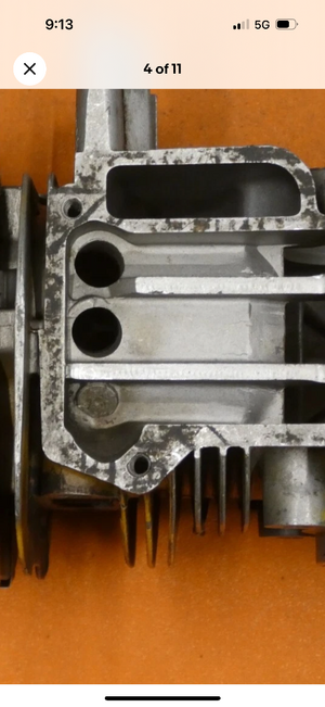

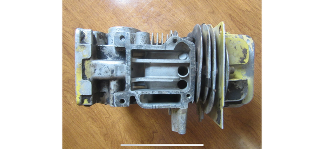

McCulloch 1-40 looks like 2 intake and 2 exhaust so probably be less than a 1-50.

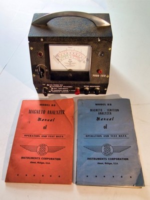

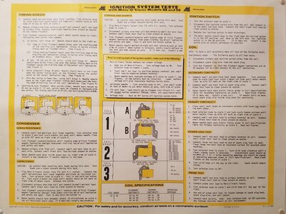

Just received a goody in the mail today, a wall chart from McCulloch circa 1977 on all the testing methods and specifications for the use of a Merc-O-tronic 88 and 98 ignition testers on point type ignitions. This not only broadens the field of use, it also simplifies into four groups by model. No part number is needed to test now, the point type anyways. Also does condenser testing as well.
Modulated coils have to be tested on a different tester so as not to fry the module. Those I'm still down to listings by part number to be tested.

I am faced with overwhelming opportunities...

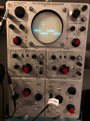

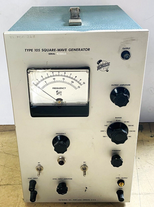

If I had the funds available, I might have gotten it. I really like older test equipment. Years ago, I bought a Tektronix 555 o-scope with several interchangeable modules. I even bought a Tektronix square wave generator so I could calibrate it. Tube equipment is fun to work with!
