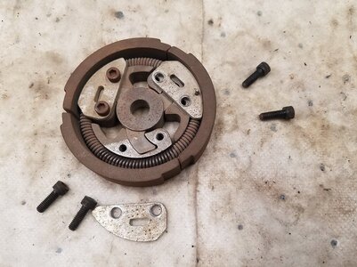

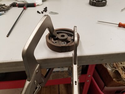

Large 3 shoe clutches yesterday...I came up with 6 different part numbers, 3 for the SP80 and 3 for the SP125. The differences include the hub of the rotor; the one on the large saws is wider and with a larger tapered bore, and the width of the shoes. There were both small bore (SP80) and large bore (SP125) clutches with rotors that are .525" wide and .655" wide.
SP80 PN's include 85364, 86464, and 88819
SP125 PN's include 86110, 86466, and 88820
Since I had a few of the smaller bore clutches with the wider shoes, I decided to swap the larger hubs in and supplement my supply of the large bore wider shoe clutches. I also changed out the springs on 3 or 4 used clutches to make them serviceable again.
Some of the retainer plates have a small pin (shown below about 2:00) that evidently was intended to help hold the springs down. Some IPL's show one with the pin, some have all three with the pin, and some three plain retainer plates with no pins at all...
Getting them back together was not too bad with the assistance of from "C" clamp type locking pliers. You can see the wider hub on the clutch below, compared to the SP80 type hub shown above.

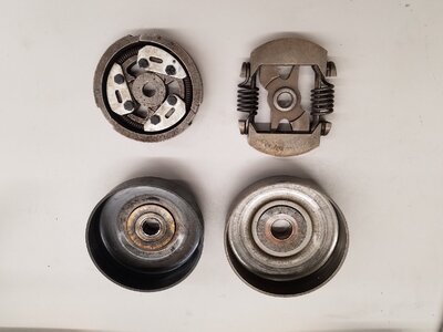

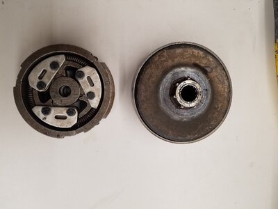

Since the 3 shoe clutch has a smaller diameter than the two shoe clutches use on the rest of the 10 Series (and 600 Series) saws, there were unique clutch drums that only work on the SP80 saws with the 3 shoe clutch and 1/2" diameter crankshaft.
The 3 shoe drum will actually fit inside the more conventional 10/600 Series clutch drum.

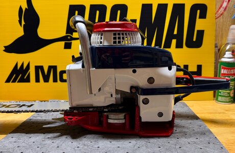

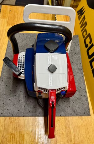

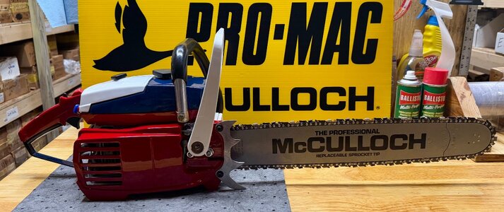

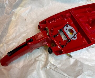

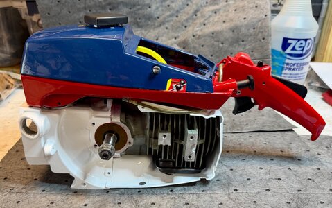

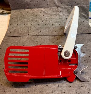

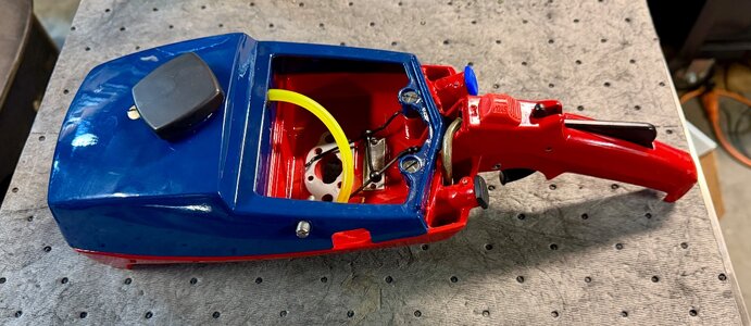

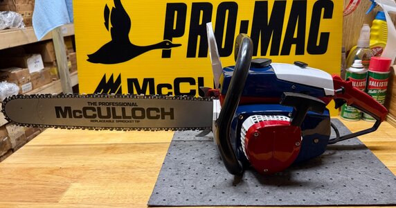

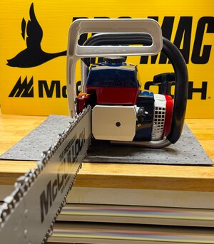

She's done, what do ya'll think?...
She's a beauty!! Not sure if that saw has a nameplate sticker that goes on the air filter cover (like the 10-10s), but if you could get one made up with the print on a wavy American Flag...that would be awesome too!
