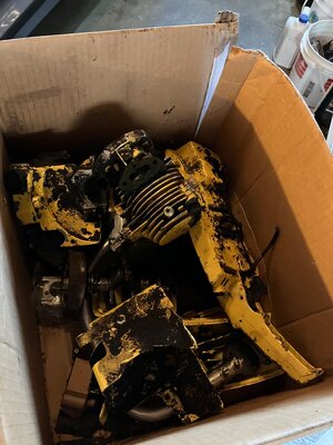

This is the saw I asked you about a few weeks back.
So going by that, I'm missing the spring and also the eyelets?
Also see the little round plug that came out of the oil tank, is this a stray part?
I presume you can make the spring out of some steel sheet?
Cheers.
I have had the spring plates remanufactured. I have the eyelets also. If you need them just shoot me a message.

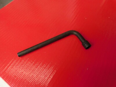

McCulloch 85583 "L" shaped spline wrench
Got one plus the socket ,E-bay a long time ago from a person in I think Las Vegas who must have cornered the market with NOS when McCulloch circled the drain .Evidently she didn't keep good records and said I never paid for it .Could have been an error or just a scam .I however keep good records and sent her the stub of the US Postal money order and proof it had been cashed in . BTW this was long before pay pal .
I've kept that method of payments on anything I find on the forums .You might be dealing with a scam artist you have never met a thousand miles away .Recently as a matter of fact a scammer near Pittsburgh tried to get to get me again .I had to inform him what postal fraud is and what the results could be .I got my money order back but not the saw .Fact at saw fest I met the guy who bought it and it was a piece of junk .

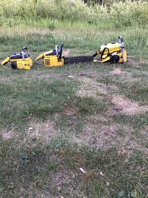

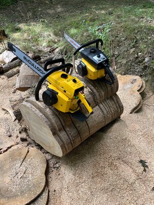

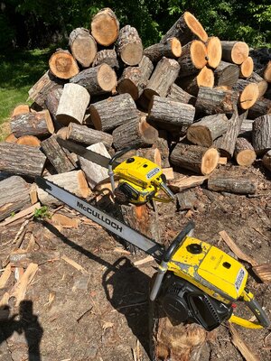

The 6-10 has low compression, the 55 loads up and floods and the 797 leaks at the block to gas tank. Getting busy and will have to put up out of the way and get back to them another day. image.jpgBeautiful day for picture.

The 6-10 has low compression, the 55 loads up and floods and the 797 leaks at the block to gas tank. Getting busy and will have to put up out of the way and get back to them another day. View attachment 463515Beautiful day for picture.
Unless I'm mistaken that saw to the left looks some what like a 6-10 except from my view point it's left hand start .Unless the parts got changed or the rope is missing 1751542851225.png

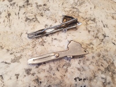

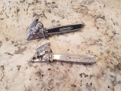

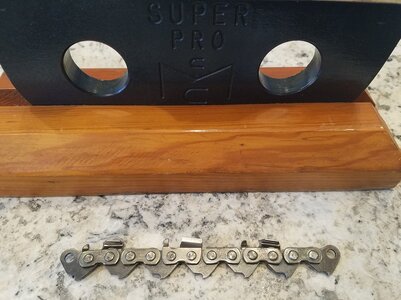

Bling - Thanks to AWise_mac_nut for bringing this to my attention.
I had a piece of .404 chisel with the McCulloch "Mountain" logo on it but if anyone has a small section of square ground chisel with the cMc logo I would love to add a piece to this display.

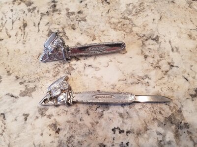

While I was on eBay I also found this pocket knife/letter opener. My wife gave me the tie tack on Father's Day.
If you still had a piece like the one in the photo, you can grind it square - this way from Super Pro Round (SPR) you get Super Pro Square (SPS).

I could manage the round to square for a few links, but I am not planning to make the effort on the new logo chain, I will see if I can come up with a section of the cMc logo stuff.
Mark
I might have a chunk of that Mark - will look after the holidays.

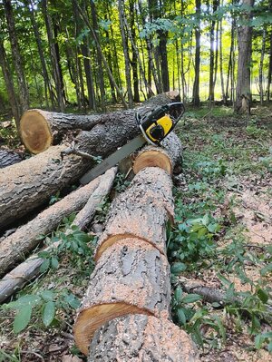

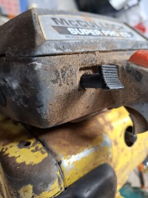

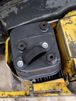

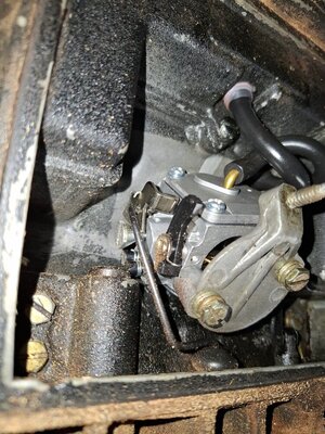

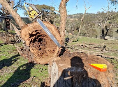

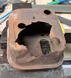

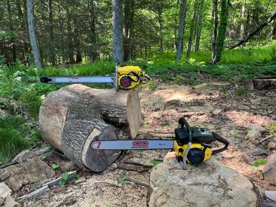

I've got the old SP 105 running now. Thanks to everyone's help, we got good spark, then I had to replace the clutch side crank seal and the rear AV mount which had no rubber at all. I replaced the intake manifold while I was there, even though the original was fine. I patched up the muffler which was completely rotted out - it's not easy to weld on this old thin metal, but I got it done.
I replaced the carb with an aftermarket adjustable one from a 390XP. The carb just needed the fuel nipple swapped from the original carb, the casting around the needles trimmed off and the choke tab turned 90° on the shaft. The shafts needed a tiny bit of tweaking, but it pretty much worked as is. I drilled a hole in the side of the airbox to get a screwdriver in to adjust it and plugged it with a rubber flange I found.
It was missing the manual oiler button, and I couldn't find any for sale, so I made some guesses and measurements and 3D printed one.
It fired up in 5 pulls on choke (didn't even need a prime!) and runs fantastic, even the automatic oiler works perfectly without any adjustment (a first for an Mac I've owned). I popped my 36" bar and .404 chain on it and went out to find some worthy wood. It'll idle all day and pulls like a train, they are such fun to run. Because it doesn't rev super high, it sort of feels slow, but it certainly isn't!
