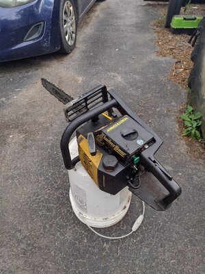

I picked up this Timberbear a little more than a yr.ago.It had some issues which I thought I'd straightened out,but I went to loan it out to my brother & it wouldn't start.I left it set all this time until a few days ago.The switch was bad,it was missing a thrust washer in the clutch drum,& it had a clang in it when I pulled it over.Originally I replaced the recoil & fan housing to get it operational last yr.I got it running again a couple of days ago.I did a compression test & it has 165 psi.The saw ran,then quit & I went to pull it over again & the pulley wasn't catching on the pawls.Pulled it apart & found the flywheel was loose.I tightened it down & the saw fired right up again (I don't know how),but it had an air leak,so I decided it needed a new crank seal.I pulled the flywheel to find the woodruff key had sheared vertically (strange!).I replaced the seal & woodruff key & it fired right up.I had to re-adjust the carb because it was no longer sucking air.It runs & oils gret now.

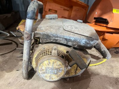

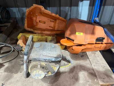

I finally managed to get my hands on an big mcculloch as I picked up this SP105 for less than $50 at an auction including the chainsaw cases behind it. I've been going through it, and it's easily the filthiest saw I've worked on so I've done a lot of cleaning. The saw is in pretty good shape under the grime other than a few minor missing parts and the piston and cylinder are perfect, but I can't get spark. I've changed the spark plug, cleaned and set the points, swapped the condenser to one from a Super 250 parts saw and I'm stumped. I occasionally get a small flicker when I spin it really fast with the drill, but nowhere near what it should be. I've got a multimeter, and the condenser seems to test fine, but I not sure what else I should test or look for? Does anyone have any pointers?
That is awesome to get that saw for $50!! Yes it is dirty, but should look good after a good cleaning! You probably already did this as part of your troubleshooting, but did you test with a new spark plug (or a known good one)? Gapped correctly? Are the ground wire ends clean and free of corrosion (on the saw too where it connects)?
Congrats on the saw!!

Thanks, yes, surprised that it didn't get more bids, but lucky me, I guess.
I have tried 3 different spark plugs, 2 brand new, with no difference. Everything is clean now, but still no spark. Looking around a bit I put the multimeter from ground to the point wire and got 1.1ohms - not sure if that's good, but it's something. I got nothing (open) from the spark plug to ground, and even tried taking out the wire but still got nothing from the screw inside to the ground. Maybe the coil is dead?
What are you setting your points gap to? Are you testing to see if the points are opening and closing with a meter, have had worn lobs on the crank that wouldn’t allow proper functioning at normal specs, a chip is needed in thouse circumstances. If the coil is open and your not getting a reading I would say it’s your problem! I have had a few bad coils. Double check you air gap on the coil to flywheel too.

The points should be set at 18 thou . On a points type ignition the trouble will be on the low voltage side,the points and condensor .If you burnish the contacts use a piece of lens tissue ,printer paper or something to make sure a little bit of sand or something is not holding off making good contact .It doesn't take much to screw them up .They have to close and make conductivity else the system will not work .Mac coils seldom fail .If in doubt stick it in the oven at the lowest temp possible for a couple of hours .
