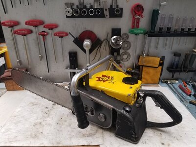

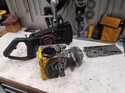

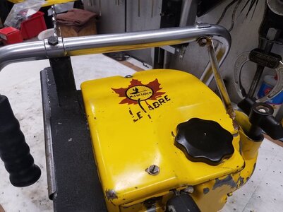

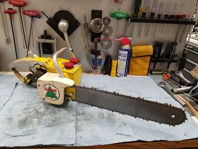

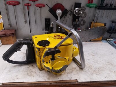

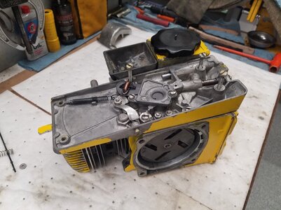

The pro Mac 55 I got was a dud, no idea how it even ran. Turned the 6-10 into a left hand start. Love having a chain break and a dog, switched out the carburetor The other smaller carburetor behaved so well, this one gets a little rich takes a few pulls to restart. But the fixed high screams smartly and it is larger. I do have a question, changed over the clutch and 6-10 has keyed clutch and 55 did not. Will it back off. The threads were right to tighten. I put on bar/chain and ran it.

If the tapers were clean, dry, and fit well and the clutch nut properly torqued (book says 160-170 In/#) it should be O.K. Since you put the clutch from the PM55 (no keyway) on the 6-10 (keyed crankshaft) you may be able to up the torque a bit. Never go overboard when tightening the clutch on a RH start saw with the keyway in the spider, they will break very easily.
Mark

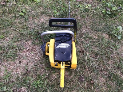

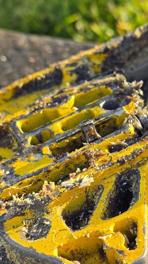

Did McCulloch intentionally make a really short chain adjuster on the 10 series just to piss everyone off?
Added 1/4" with mig welder and its a game changer.
Should be under warranty 🙃
Mark
When removing 6-10 clutch I may have done just that or it was already cracked and just showed itself upon loosening. The metal was so brittle. Ran it today and cut for about ten minutes and all was well. I am leaning towards already cracked as the performance is everything I could want with the 55 clutch installed. Mark I placed that copper patch on the wrap handle and it will work out fine. I have zink plated machine screws in place but will change out to something softer in case I throw a chain.
