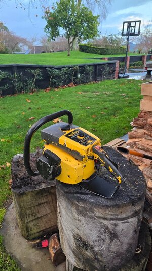

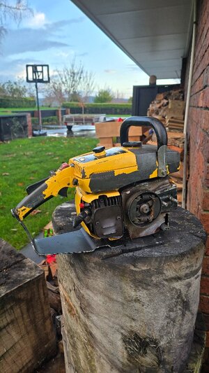

Picked up a 850 at $180 US looking worse for wear.
Rubbers are worn and smokes like a train but has great compression and seems to oil.
Maybe im a sucker :rolleyes:
Shoot, that one doesn't look too bad at all. Looks like it needs a little TLC, but otherwise it appears to be in great shape!!

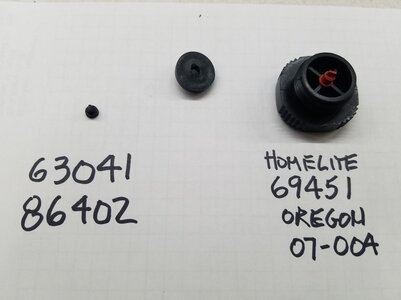

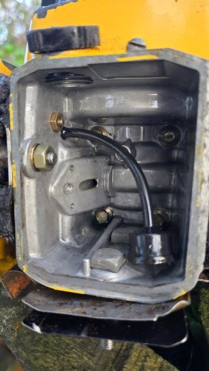

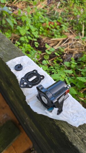

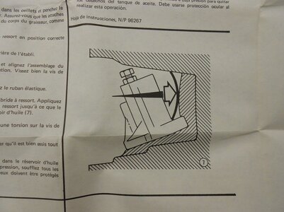

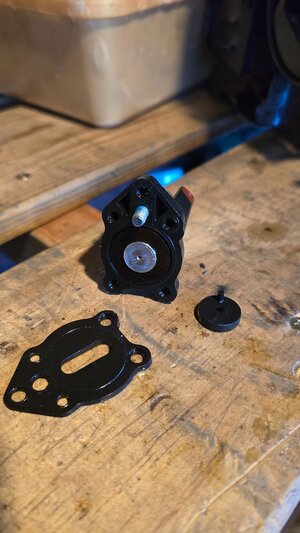

Howdy Mark.
This is the saw I asked you about a few weeks back.
So going by that, I'm missing the spring and also the eyelets?
Also see the little round plug that came out of the oil tank, is this a stray part?
I presume you can make the spring out of some steel sheet?
Cheers.

The round plug that was rattling around loose came out of the oil cap.
Seems you have answered the rest of the questions.
Knightmax has invested and has the eyelets and spring clip kits, hopefully your 92818 seal is still in good condition.
I have a few of the full 215246 kits with the 92818 seal, eyelets, and spring clip.
Mark
