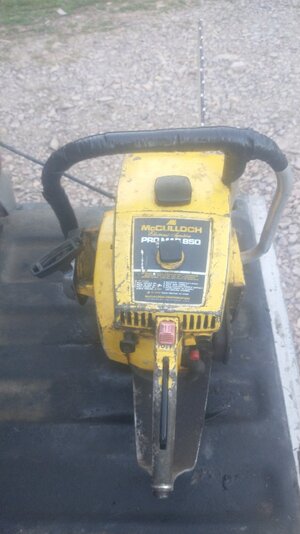

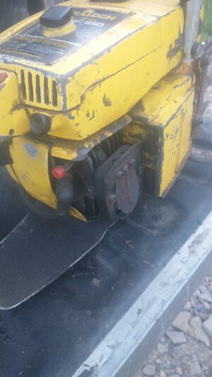

1st time McCulloch owner, Pro Mac 850, couldn't believe it fueled it and it fired off easily and runs good.
Is it missing a muffler cover of some sort?

You are starting with one of the best saws McCulloch made. Muffler is correct as it it, but may be missing the reed (item 68) under that guard you can see. I have some reeds if yours is broken and you'd like to replace it.
Also, someone had cut off the back half of the clutch cover/brake assembly.

I knew something didn't look right, and now you mentioned it, I can see where the clutch cover has been cut, I do appreciate the info.
Will not affect operation at all. Just not 100% correct. Use a good oil mix at 32:1 in the saw. They are chrome bore, the cylinders and pistons are ultra rare and basically non exsitant anymore. So 32:1 is important for the longevity of the saw.

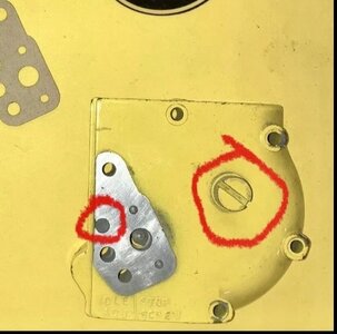

Brian
The the #18199 has the vent in the cover.
The #24945 does not but on the rare occasion there is a #18199 that does not as I've had to exchange a few for a couple of customers. There was also one occasion where a a #24945 had one, according to a customer, I can't confirm that just did an exchange.
Jeff

Brian
Jeff
So much for consolidation of versions Eh? :)
