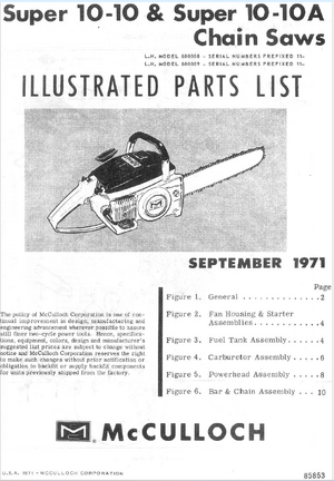

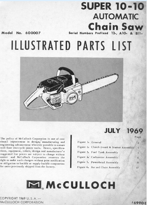

The serial numbers are only helpful, not definitive. You need to find an IPL with the prefix listed (10-, 11-, 12-, etc.) and from the date on the IPL you can establish a rough idea of when the saw was built. McCulloch did not (as far as I know) incorporate any sort of date codes into their serial numbers.
I think there were (at least) three different model numbers for the Super 10-10 saws, 600007, 600008, and 600009

Homelites are the same way, the only real help in figuring out approximately what date those saws are come from a ledger kept by a shop for close to 50 years with each type of saw, its serial number and date sold. For McCullochs, like Mark said, best guess is to look through the IPLs and find one that has the serial number range that corresponds to your saw. One of my 10-10 saws does not have its serial number tag, so my best guess is to fine the IPL that has the closest parts and assume the year manufactured from there. My other 10-10 has a serial number tab and if I remember correctly it is prefixed with a 12- and makes it a 10-10 from 1970 +/- 1 year.

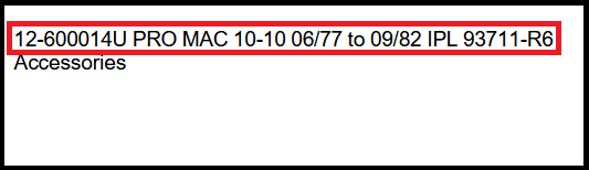

What I have is a Pro Mac model number 6000 14U.
Looking at the IPL manual range for the model 6000s there are 8 IPL iterations for the 14 series, 600014A, B, C, E, F, G K and U. Since this series covers the date range 06/77 through 09/82 then I would guess yours will be in the later end of that date series, figuring late 70s, early 80s depending on when they stopped manufacturing the "K" group and started in with the "U" group.

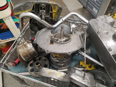

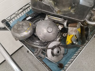

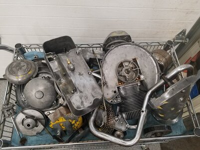

I have the 12-25 all cleaned up now, tomorrow I will begin putting the puzzle back together.
The saw came with an extra starter so I will assemble two and decide how to proceed from there.
I ended up taking the transmission (gear box) apart and will see about getting that back together as well, When I pulled the clutch drum the woodruff key came out down in the recesses and I could not devise a way to get it back where it belonged. I will have to be somewhat creative this time around.

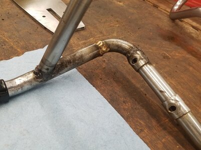

In the process of getting the other half of the handle bar cleaned up I discovered more welding/brazing repairs.
I have a 5-49 in pieces in the attic, I will look into that handle bar as a possibility for this project.

View attachment 461347S
Sweet! I'm gonna hold onto that if you don't mind.

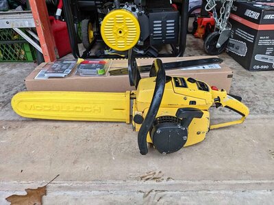

What's the going price for a 555 ?
This one is for sale near me and looks in good shape .I'm not really up on the McCulloch market .
Thanks
Ernie
There's a runner on Ebay that doesn't look as nice as this one. They're asking $225 + $48 shipping. Don't know how long it's been there. Also a parts saw for $60 + $26. I'm feeling $250 -$300.

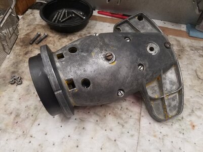

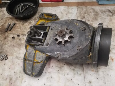

The transmission (gear box) is back together.
