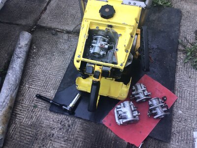

Question on the amount of gas this carburetor is transferring, seems excessive. Quickly floods itself out. When pulled over slow there is a large volume of gas coming out of muffler. We are under a fire ban so no turning over but when last night before ban that’s when I got the leaks out and it drew fuel like it’s thirsty but flooded itself out.

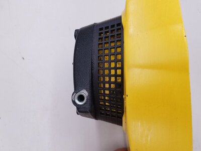

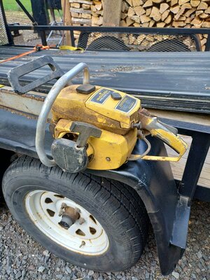

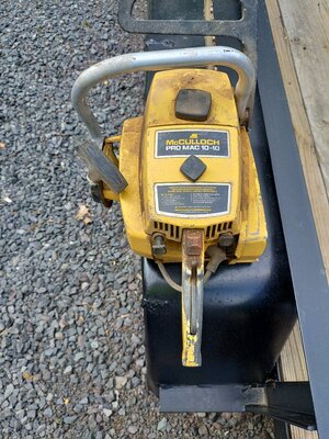

Picked up a 10-10 and I have a question...
Should this have a screen on inside of the recoil cover to keep anything from coming in contact with the flywheel?
I've seen some with it and without...so I have to ask here .
Thanks
Ernie

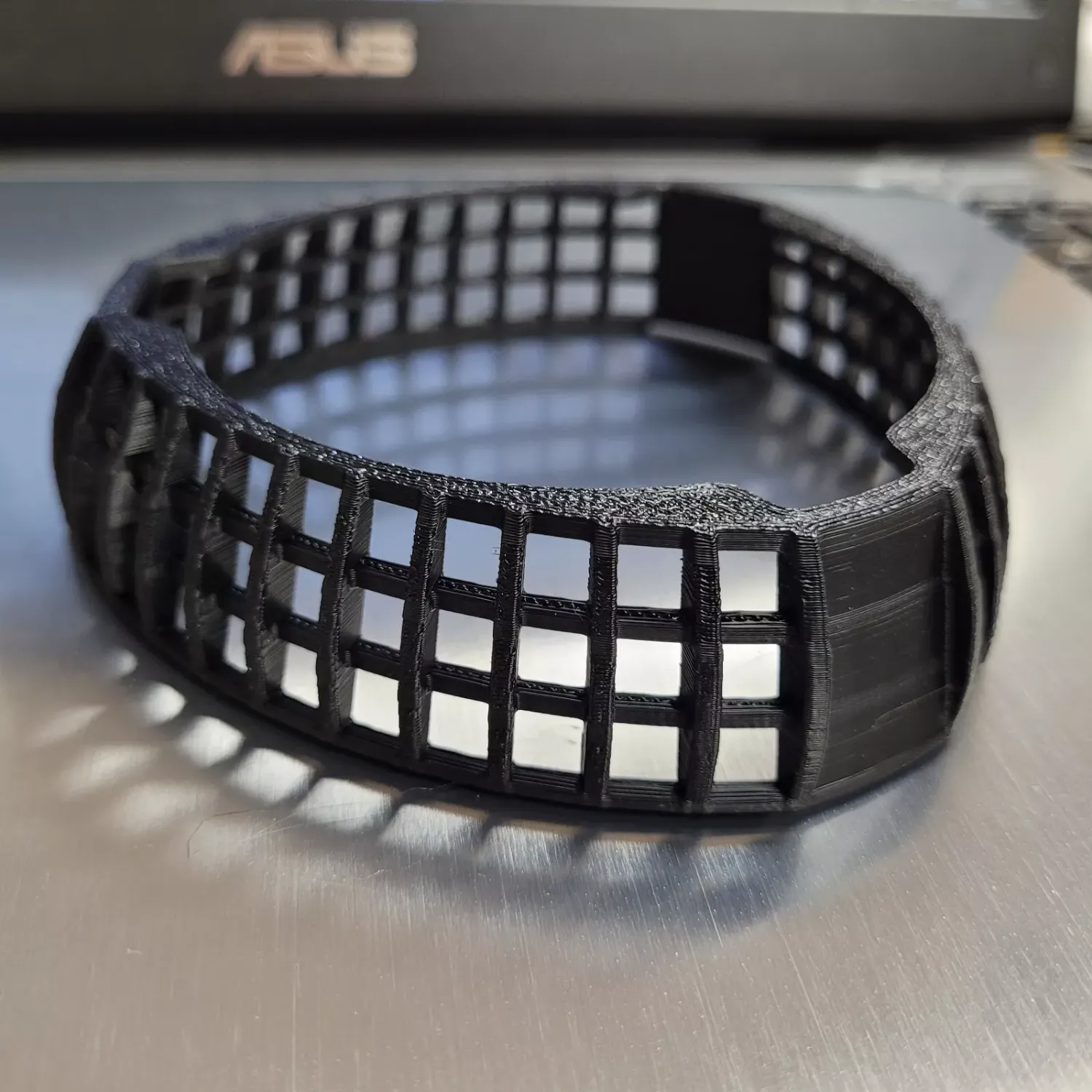

McCulloch PN is 87674. I have a few NOS as well as some 3D printed ones that I make (and sell) as well. The 3D printed ones are not exact duplicates but are as close as I can achieve with my machine. We tried several different shaped holes before coming up with this one. The ones out there with the triangular shaped holes are copies of one of our early designs.

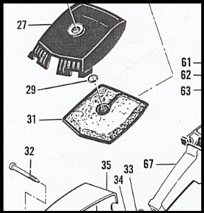

Can you switch parts on that accept the newer non dome low filter?
If you look through the 10-10 IPLs you may be able to narrow down the change over. I tried to fit a low filter on my saw and I don't believe it was even wide enough to cover at the base, you might be able to 3D print an adapter.
My 10-10s (non-Super) have the high filter:
1749001136594.png Part number 66774
The Super 10-10s look to have the low filter:
1749001301053.png Part number 69922
The later Pro Mac 10-10 (what ErnieG got) uses the same low filter:
1749001533091.png Part number 69922
The Pro Mac 10-10s looks to have a similar low filter, but different part number, possible same filter just newer part number:
1749001657892.png Part number 216685
If you get a 10-10 with the low filter, let me know, I have a new low filter I don't need.
It looks like (looking through the IPLs) all of the right-hand pull start 10-10 (1967-1970) have the high filter and the last two years of production (1971-1972) they swapped the pull start over to the left hand but continued to use the high filter. All of the Super 10-10, Pro Mac 10-10 and Pro Mac 10-10s all used the low filter.

I make some that flex and protect but don't break.

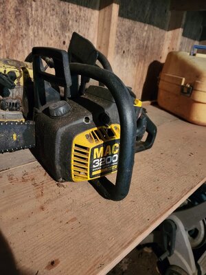

I have a 3200 here that is complete. Dont remember where it came from, but im POSITIVE i didnt give any actual money for it.
That series of saws was made by Jenn Feng if im remembering correctly. If im not, @heimannm will surely correct me. Made in Tiawan?
This one doesnt seem to have great compression either.
I THINK there is a 3214 in the barn at dads house.
I definitely understand wanting to save something for sentimental reasons. Its worth what you are willing to put into it, just understand that others may not be willing to pay that if you decide to sell it.
Feel free to PM me if you need any parts.
Would be yours for the cost of shipping.

The 32/35/38 cc mostly plastic saws were the last ones designed and built by McCulloch before they sold the name (Jenn Feng for North America, Husqvarna for Europe). Most of those saws were assembled in the McCulloch plant in Hermosillo, Mexico but I think some were actually assembled in the Tucson location. Jenn Feng did continue to produce some of those models as they implemented their own designs. You can see some similar concepts in the Jenn Feng saws.
FWIW - I sold a coil and clutch drum to a fellow last week for a 3200, when he stopped today to collect his just rebuilt MS362 he noted the 3200 was "a little screamer"...his words not mine...

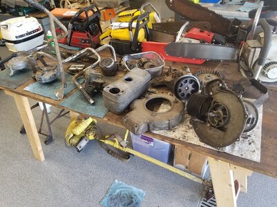

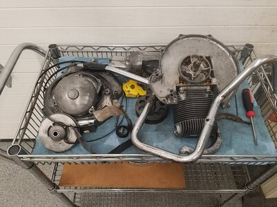

I decided to attack this 12-25 today. I wasn't quite sure what I would find under the grime, turns out there is no paint hiding anywhere.
I did witness this saw running a few years ago when Mitch Weber brought it to the Iowa spring GTG.
