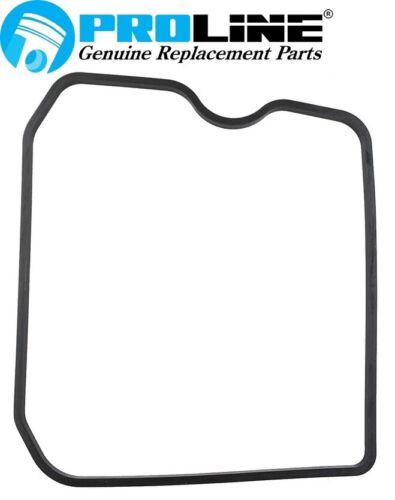

Over a year ago - this thread got me looking for my first Mcculloch to play with. From y’all’s suggestions I decided on a Pro Mac 60. It’s still waiting it’s turn…..which is crazy because it’s my favorite saw to look at here. It stays on display. I love this thing.
That tank in the background is a recent score for an awesome price. Hoping I can save the current tank - but even with JB weld or another epoxy, it might not be repairable. It’s really really bad. Thankfully nothing else on the saw has any rot.
The only other part I need to order is a tank gasket. Then I will dig in!
