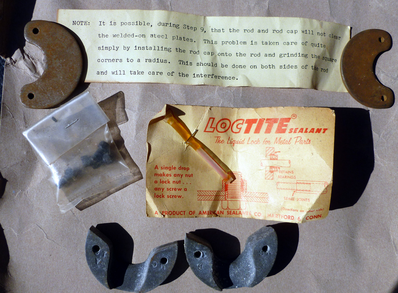

Neat stuff there JJ. If possible, I would like to have a copy of those instructions to add to my McKart book.
Mark
You got it Mark, plus I have some other literature that would be suitable for your collection.
Go power built a lot of stuff in the 60's .Fact I have a 580 West Bend in the shed with a go power tag on it but what it is I have no idea .
It might be a converted "five port" motor Al. Go-Power made a conversion kit for the West Bend 580 that turned it into hotrod of a motor.
