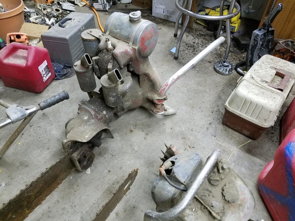

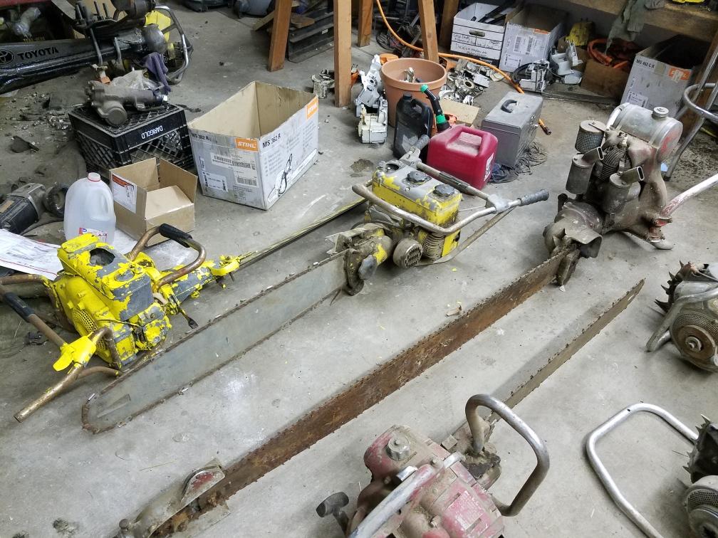

Speaking of old farts, I picked up a two man 12-25A that's just as old as you are just a few days ago. There's a lot on it that needs refurbed. Top of the tank has some good damage and the housing where the clutch sits in has a good crack and mag rot. Actually I also picked up an old Mall model 6 that's older than you are by a few years. It's in better shape than the 12-25, siezed up and dirty but complete. Might be able to make a runner out of it!
