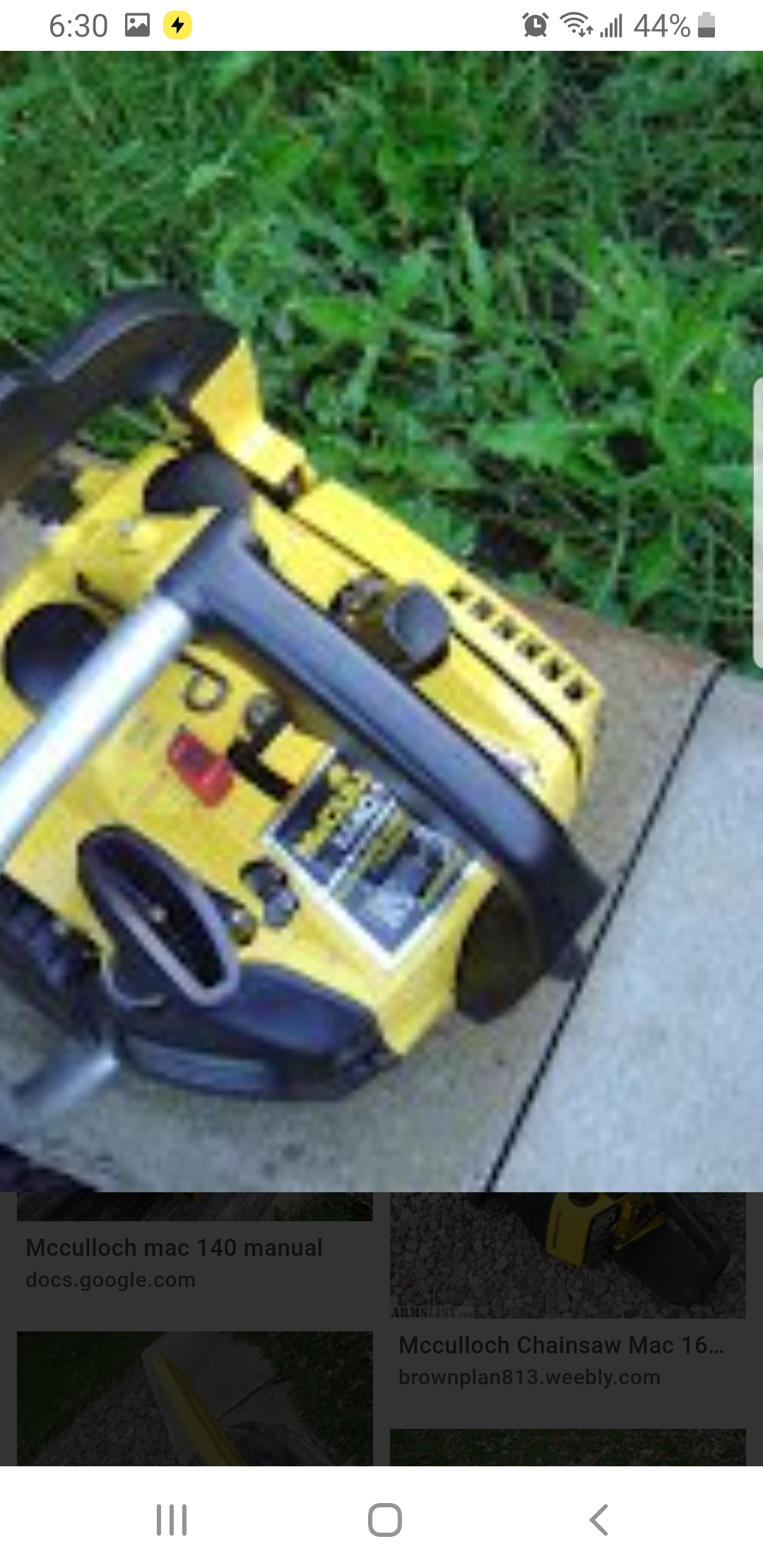

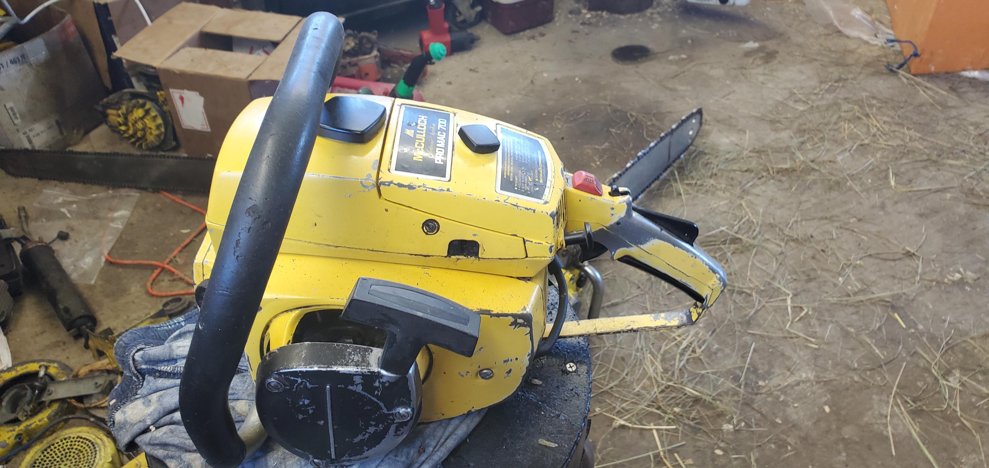

So what is the little black nob thing to the right of the top handle. I was thinking manual oiler but i see the wire manual oiler.
Not my saw just an pic off net.
I just got a bunch of mini mac parts and trying to peace one togeather and i think i through that part out. Gonna get my buddy to save it if he hasnt made the scrap run yet.

It looks like a Power Sharp sharpener. MAC called it Auto Sharp
Ok then that definatly wasnt for this saw what i tossed then. I will mabe just make a cover of some sort for it.

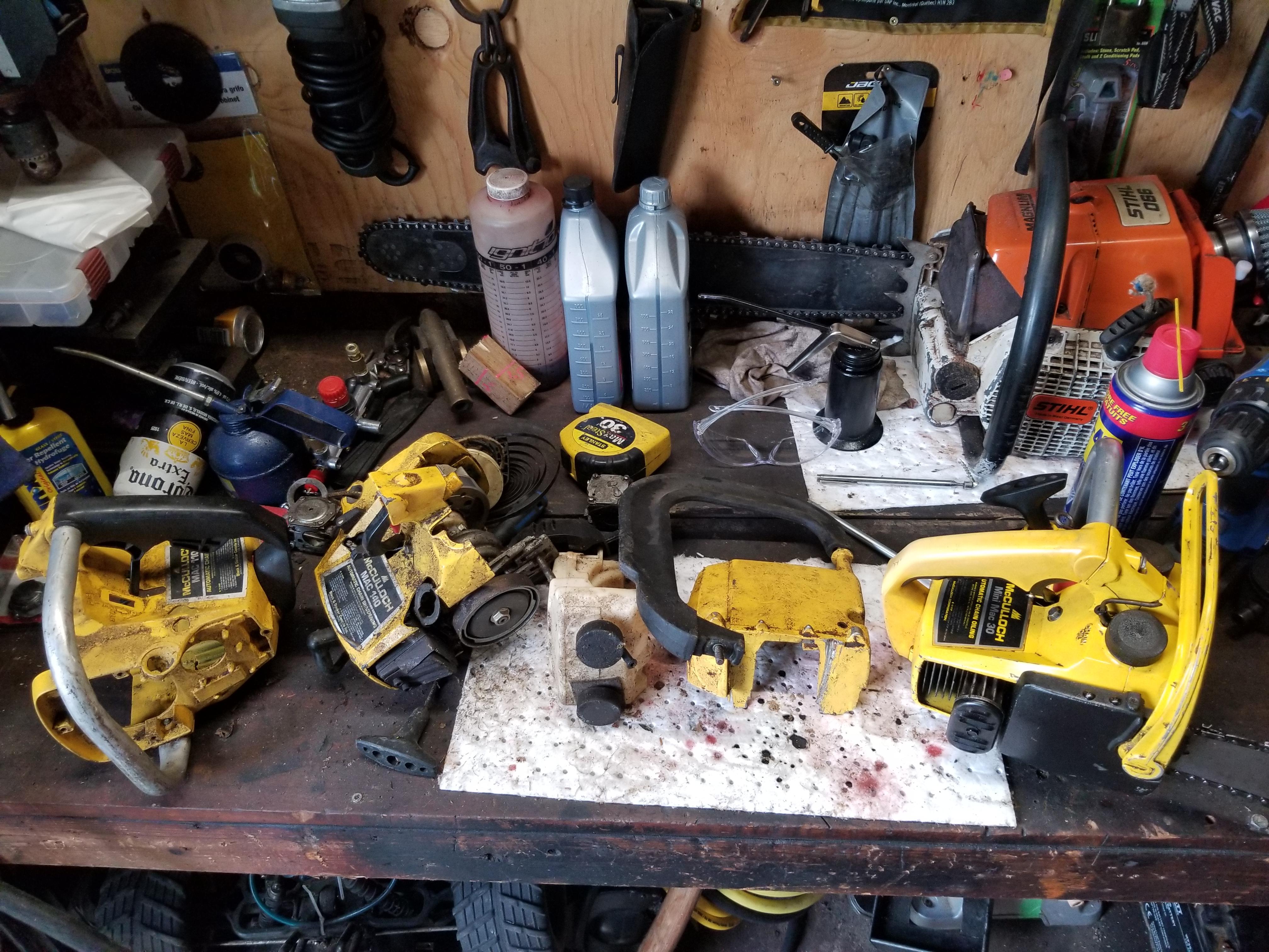

I must like these little minis when I have a carb kit on hand lol. And inordered another to have on hand to replace this kit lol.
Ther may even be enough parts to make 2 complete saws minus the bar and chains
Got way too many of those myself.
Got a 130 thats a nice runner and low use saw.
Theres more up in the rafters.
Some came from Ed King, but I think he got them from @Steve
Need anything, let me know.

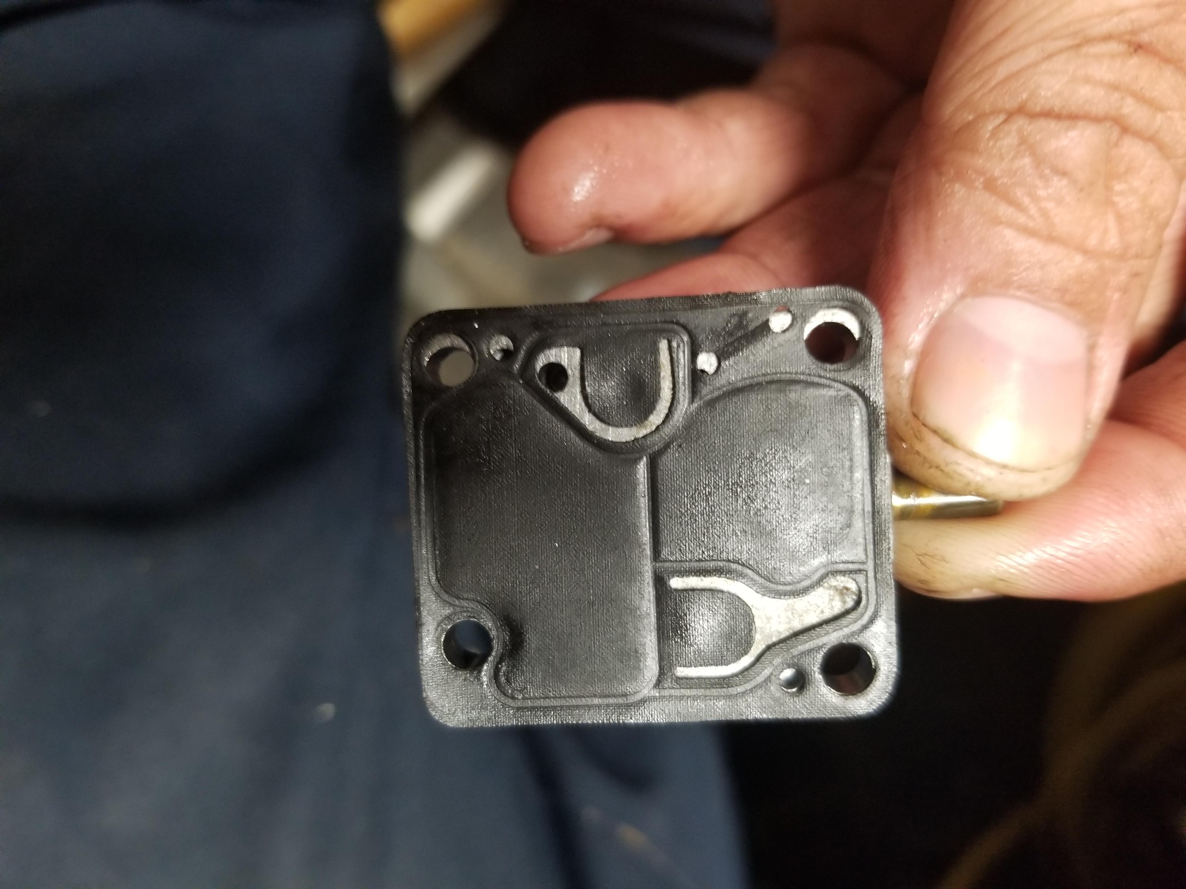

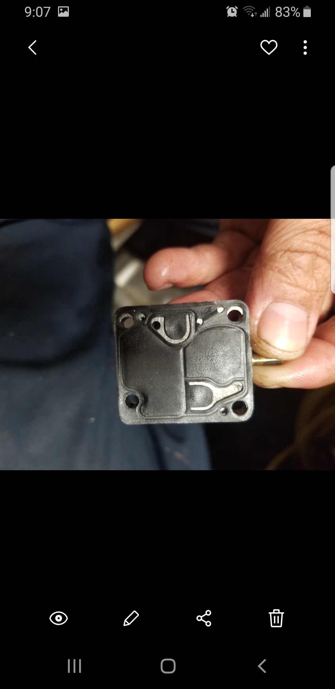

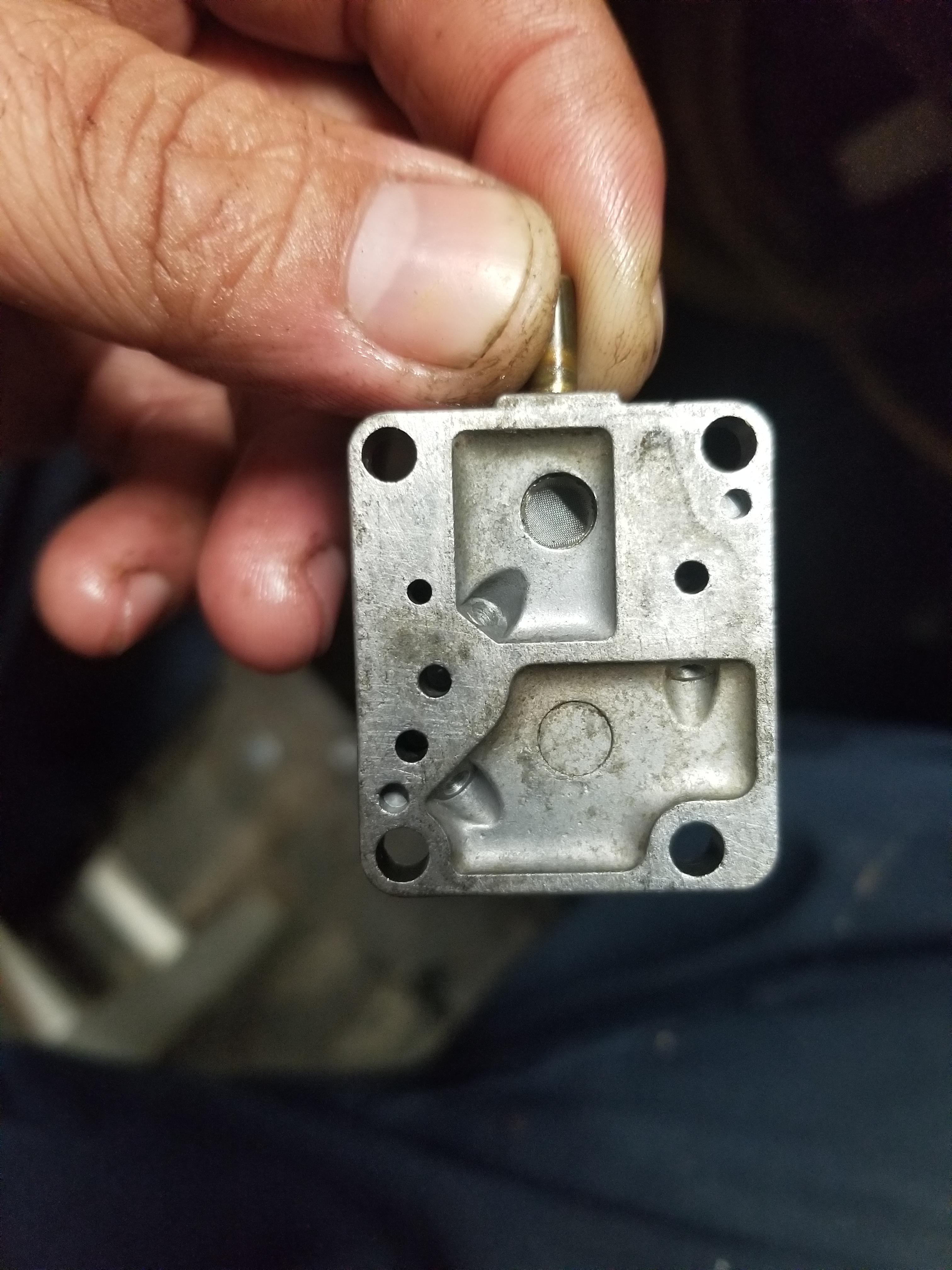

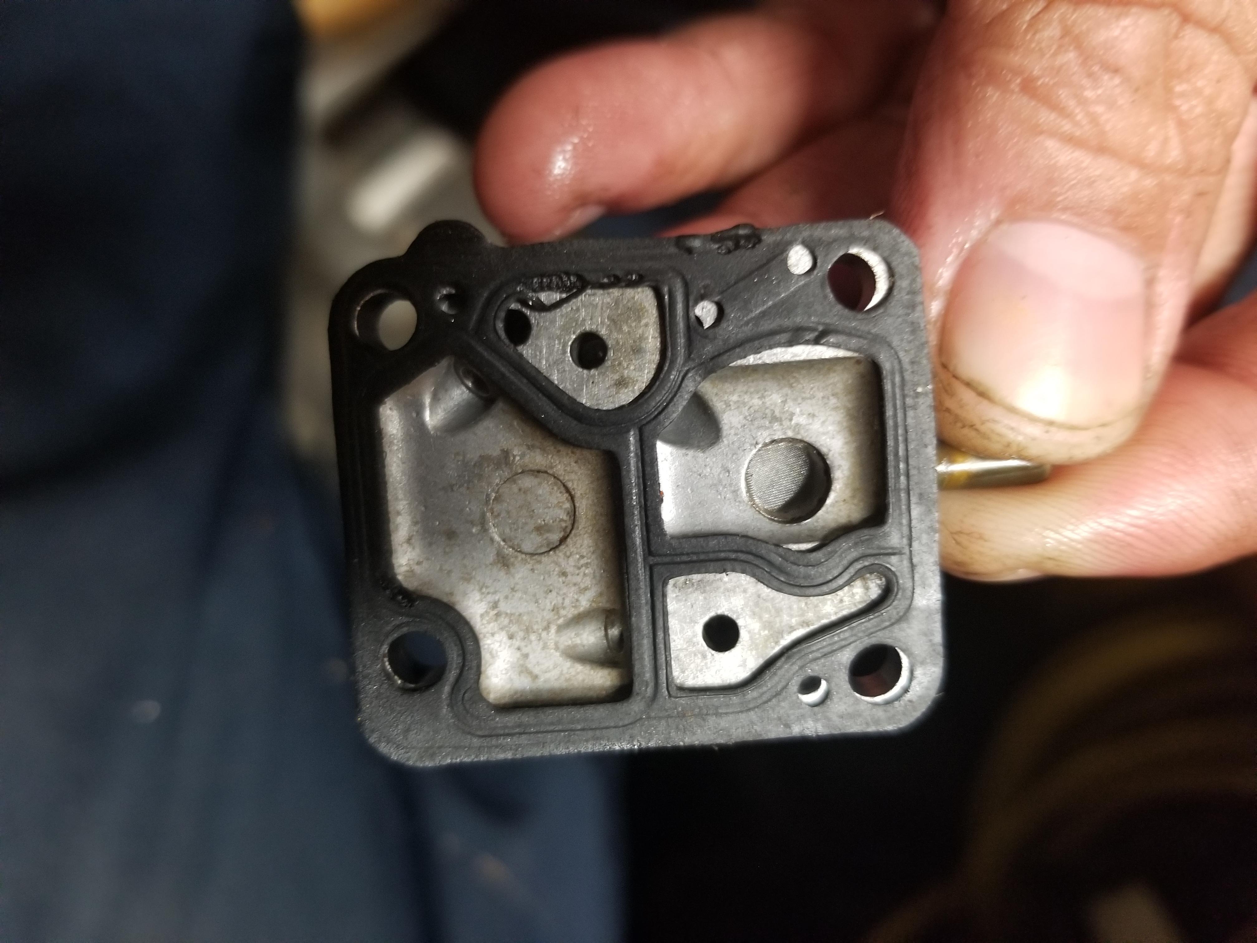

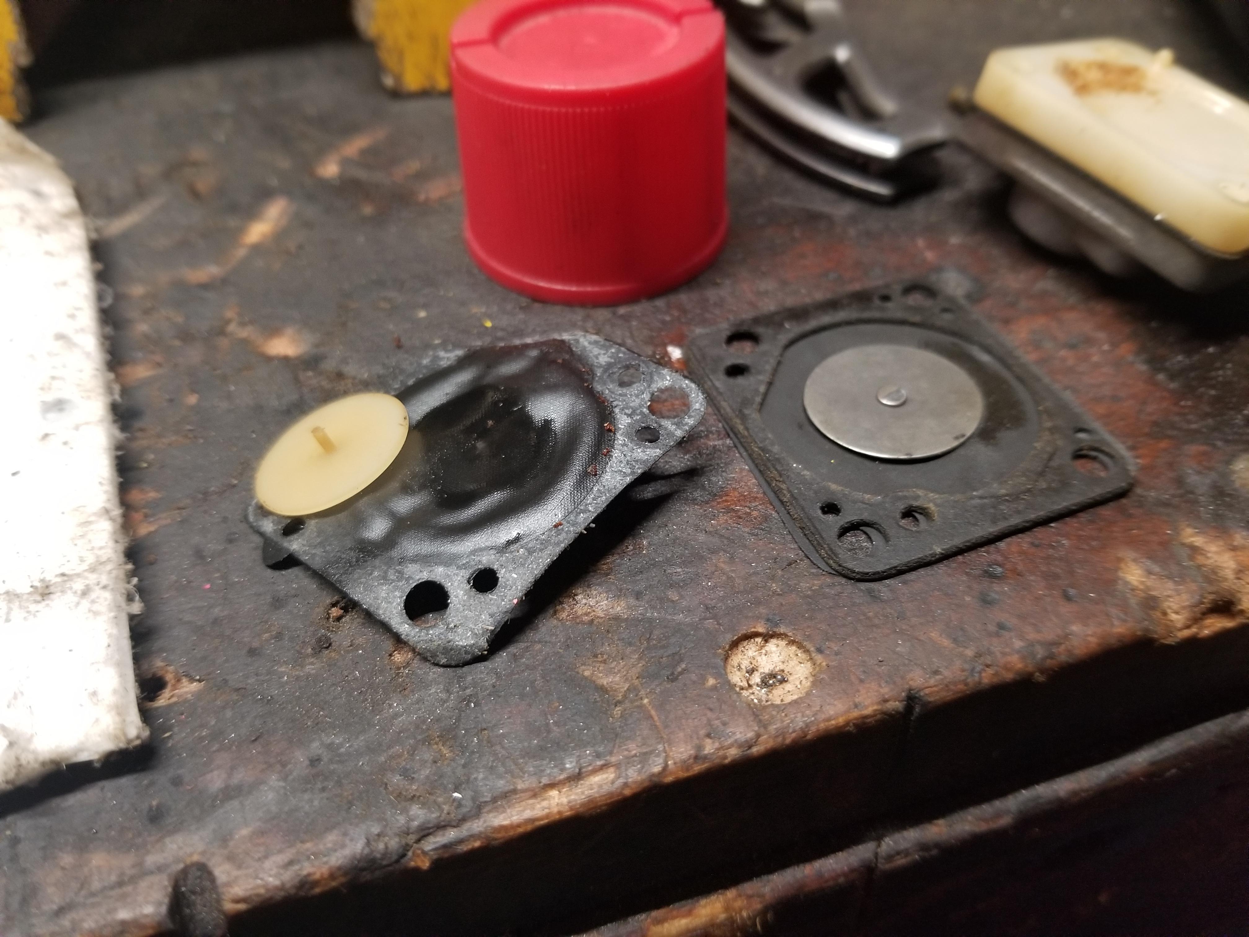

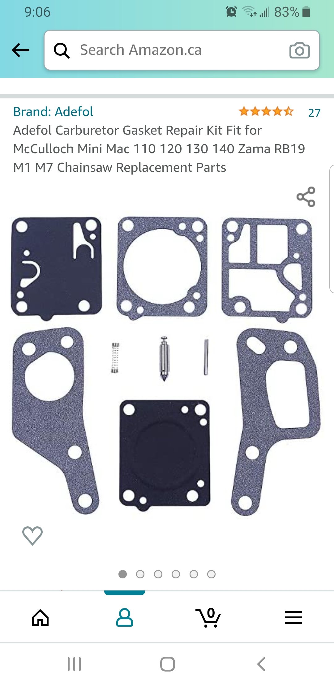

Well that was a bummer. I thought I had a new carb kit and it was the old one from befor, but it seems fine other than It looks off nothing seems to line up. These mini macs only use one style carb?
This one also had a differant looking diaphram with a plastic peace not attached instead of a metal peace.
Not the most knowledgeable, but I do know there are 2 carbs. Walbro MDC and Zama(iforget the series).
Got a brand new Zama kit here. Only one saw I have takes it.
Rest are Walbros.

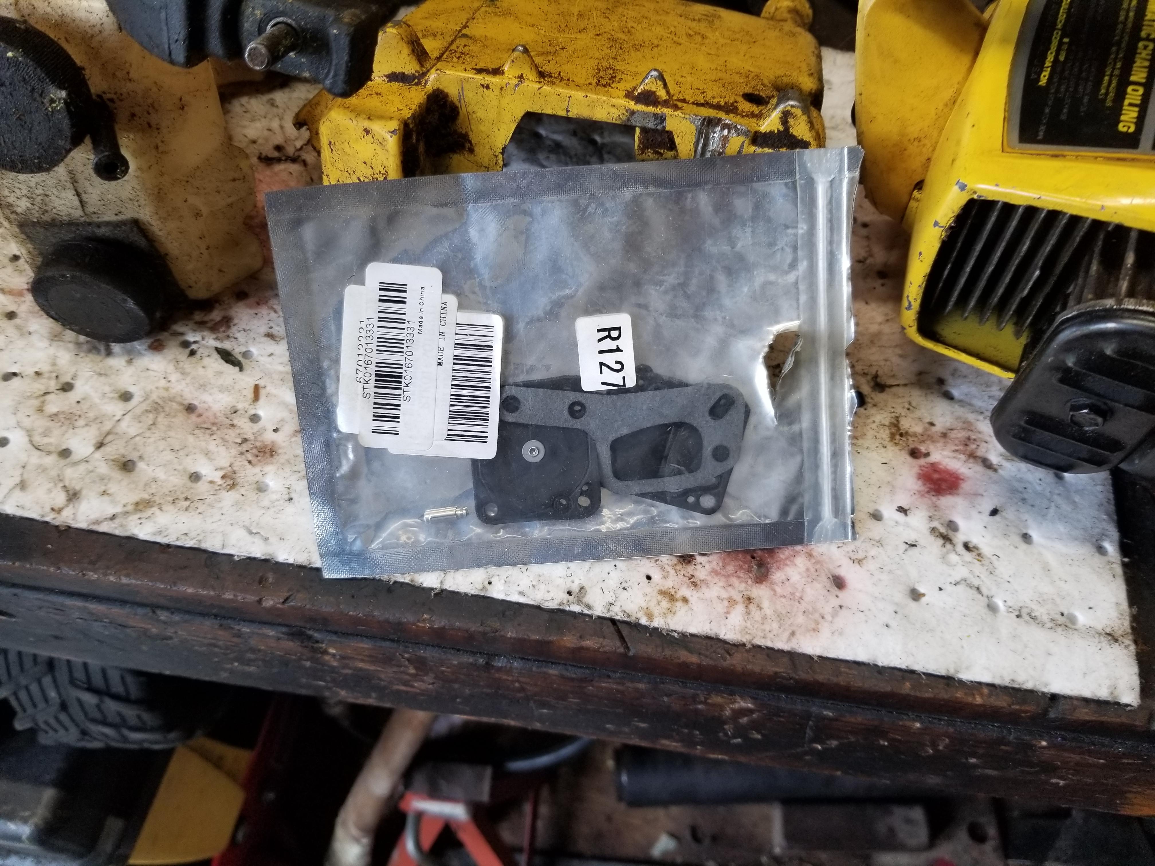

Here is the kit i ordered the other day. Ther is some diferances. Learn something everyday.

That appears to be a Zama kit in a Walbro carburetor or vice versa. The Zama has the plastic, non-attached disc and the Walbro has the riveted disc. The parts are so close you don't know they won't interchange until you try to assemble them in the wrong carburetor. I have also been there and done that.

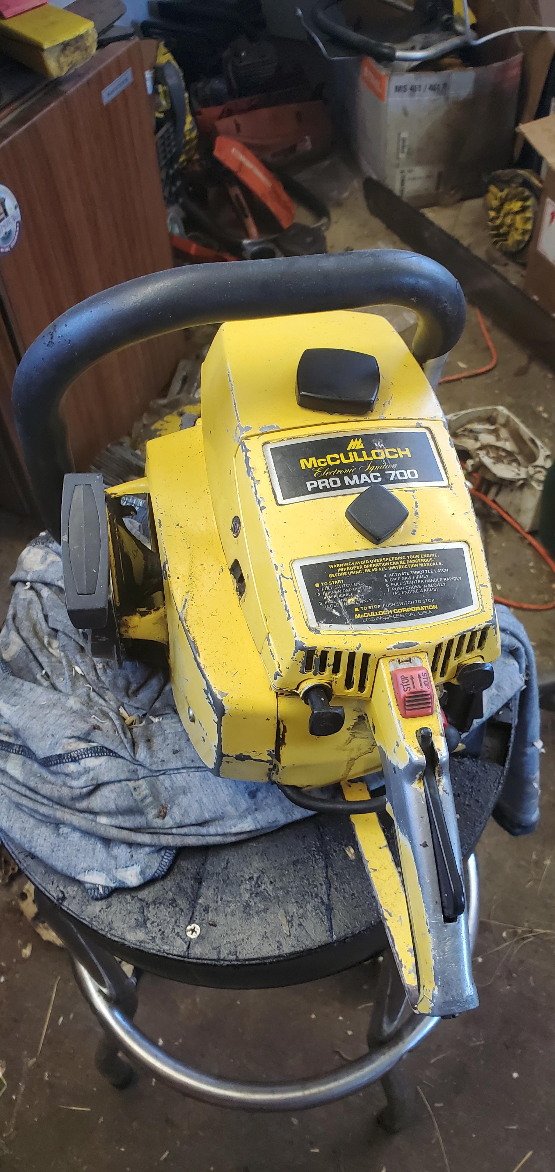

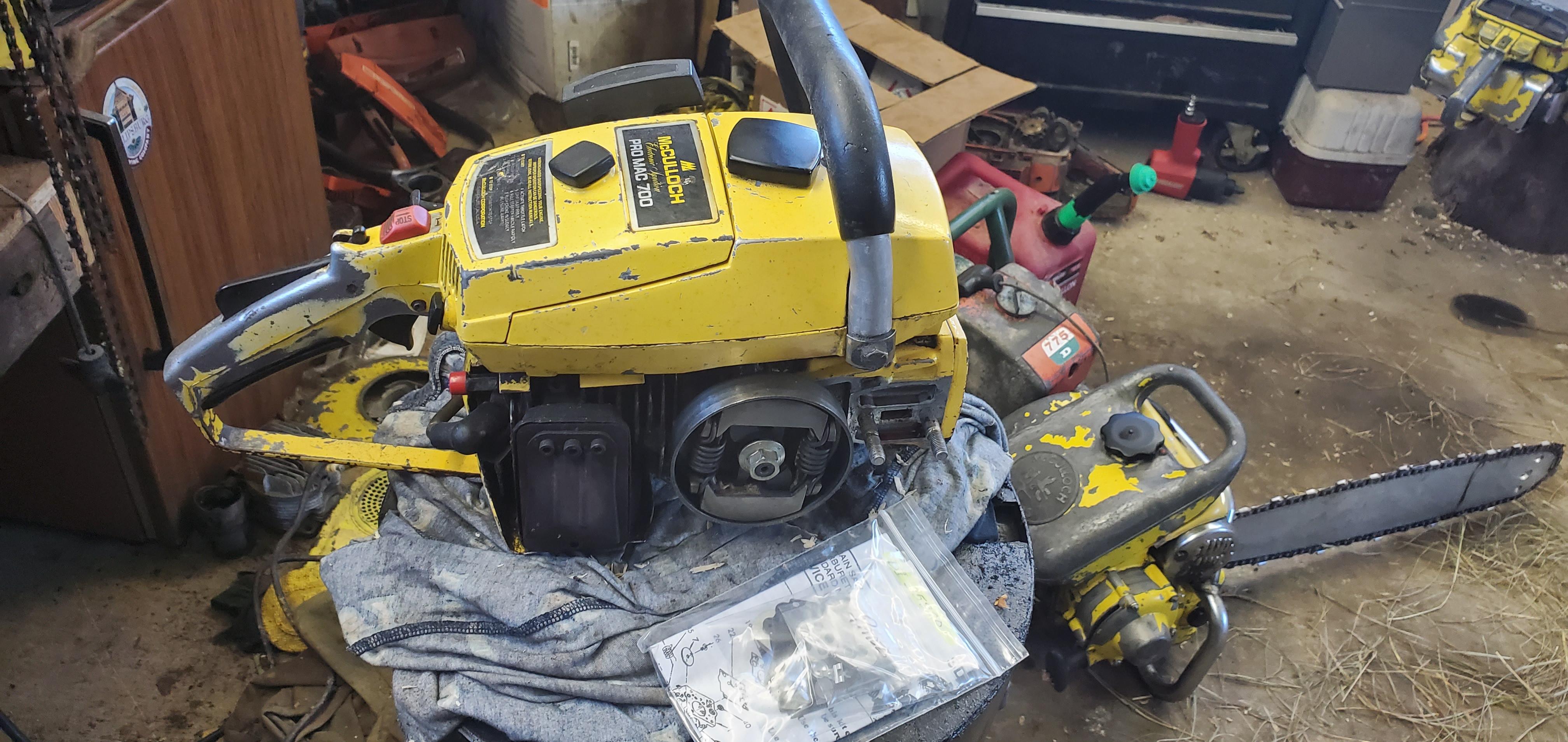

In McCulloch related stuff, I have a complete PM700 project saw that I'm going to get rid of if anyone is interested. It was one that I had intended to fix up and put a full wrap on but life situations dictate I sell it. I have a new carb/gasket kit for it as well.
