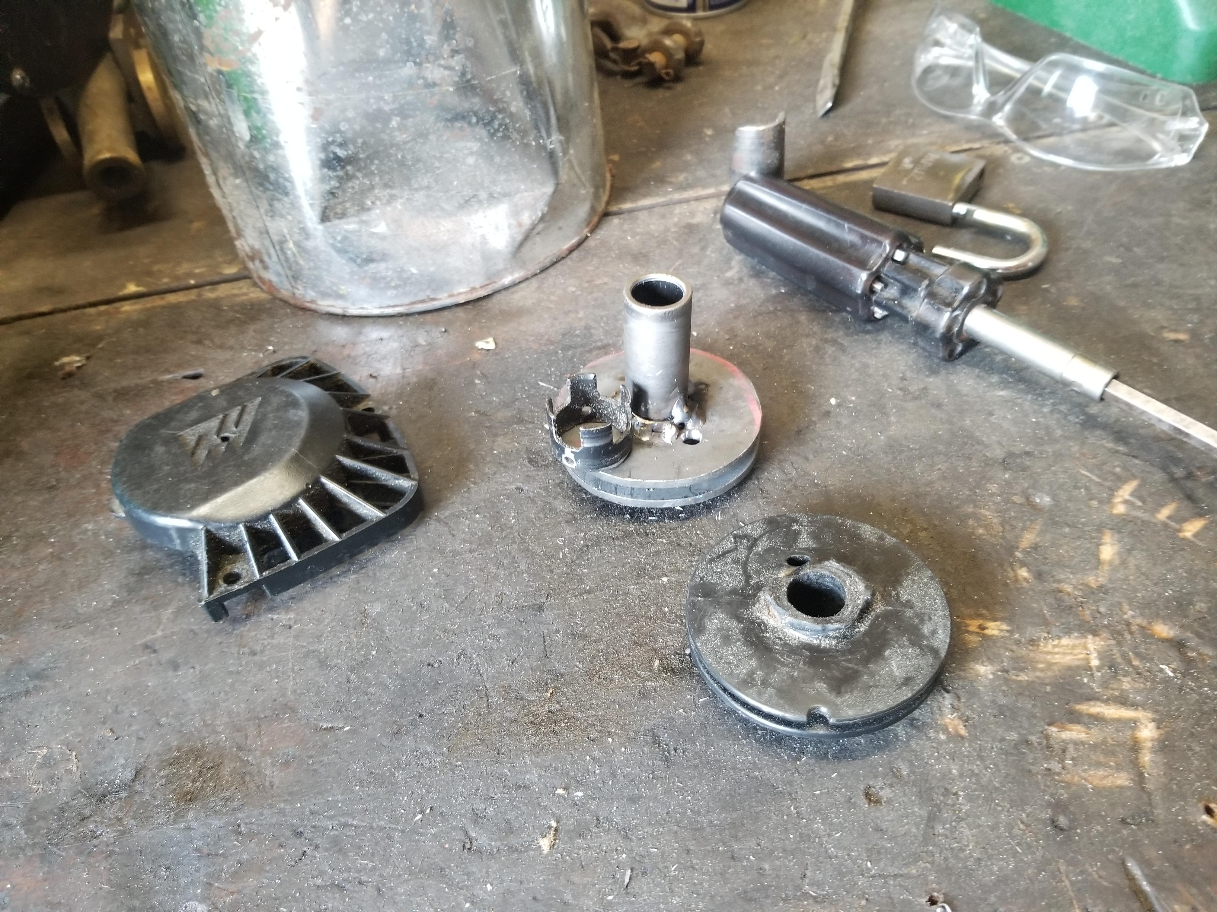

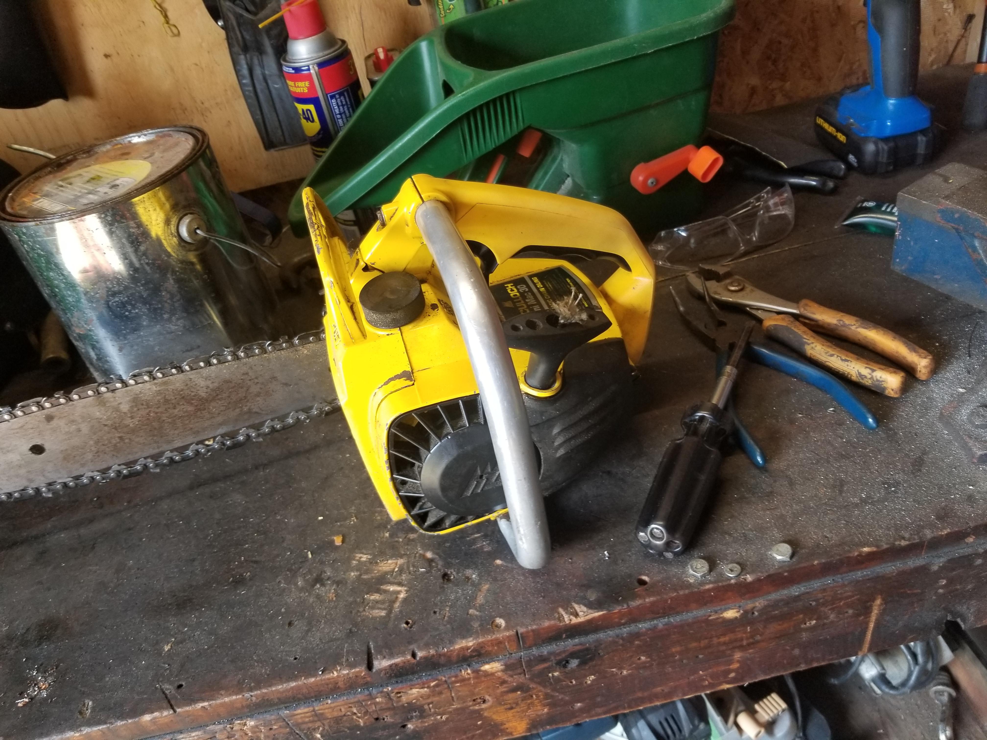

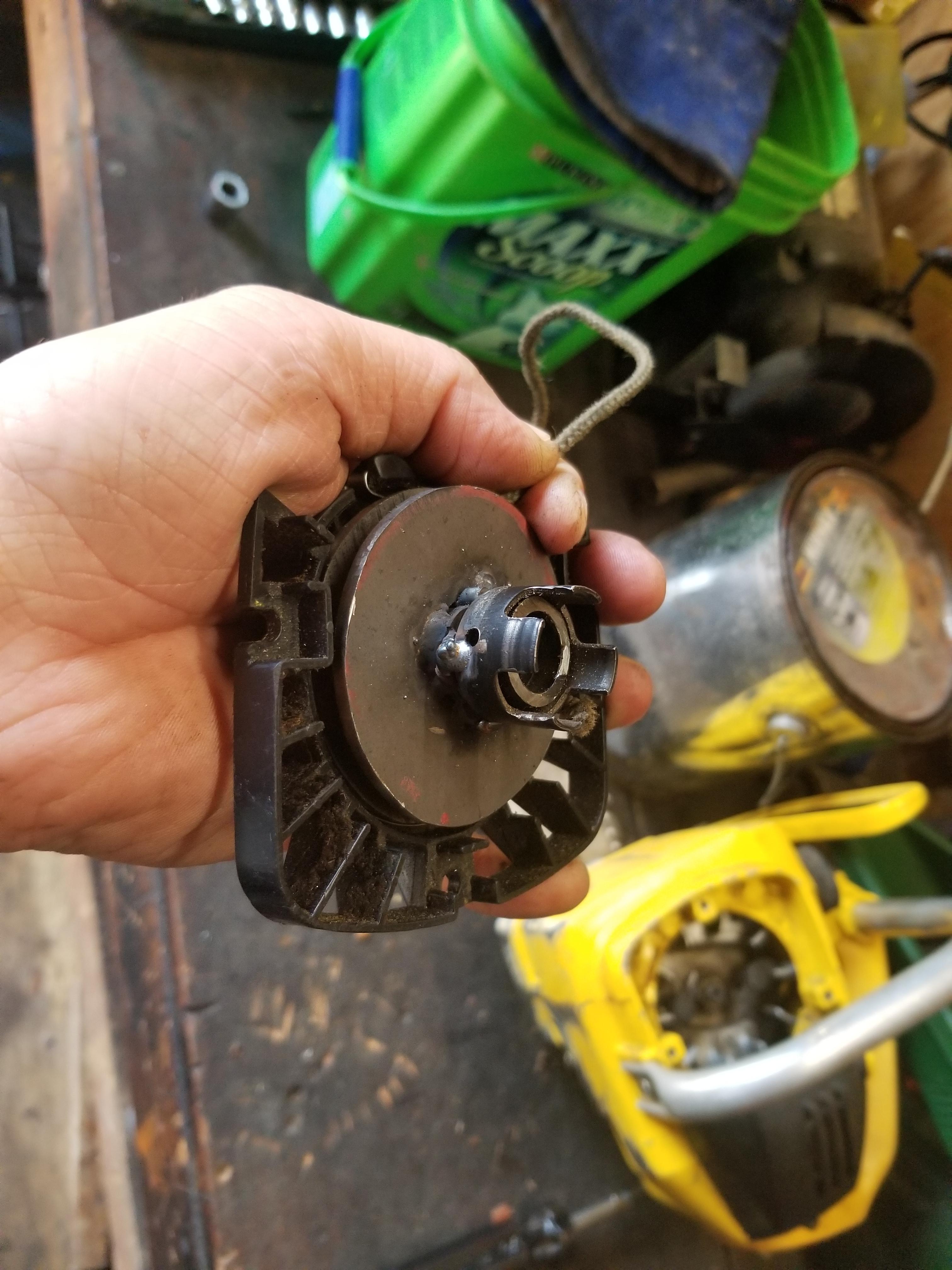

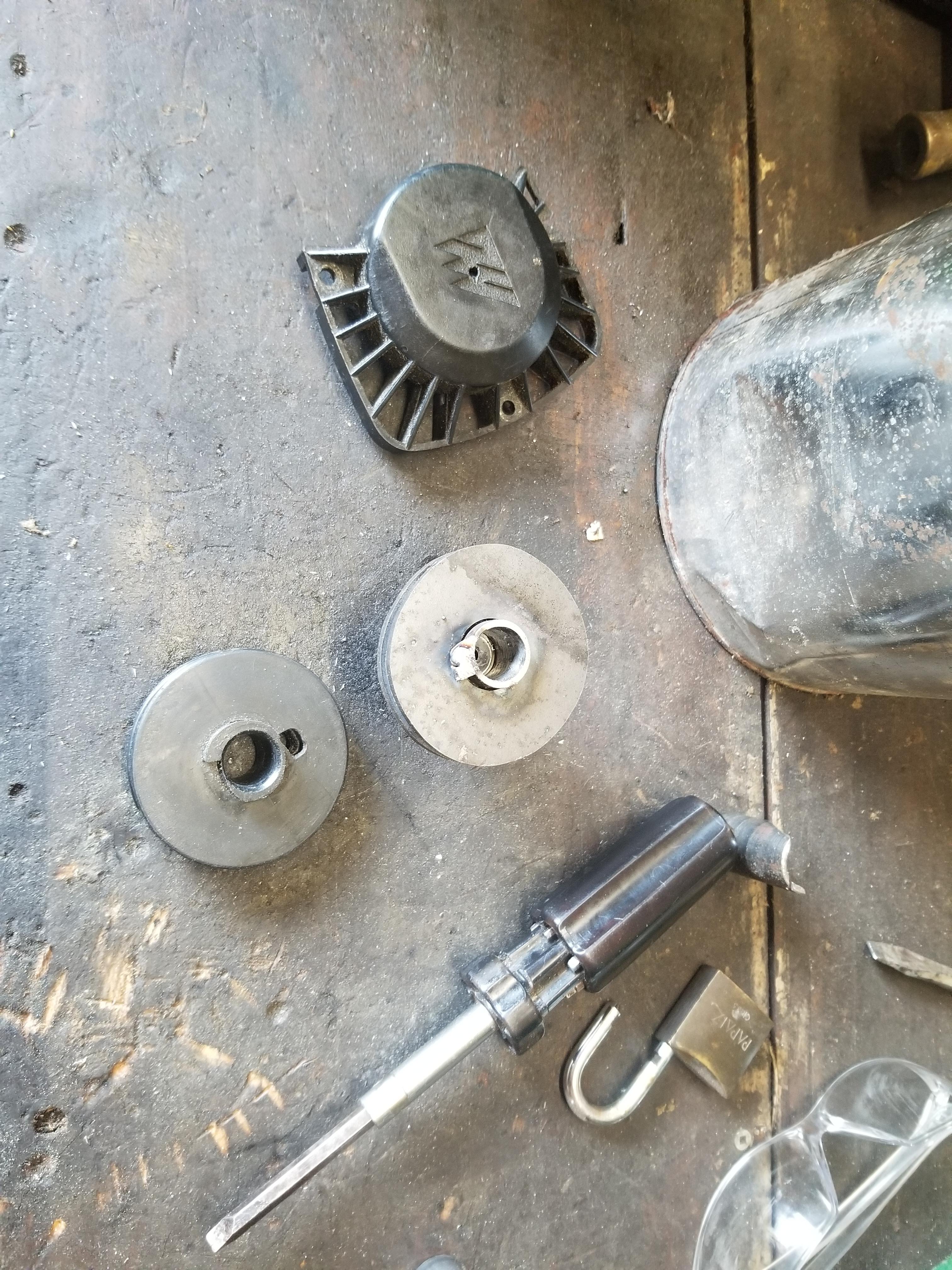

My mini is alive again. Made a homemade starter assy for it this past week.
