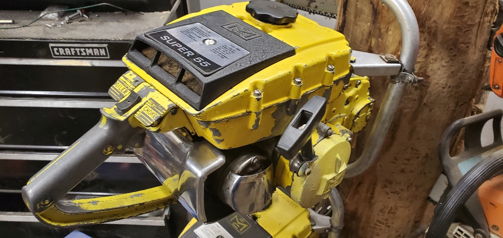

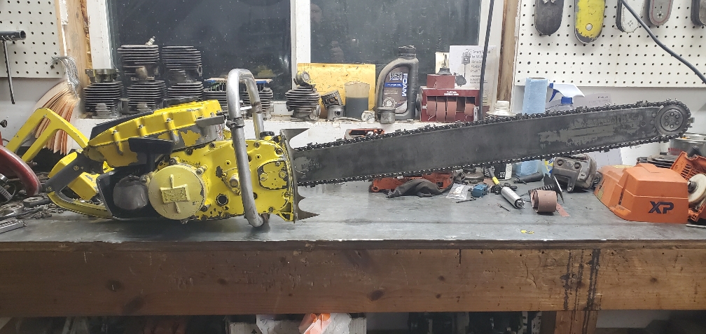

Well folks, I finished the Super 55. I am super thrilled with how it turned out and am really looking forward to taking it to some Doug fir this weekend. I did a full overhaul on it, new skf bearings and seals. New old stock .030 piston and did a little port work on it too. The saw sure has some snort, I love the sound too!
Sent from my SM-N970U using Tapatalk
