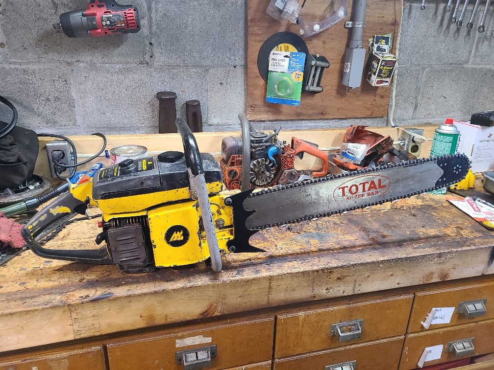

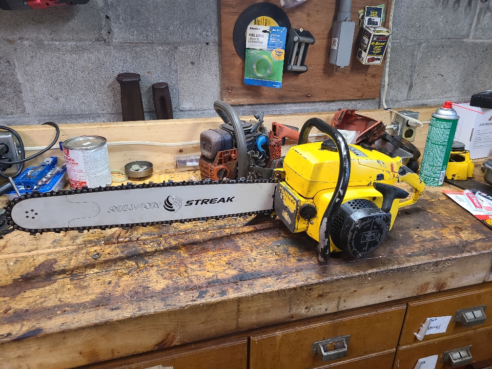

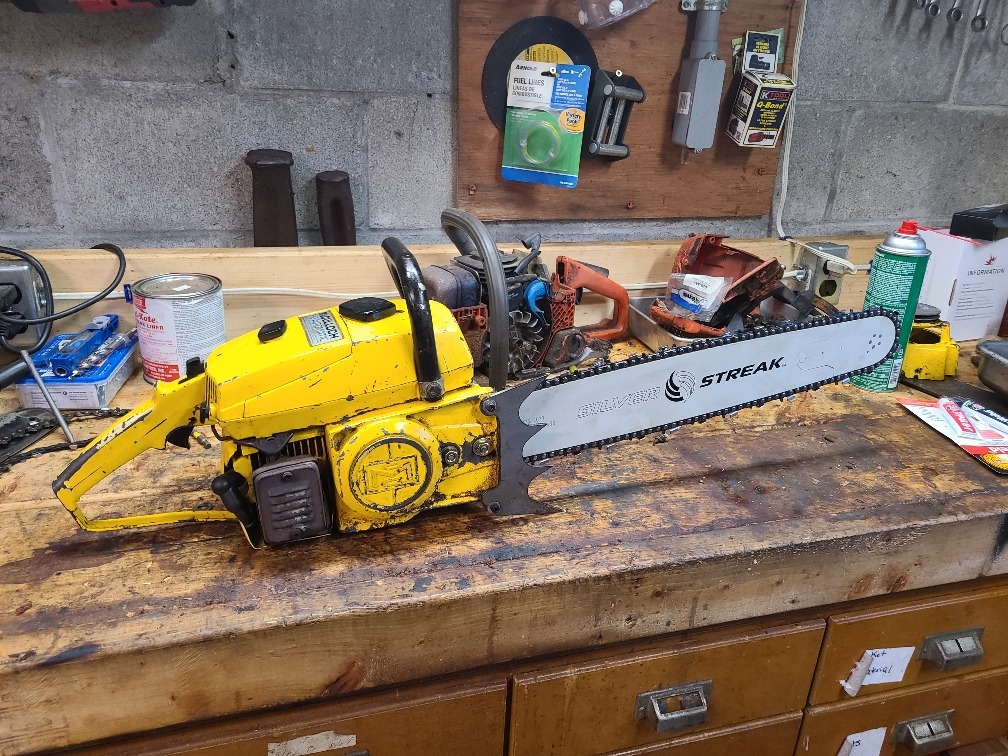

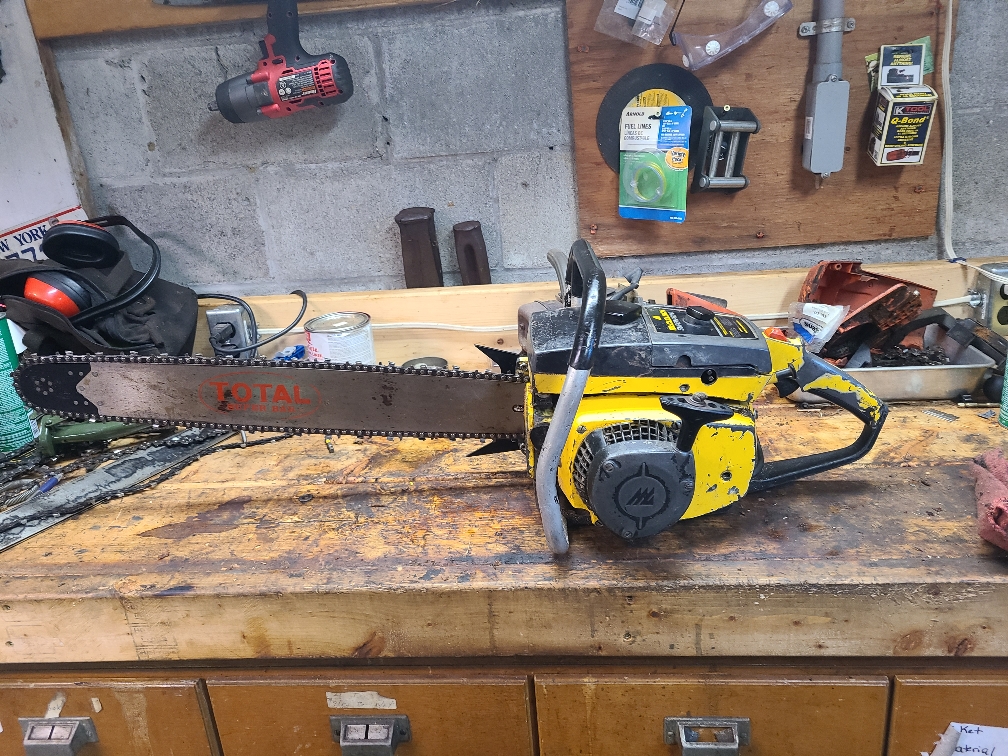

Here's today's projects. Rebuilt the recoil and the carb on my 7-10. The fuel filter was MIA and the carb screen was full of debris from the tank, it was also totally missing the metering side gasket. Amazing that it ran as well as it did.
I took the 24" bar off the 7-10 and swapped it with the 20" I had stuck on Scrap Heap. I also noticed that these silver streak bars are not properly drilled for oiling on these Macs in spite of being listed as fitting so I remedied that as well. I also added some dogs to Scrap Heap

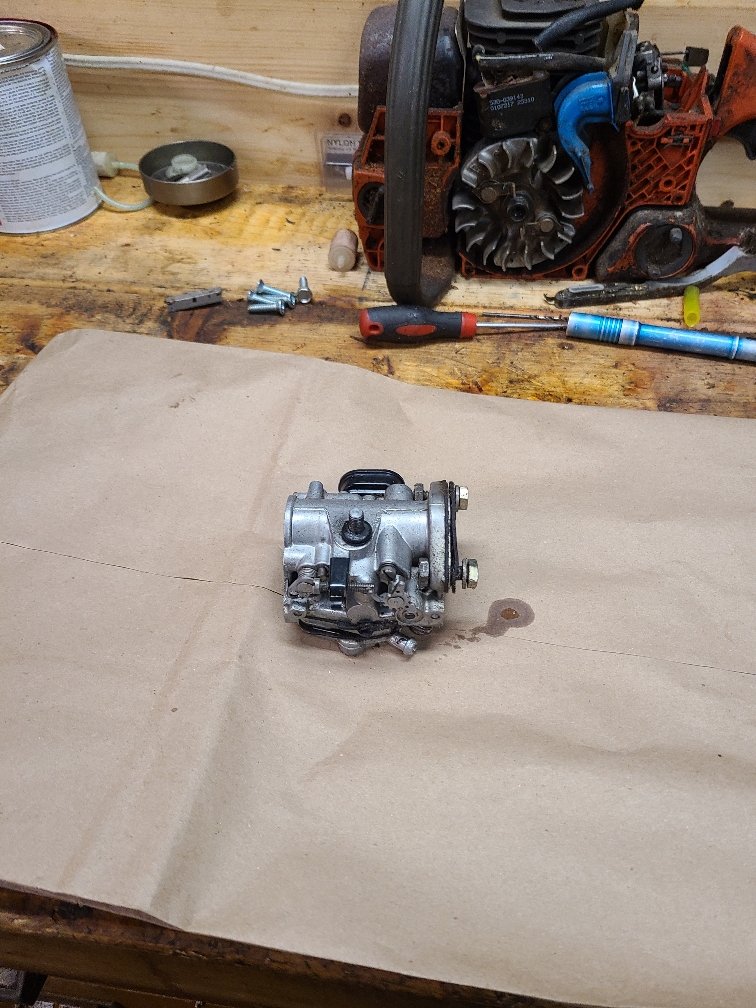

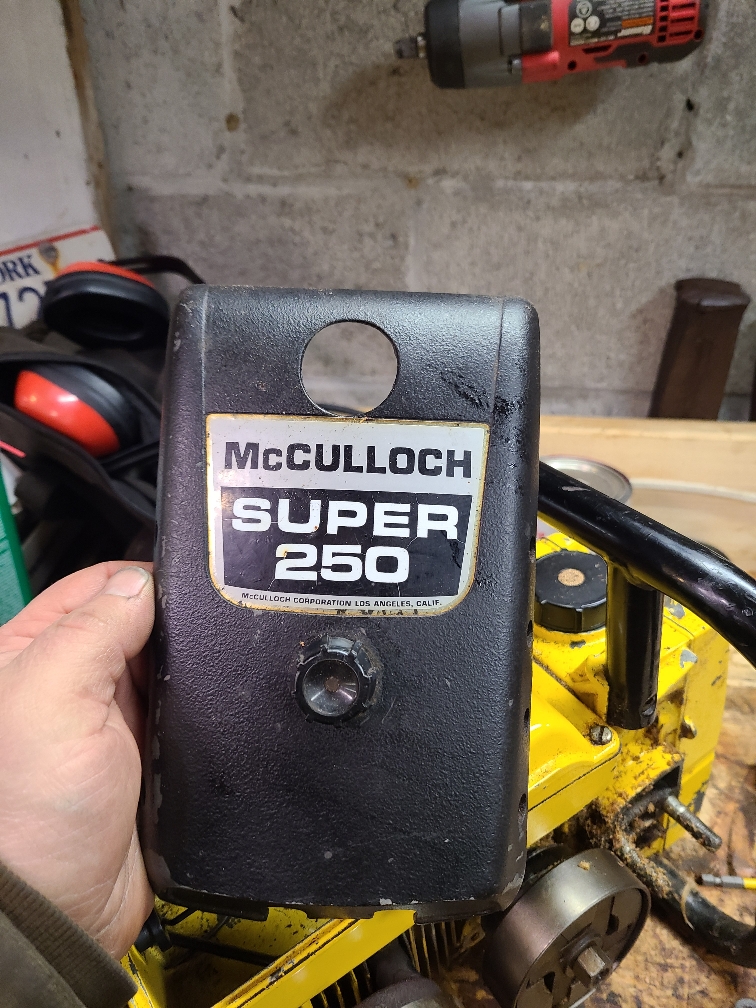

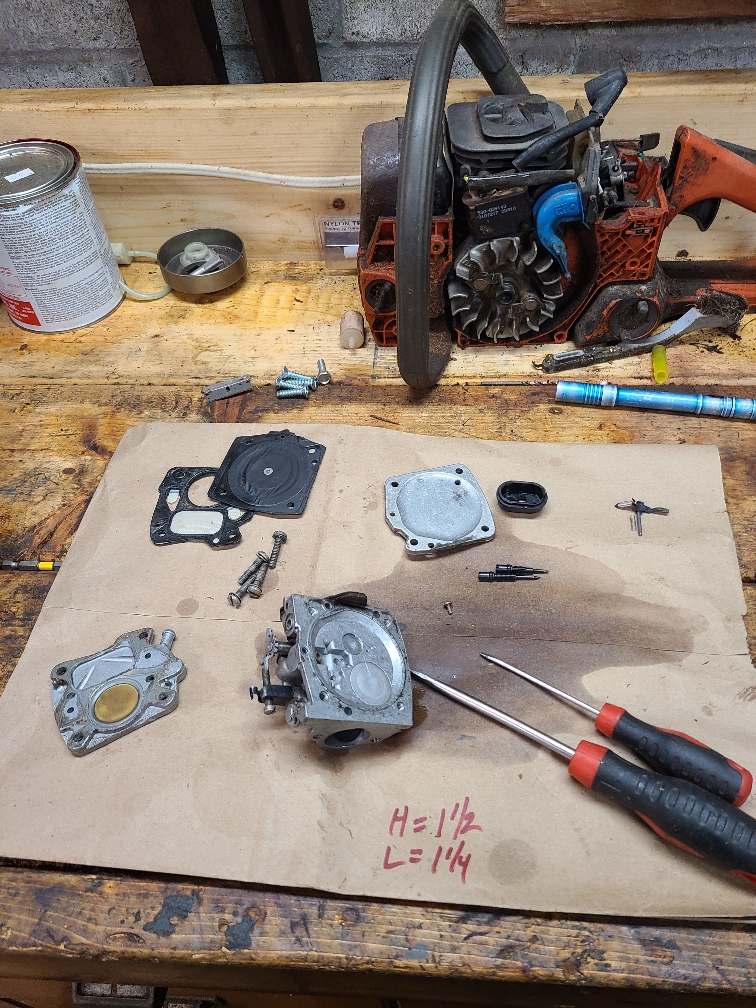

Tonight's project...... really debating whether I want to spend $30 on diaphragms for this flatback or just convert to a Tillotson. I have plenty of parts saws here but I have been told that the flatback gave a performance edge over the Tillotson and being that this is a Super 250 I don't really want to stifle it's power.
Sent from my SM-G981U using Tapatalk
Scrap heap, meet Trashpile.
Found it lying out in the rain in a pile of long dead plastic saws. Fixed Fuel line end at carb. Started in 3 pulls. Chain was rusted into bar.
Its amazing what these things can survive. Only thing that kills them is needle bearings coming apart, straight gassing for a tank or 3, and possibly being run over by a bulldozer.
HL that bish and don't look back...
heimannm
3:40 AM
714
Jan 28, 2016
4,210
30,434
Dike, Iowa
The flat back with the choke is a more reliable carburetor than the primer types. My recommendation is keep the flat back and take advantage of the performance edge.
Now you have to decide which one of us to believe...

Remember that if you decide to use and HL, you will need to add the spacer between the carburetor and the mounting flange to keep the adjustments screws in the "window".
Mark
Who are you and what do you know about McCullochs?

I have one of those miserable pot lickers on I think a 250 super .I got it running good once .Weather it ran as good as most 87 cc Macs is debatable .I'll just stop there but it's not my favorite carb .I'll take an HL any day .

I ordered the diaphragms from sugar creek...... if its like the last time I ordered it will be a few weeks so I will throw a Tilly in there for now.
