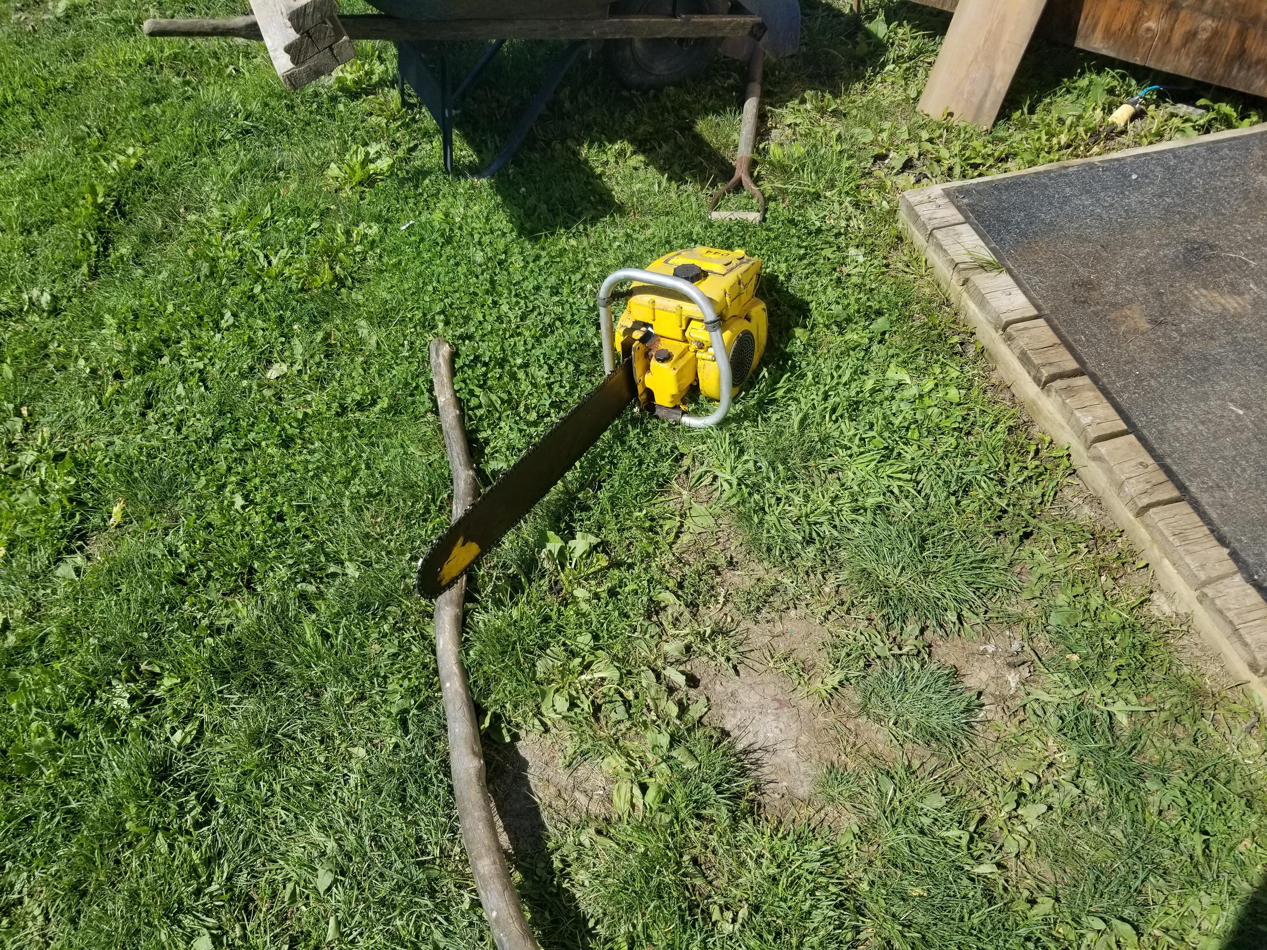

I have 4 old Macs total now. A 1-40,1-41,1-61 and a Mac 15. All nice shape and I’m sure the all of them will run minus the 1-61 is locked up from rust so it’s soaking. If it won’t free up then it will make a good parts saw to sell I guess. Not that any of these saws are all that desirable.

It may take time, but it will. Can add a part acetone to it also. Makes it really wick in it seems.

If that old Mac is stuck with the piston above the exhaust port you could always shake it loose with a grease gun .That trick is as old as dirt .

Just started to soak it first with penetrating oil then started to spray the 50/50 atf and kerosene mix in spark plug hole out of a spray bottle. Probably not the end of the world if it never runs again because I’m sure it’s slow as heck and I won’t run much of any

It won't be slow like a snail but it should have a lot of grunt . Probably help the speed with a good sharp chisel
chain instead of likely that old chipper chain .If it is an 1-70 that's 87 cc and IMO the best of the reed valve engines .I have several of the 5.3 cubic inch saws .I've only had the tach on one and it was around 9.000 RPMS which isn't all that slow if you think about it .It's worth saving if you can .
