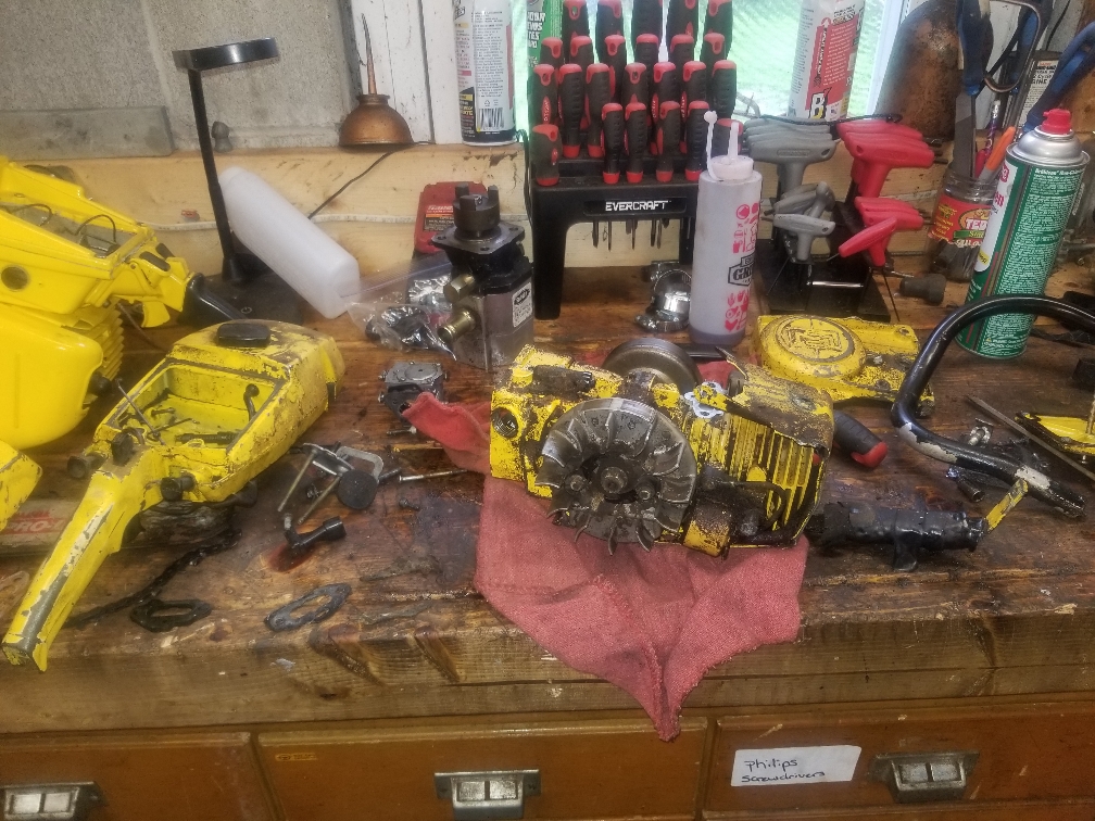

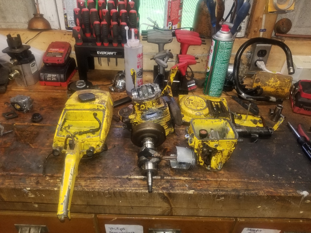

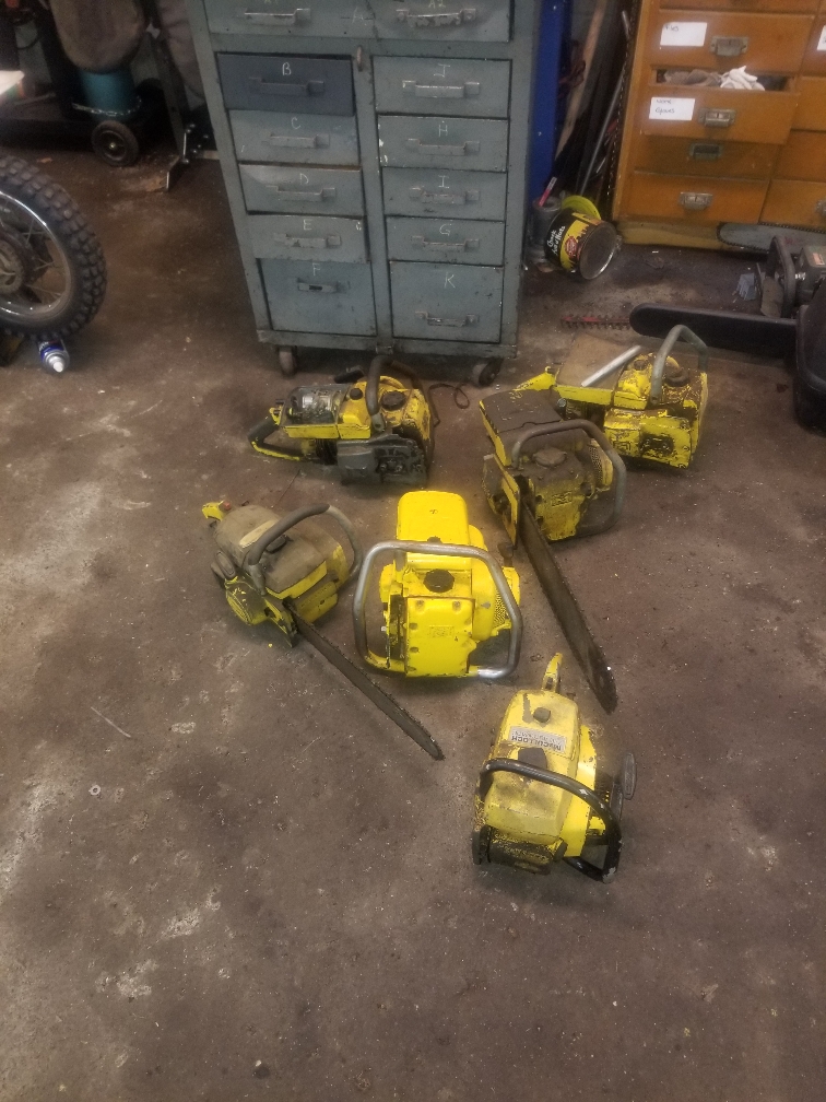

Hi guys, it's been a little while.you guys probably thought I fell off the face of the earth. I just wanted to come on and share today's Mac score.
Got a 7-10, 3-10E, 1-40, 1-51, 1-52, and a 250.
The 3-10 fires on prime, 7-10 ran but had air leaks. I havent messed with any of the big saws but all pull over with compression.

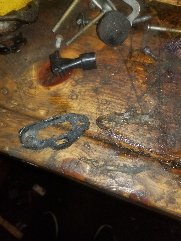

Already tore down the 7-10. Everything looks good, all the intake screws backed off and blew the gaskets out. Will install new crank seals and replace gaskets as needed and should have a runner.
I do need the lower handle brace and recoil screws if someone can help.
I am also going to be looking for some parts for the 3-10E namely a battery box. I would like to add a working electric start saw to the collection. I think I'm going to try to get the bullfrog working, or should I just scrap it and do an SDC like I did last time?
