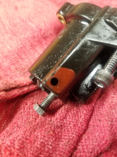

simsponsawshop
11:42 AM
10914
Nov 8, 2019
62
201
Townsend
Ok, oiler problems in the SP81.... here is what I found. On the manual oiler, we have an improper mix of parts. It has the thick flange oil pickup line used in conjunction with a thin gasket effectively trapping the check disc. I have options here, I have another manual pump with a thick gasket and I have a pickup line with the thin flange so one way or another I will get that sorted.
On the auto oiler, it had the plastic pump in it and it is missing the plug in the bottom of the outlet channel. Can I just epoxy that hole shut? I also have an aluminum body pump but it is missing the spring and check ball unfortunately. Does anyone have a good used pump they would part with?
Thanks guys.
