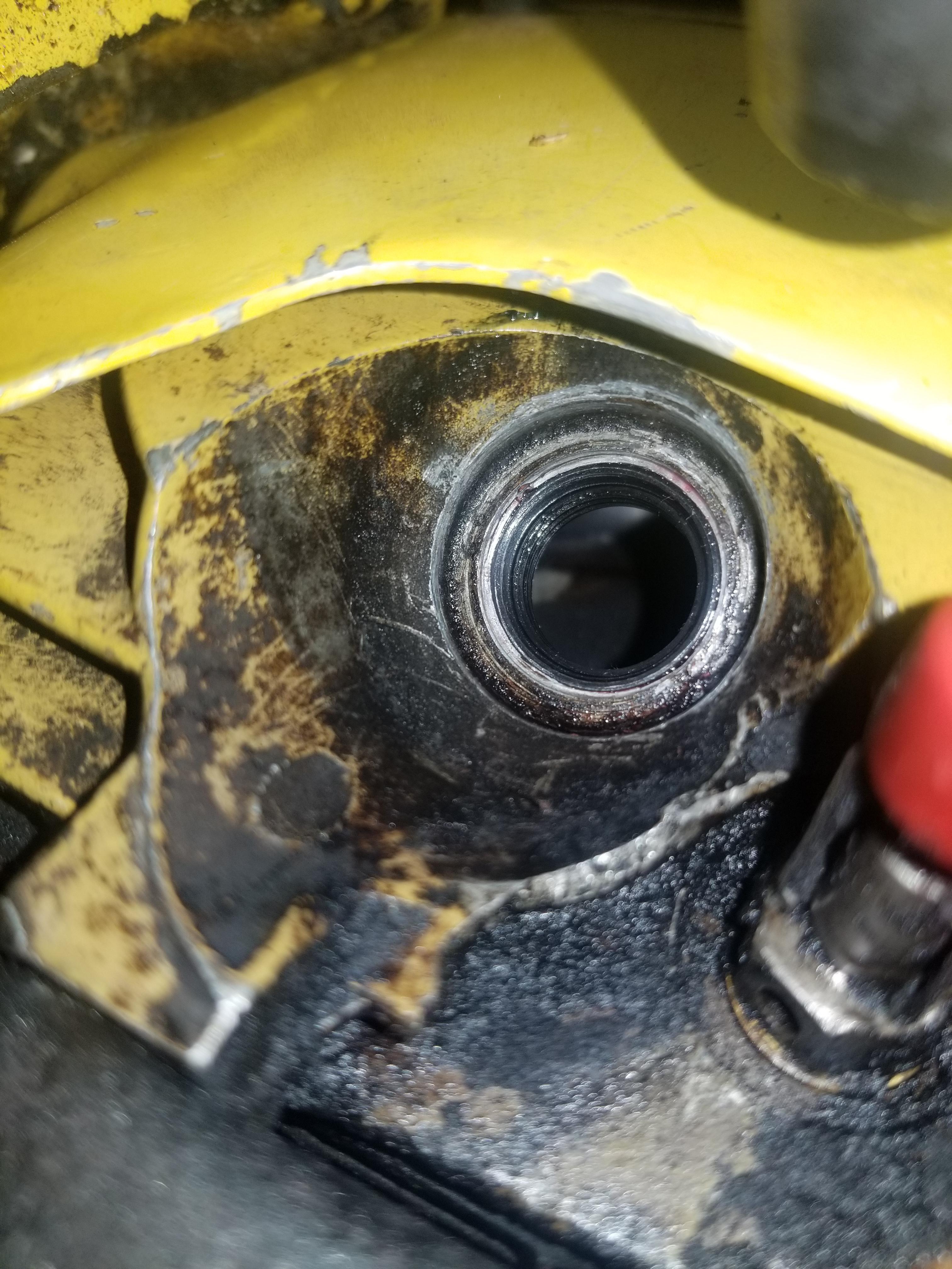

Sorry guys, I should have taken a picture. I had already put the crank in a Ziploc bag with some oil because I cleaned and polished it. Didnt want it to rust. The pits I'm referring to are actually on the crankshaft itself. On the flywheel side bearing journal.

Where I'm pointing to. Thats where the pit is. This is another crank I just pulled from a saw that had more water in it than the last one. The crank and crank nearings were spared. Piston looks mint once I cleaned it off. Broke a ring trying to get it off. Rushed it. Knew better. Trying to see if this crank will interchange with the other one. If so, may be in business.
As long as they are not deep it should be fine, but if it’s were the seal rides I wouldn’t run it
