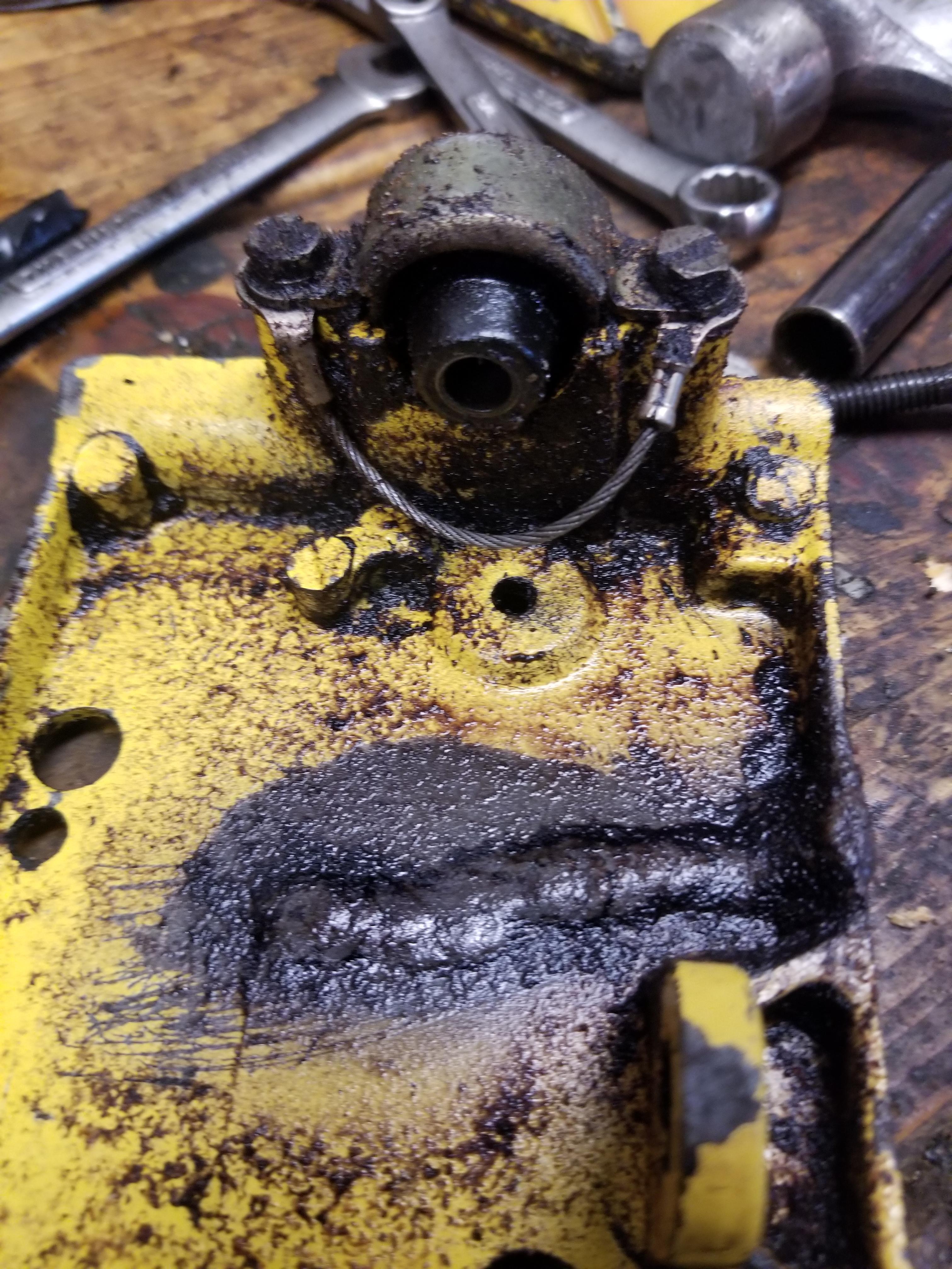

I pulled the SP81 down to the short block today. Intake boot was improperly installed, the spring was mounted between the boot and the air box instead of between the boot and the engine plate. Also think this might be why the kill switch was intermittent (see photo)
What should I be looking for for an inop manual oiler? Never had that before, also, I dont think the auto oiler is doing as much as it should.

Both the manual and automatic oiler rely on the disc check valve under the manual pump, and the ball check valve in the automatic oil pump. Make sure the ball check valve in the automatic pump is working.
