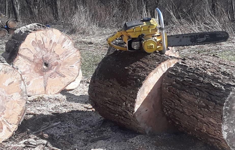

Practicing social distancing yesterday... Made up a new loop of chain for the 1-70 and took care of some maple butt logs. Its been a couple of years, but ran flawlessly. Not bad for 60 years old!
Sent from my SAMSUNG-SM-J727A using Tapatalk

That is a handsome old saw John.
